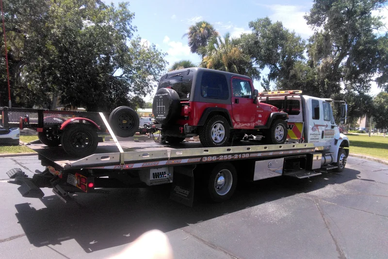

Yep, happened to me. Zero power, virtually no vacuum on my vacuum gauge. No codes. Got hot. Called in a flatbed. 3rd cat was clogged.

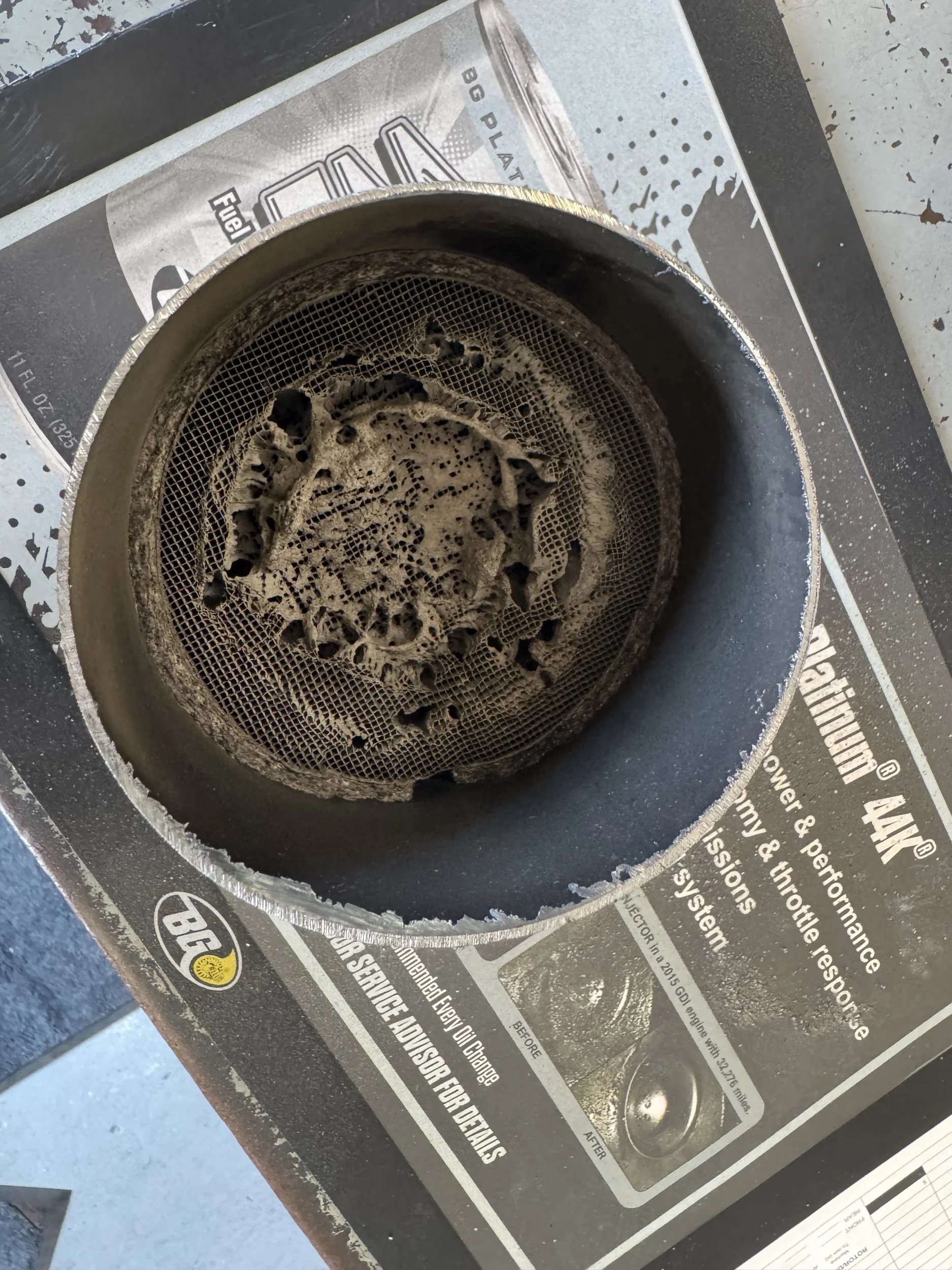

I was driving my 90 Wagoneer back from Uwharrie National Forest many years ago and kept getting a stutter or hesitation in power on the way home. Doing 80 on the interstate and then it felt like the engine shut off for a second or two. Very hot day. Pulled over and checked plugs and wires, kept driving. Happened again and pulled over and replaced distributor, plugs, and wires. Kept driving. Happened again. Threw parts at it all the way home. Ended up not driving it for several months until I had to pass emissions to register it. It failed. Report pointed at catalytic converter. The muffler shop showed me the hollow interior. That's when I realized that the honeycomb was breaking up and clogging the exhaust. They thought I had hollowed it out.

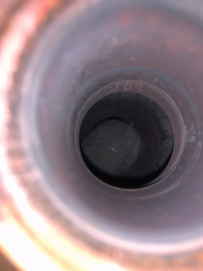

I plugged the Bank 2 mini cat on my 05. Driving home from work and started to get on the throttle to merge and lost all power, CEL started flashing. I pulled over and gave it some rev's and the idle stabled. At time I do believe that I had CAT efficiency codes for a few days prior to this . Few days later I replaced the entire Cat system. The B2 cat was nearly gone, B1 was fine.
Here's a follow-up to the original post. Took the Jeep to a recommended muffler shop last week and sure enough, the downstream cat was completely plugged up with bits and pieces of the Bank 2 pre-cat. Was not a cheap fix since Colorado has now adopted the screwy california rules of "approved" cat cons only but after putting on the new ones the Jeep runs great and the engine revs out and breathes as it should.
