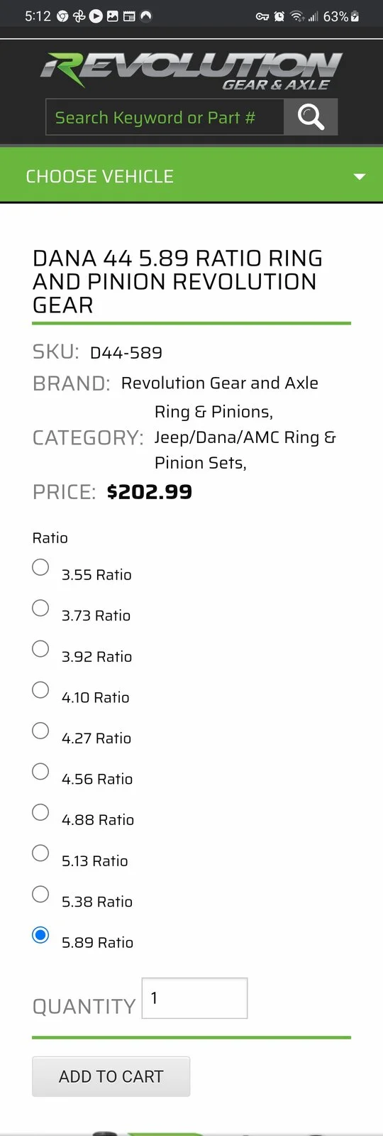

Just learned that there are 5.89 gears available for the TJ Rubicon axles.
Has anyone run them with the 42RLE trans and 35s? Were highway RPMs and driveshafts speeds an issue?
No lockers at the moment. I would be running ARB lockers most likely.

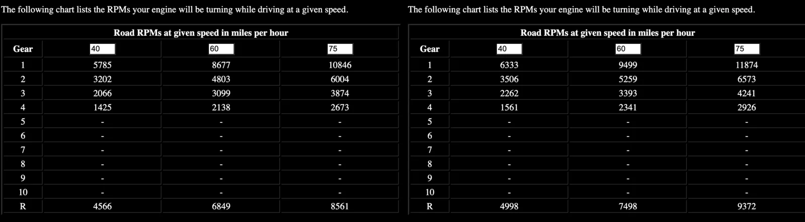

5.38 (left) and 5.89 (right).
2900 rpm at 75 sounds pretty good to me.
