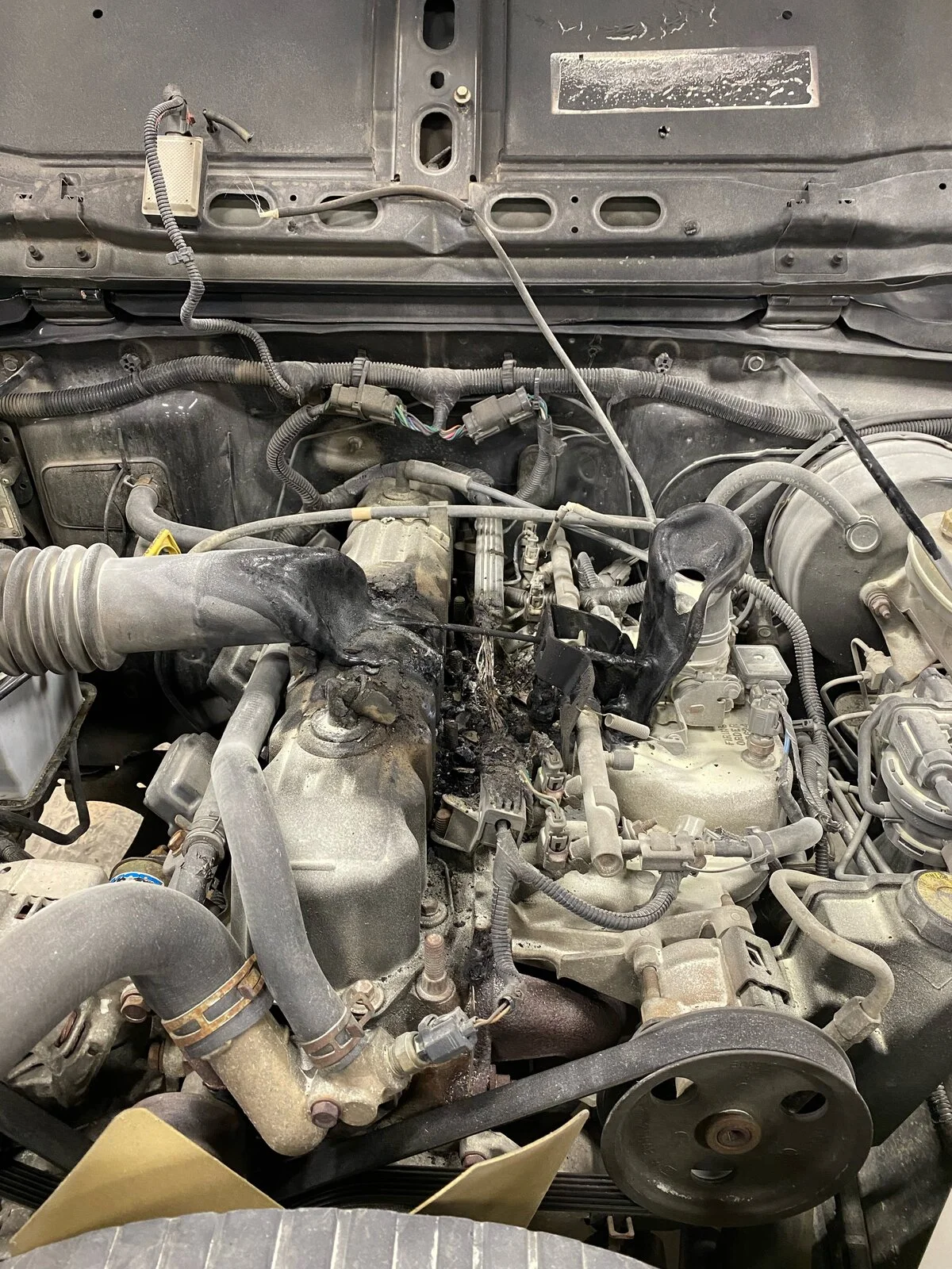

Replace it! It’s also to keep debris off the exhaust manifold. My Jeep caught fire after a squirrel built a nest in there after my Jeep sat for a few days. You can install it without removing the injectors. Trust me you don’t wanna deal with the hassle of finding the parts to fix a fire.

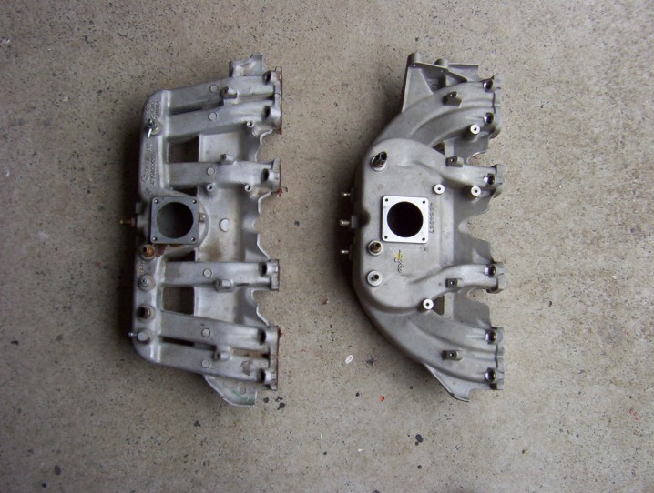

I think I found out the answer to my own question.
The heat soak issues may be caused by the later 1999+ "horseshoe" intake manifold that replaced the earlier "log" style. The earlier style allowed much more heat to escape compared to the later style:
