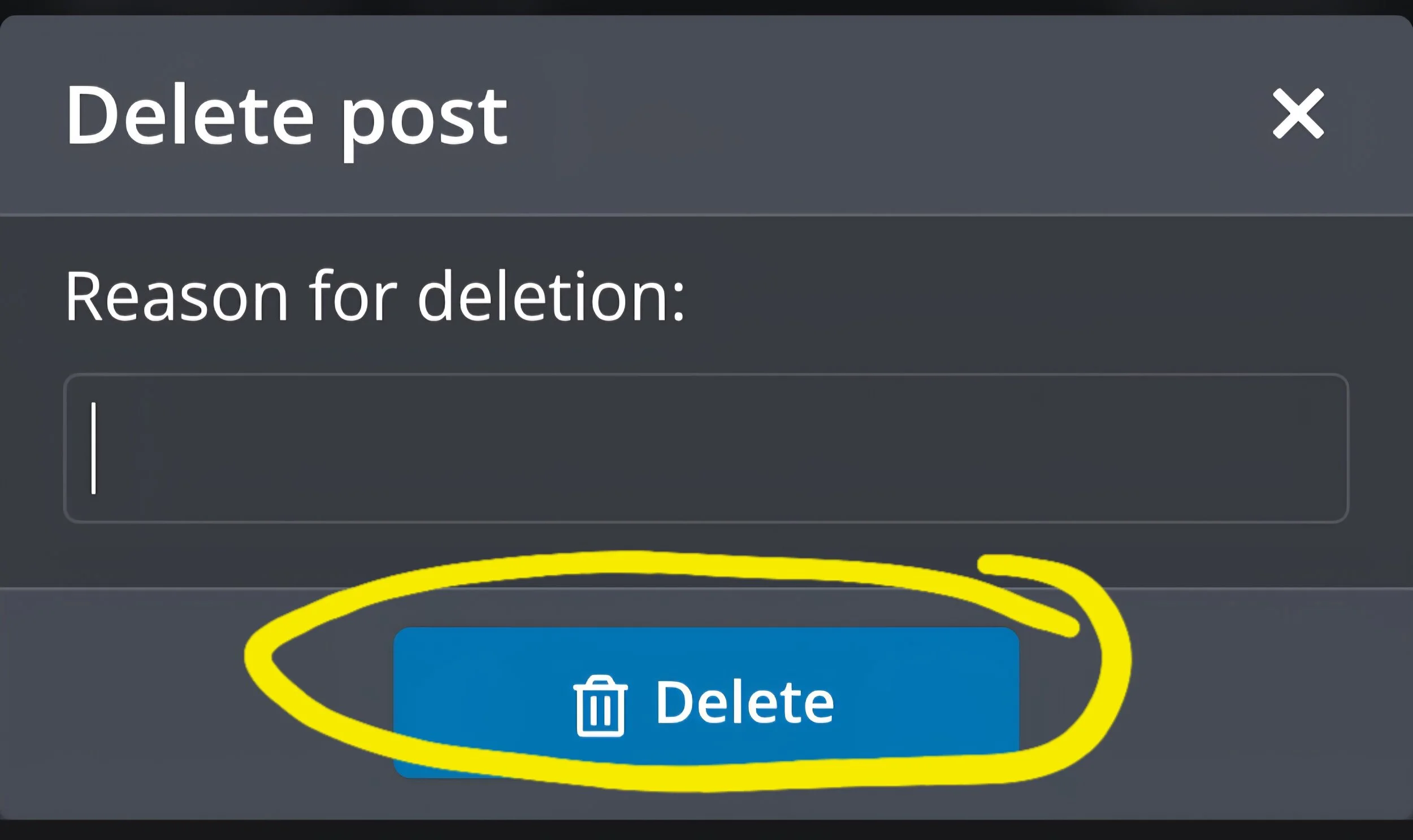

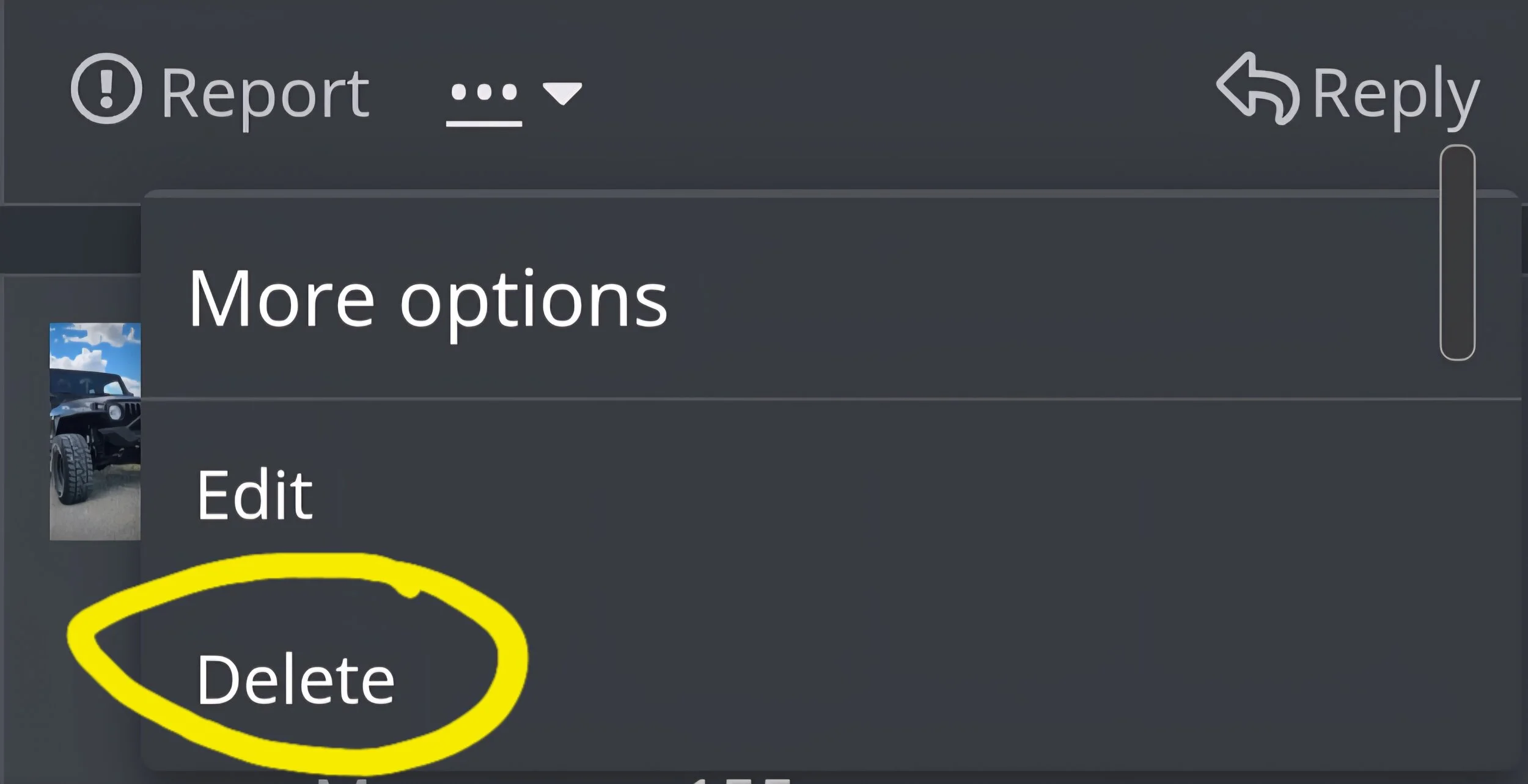

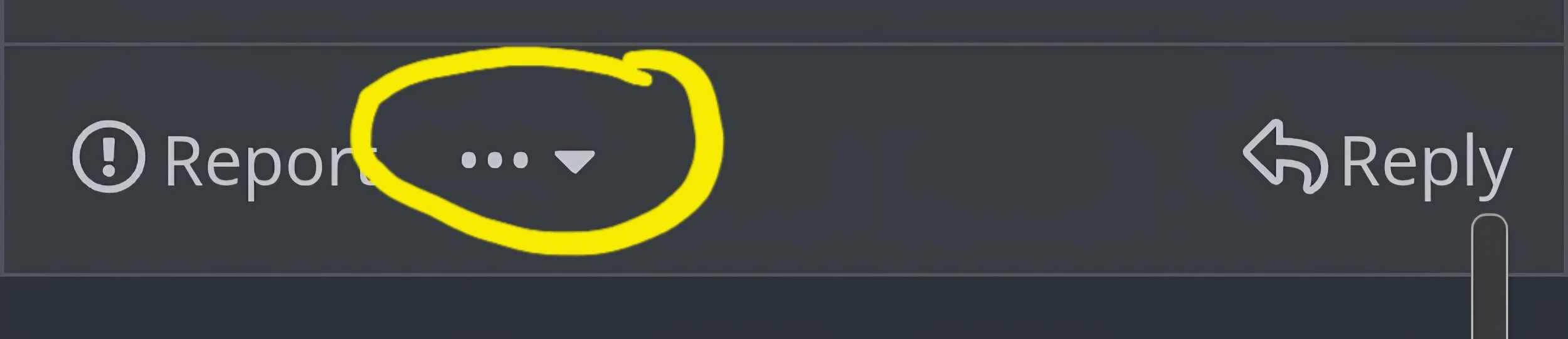

Is there a way to delete my extra comments. It didn’t look like my comment got posted. Then I looked a little later and seen it Lol

My browser just says !⃝Report, without the …▼ like on yours.
Maybe I can switch to another browser and get that drop down and delete option.
you can always ask the owner @Chris to delete the duplicates
Might need to be a supporting member to delete. Or have 20 posts.
