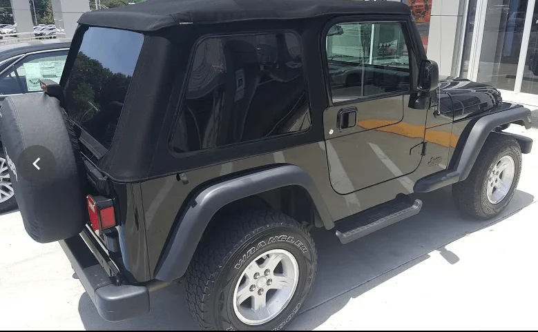

Hello everyone, figured I would go ahead and make an account since I'm sure I'm going to have lots of questions! Just got my "brand new to me" 2006 Sport. Pretty sure I'm in love. Here is a pic, and build sheet.

Looks like a super clean TJ, I'm impressed. Good buy for sure.
You definitely don't have a Dana 44 in the front (unless someone swapped it on there after the vehicle was purchased), but you very well may have one on the rear.
The Dana 44 in the rear was an option on the TJ, and it was primarily for the purpose of towing. However, being that the Dana 44 axle is much beefier than the Dana 35 (what most TJs came with in the rear), it makes an excellent axle for off-roading and running bigger tires. Be glad you have a Dana 44 in the rear, because they go for quite a bit of money when they pop up for sale.

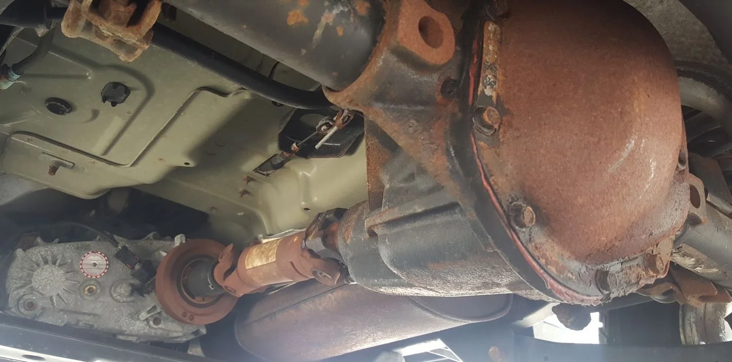

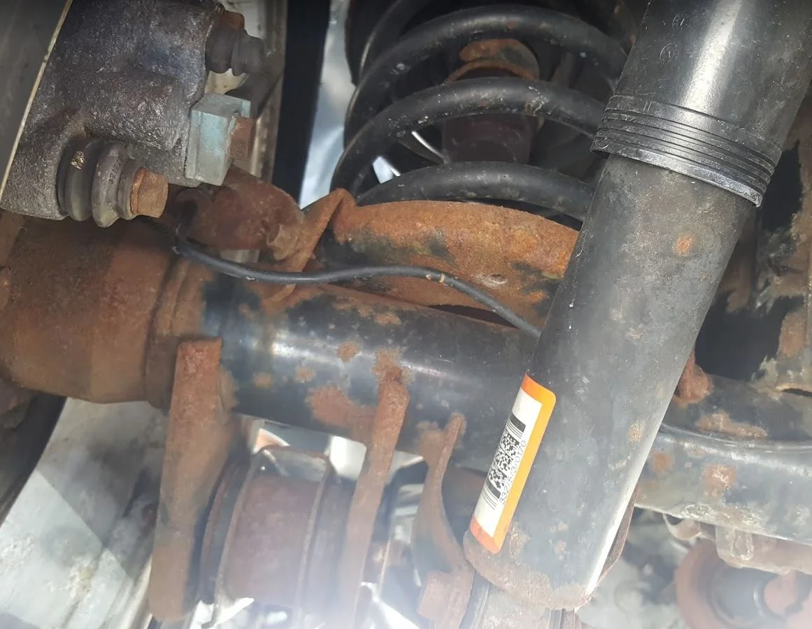

Perhaps than it is lifted? I'll have to start some research to figure that out. For now I will leave pics of the rear diff., and a quick snapshot of suspension.
Not lifted. 12" springs on front, 8" on rear. Suppose I'll take to the mechanic for a good looking-over. Carfax showed one owner, no accidents, and frame looks OK to me, but who knows. The tire sticking out a bit has me perplexed.
Probably just something out of whack. Either something needs to be adjusted or a component replaced. Either way, shouldn't cost much if anything at all.
