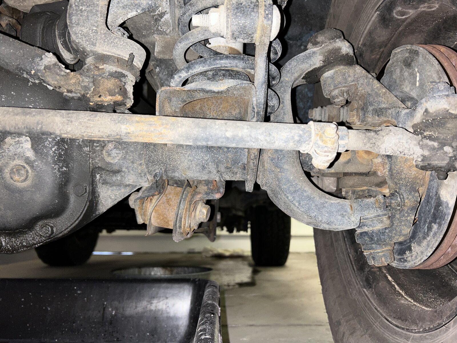

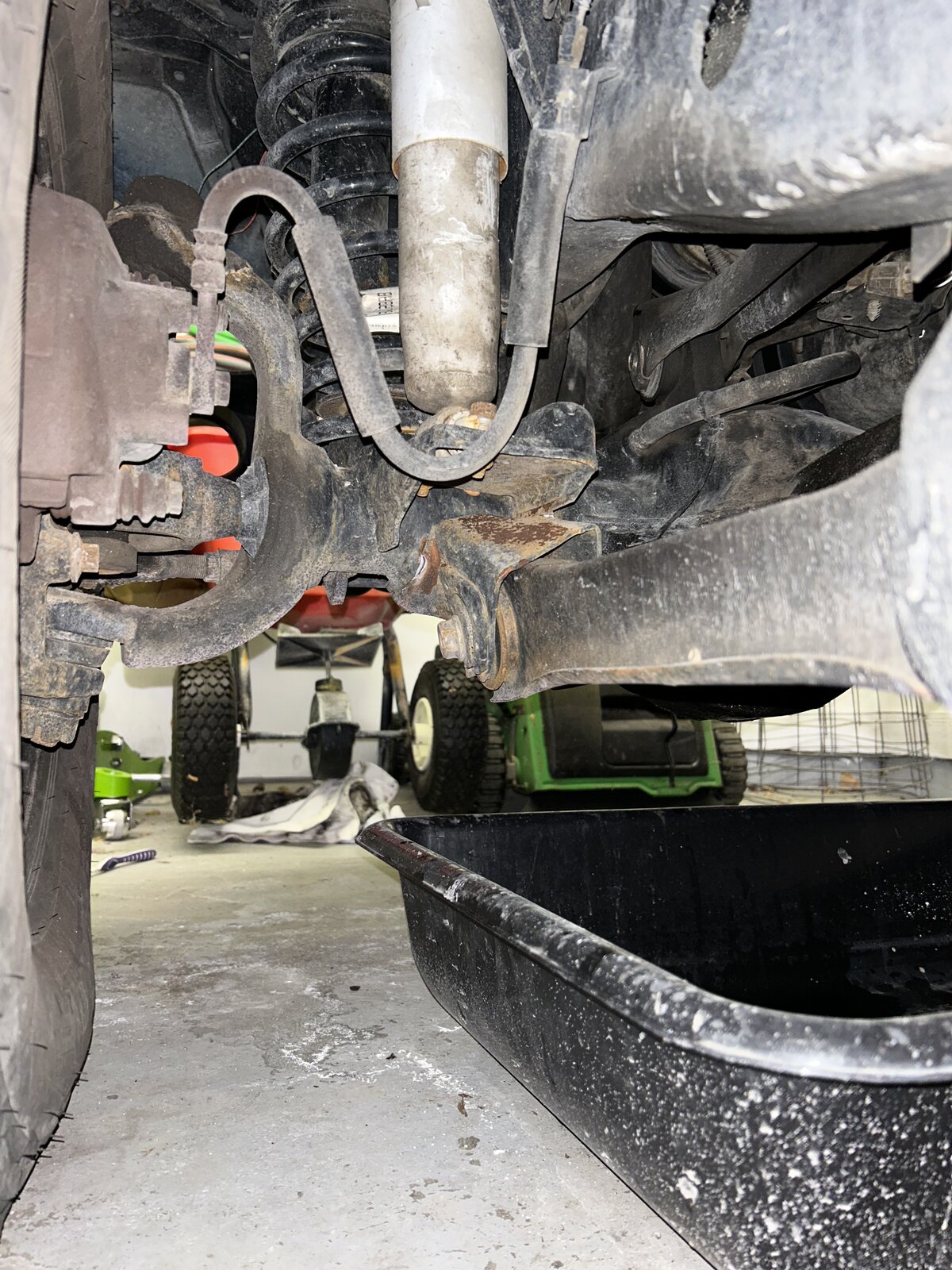

Help assessing steering damage after icy road impact
the rim on that tire got busted up and bent some so the tire is somewhat deflated. Possible could make it seem tilted?

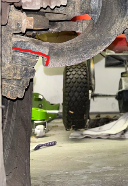

Could but that doesn't explain the open angle we see. Could be the pic angle, you need to find out since that is the difference between a new housing or not.
To clarify some. If he is going to check the rotors, the axle tube needs to be set to 0 degrees. In this case, it doesn't matter since that axle is beyond repair given how cheap a replacement should be. Also as pointed out, the trackbar frame side mount is bent or someone will have to prove it isn't somehow.
The lower part of the left side inner C is bent. All that will do moving forward is take out the upper in a hurry. The lower can handle some angular misalignment, the upper can not.
He needs new front control arms, straight frame side trackbar mount if using the stock trackbar or get an adjustable front trackbar, new front axle, and new steering links complete. Damage to steering gear TBT but I'd certainly spend some time making sure it and the steering shafts are not tweaked.
How do you know it has an aluminum block? Best I can tell seeing the O2 sensor tab, it says 4.0 to me but I can't fully verify from the pics.
Thank You for providing a realistic assessment of this situation , I agree with replacing the axle assy. it totally makes financial sense.

The axle has to come out to get repaired even if it isn't replaced. Once the axle is out, 300 bucks should put another one in its place if it has 3.73's in it. That is a very common front axle and should be easy to find. Anyone headed his way from SoCal can snag one of several I have in that ratio and get it to him if needed.
