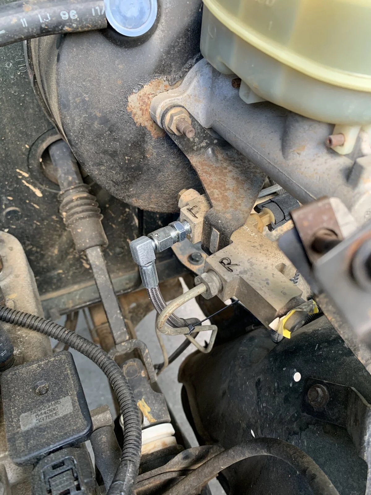

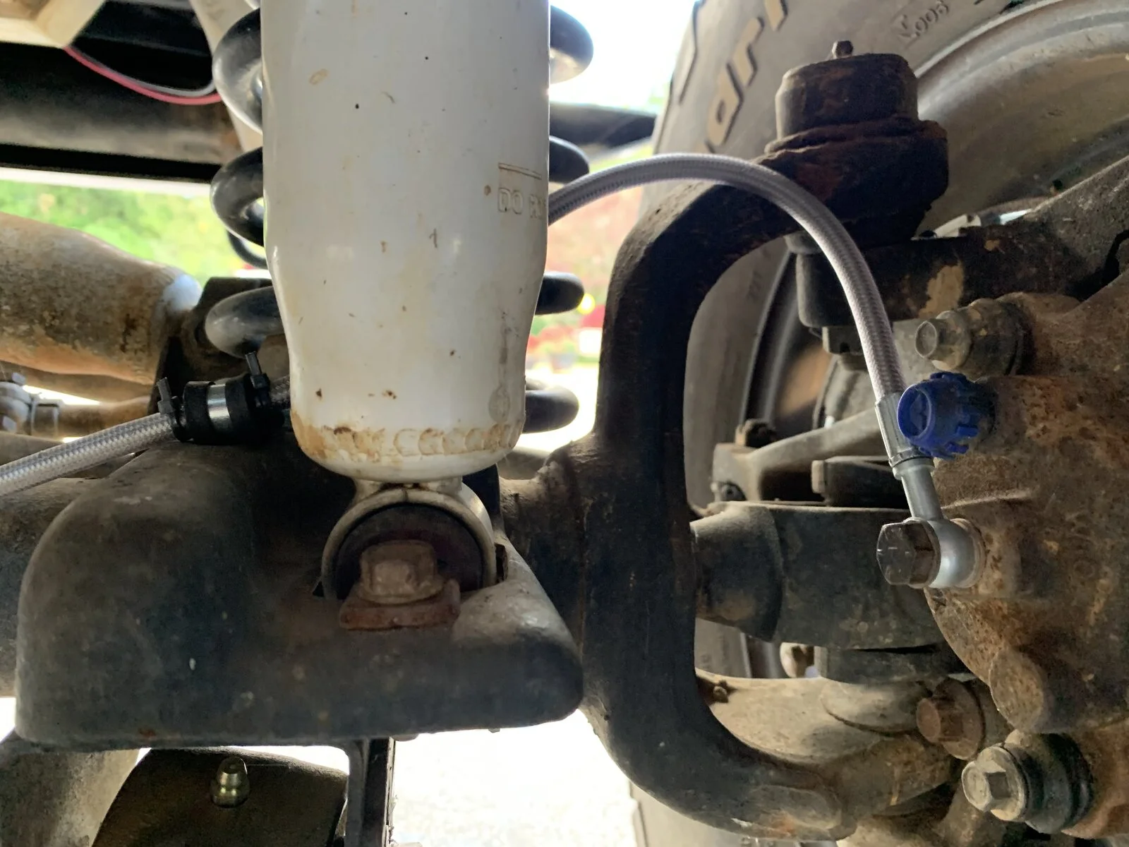

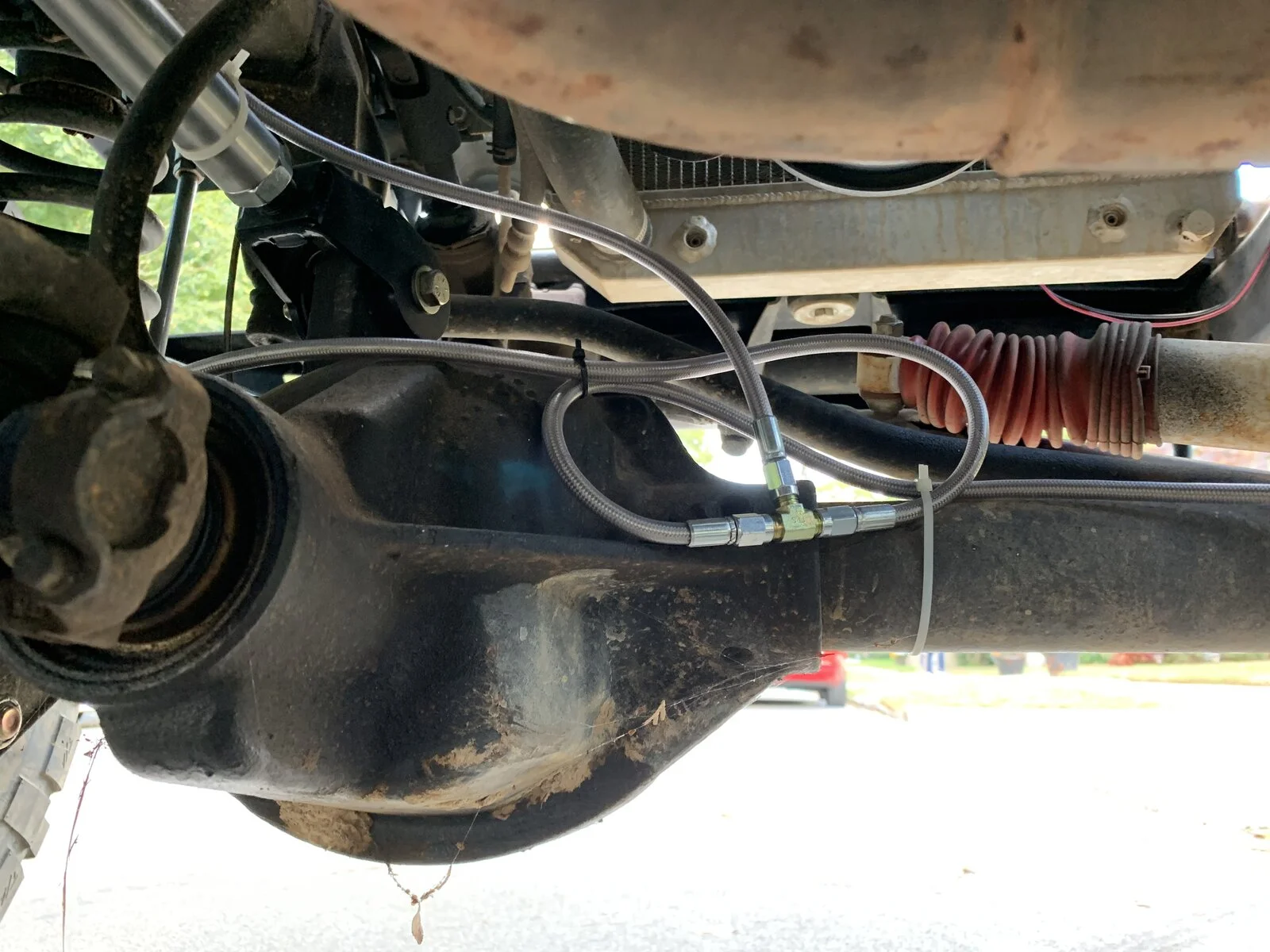

The connection to the distribution block is a 3/8”-24 to -3AN adapter on the port with the F (front) and stock for the rear. I blocked the back port with a 3/8”-24 plug. This goes to a 3/16” stainless braided Fragola line that runs down the rear hard line, to the frame, and down the upper control arm to the -3 tee fitting in the second pic.
Off the tee are the left and right 3/16” lines with banjo fittings on the opposite ends. The only “sketchy” part here is that I got my numbers wrong when I measured my lengths and ordered about 6” too long on each line. This led me to cross over the sides keeping in mind a large arc for fluid flow. I don’t know about hydraulic fluid, but in the air moving industry it’s a minimum bend radius of 2D for steady flow which I easily achieved here.

First, forget that air flow bullshit for brake fluid. You are only moving a small volume for each full pedal press and then the pistons retract and push the fluid back to where it was in the line. Secondly, if you were adhering minimum bend radii for flow reasons, you violated the crap out of that with the 90 Degree drilled fitting off of the combination block, the hard 90 drilled Tee, and then the banjo fittings. All of those are high resistance low flow fittings and have no business being in a high flow installation. However, for brakes, they are perfectly acceptable.
