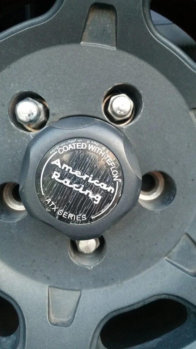

My new to me TJ has American Racing ATX wheels and I didn't get the key. How do change a tire?
The wheels and the nuts may be different brands. Take one of the hex nuts off and see if there is a brand written on it. A picture might help us identify it too.
Ok. Here is a picture
The Lugnuts are recessed and my lug nut wrench does not fit inside the recessed wheel. I thought I needed a key. I have a four-way lug nut wrench and none of the four fit it
Do you have a socket set? They're most likely 3/4". Impact sockets won't fit but most standard chrome sockets will fit.
Just wrap a bit of painters tape around the socket to help prevent Nick's and scratches on the rims.
