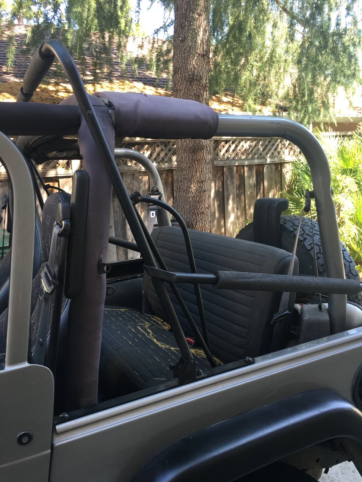

The previous owner left the soft top in pieces for me for me but looks like I am missing a few parts...and probably have this frame going the wrong way. I looked for diagrams online but can't find this specific type. Any thoughts on this? I have no clue where the bent and straight arms from back of Bow attach. Also, not sure where the additional bracket goes, I see the tabs on the roll bar.
Thanks for any help. Mark
That is an aftermarket support mechanism, possibly from a Supertop made by Bestop. See if Bestop will send you a drawing of their Supertop mechanism to see if it matches up.
Thanks for the quick response Jerry, your lead of Supertop helped, just found the manual for the Supertop by BT - all parts are there. Mark

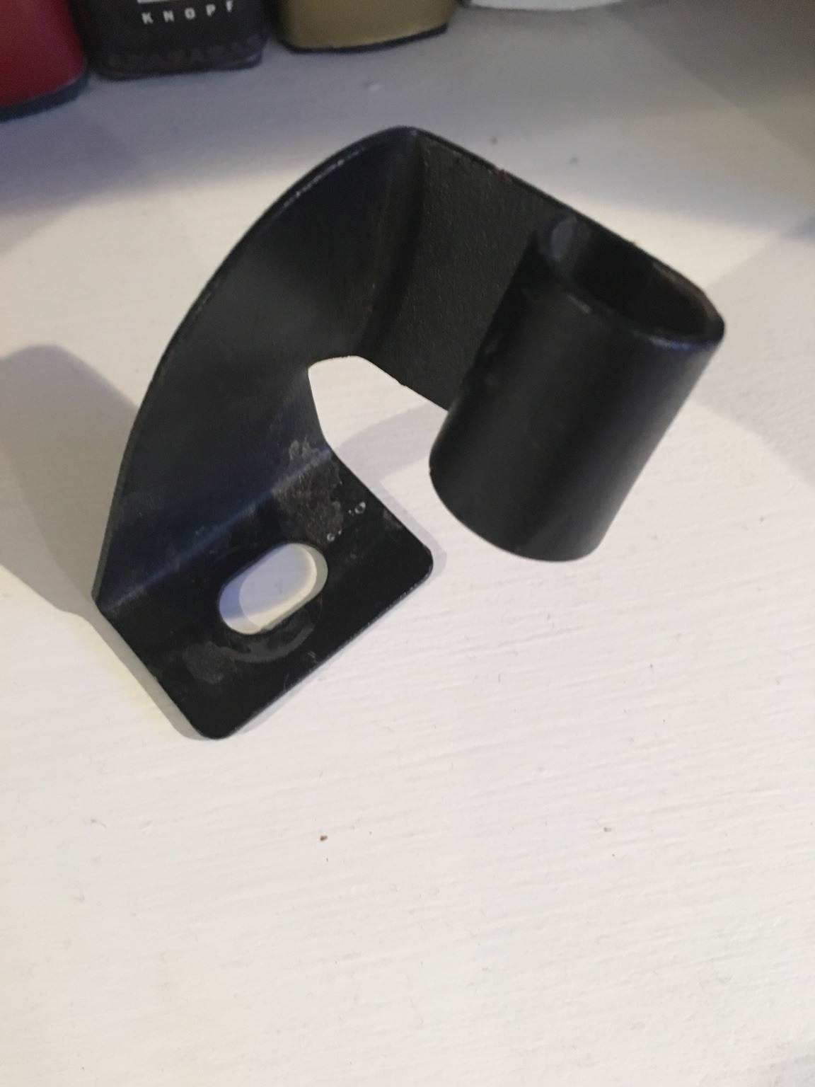

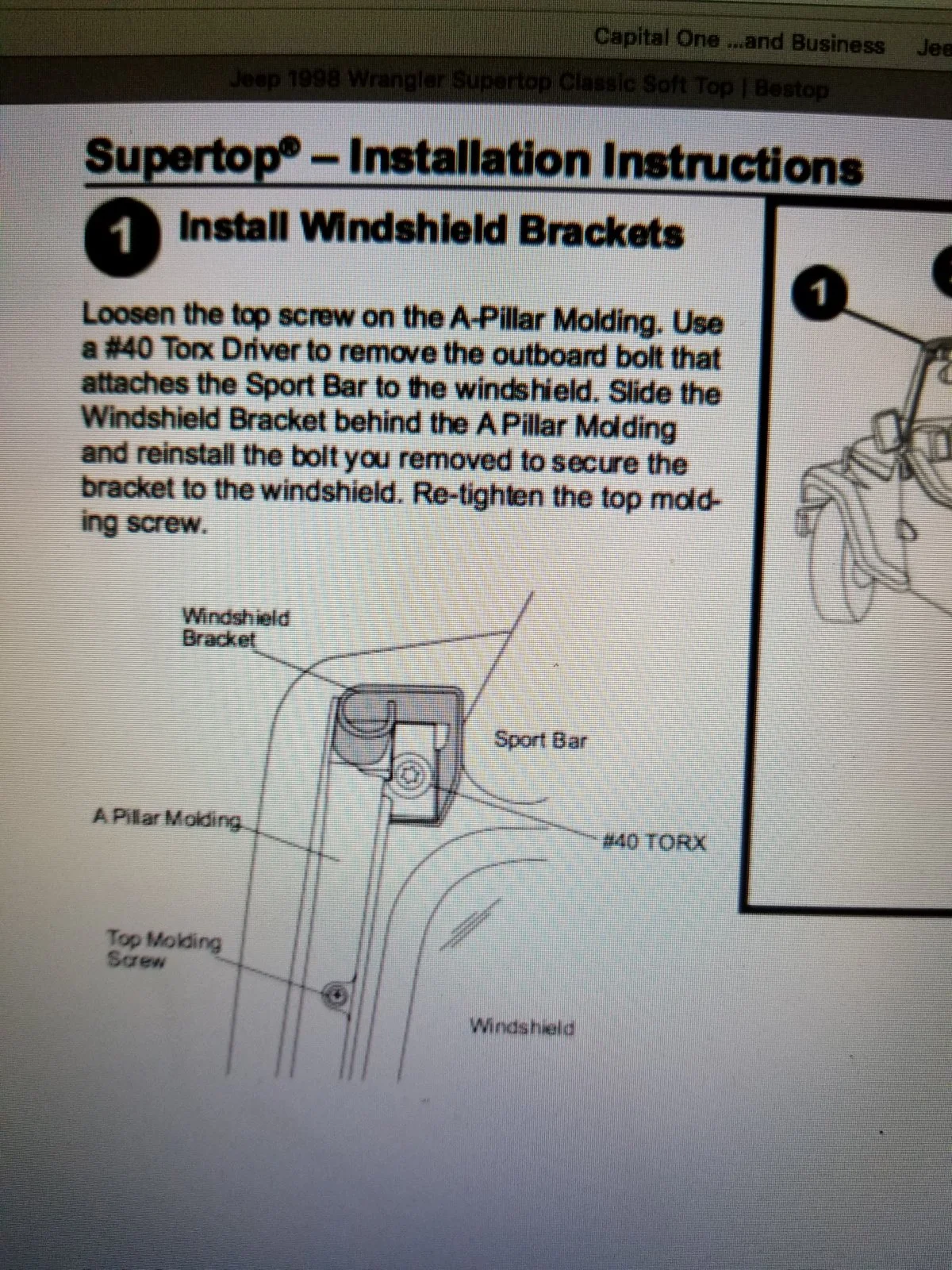

I have the Supertop by bestop and that's the windshield bracket. See attached pic on where it mounts. On bestop website you can find the instruction sheet for the Supertop.
