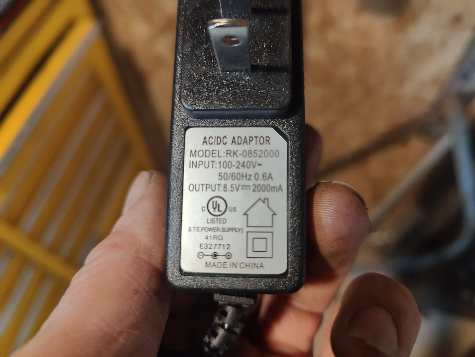

Order a 8.4v adapter from Amazon and that was a bust...none of the plugs fit.
Then I went on a cleaning tear on my garage... mostly digging out my can/bottle recycling trash can so we can use it for shop construction...and low and behold it was sitting on top of the can buried under a pile of lifting straps.
Picture with specs below. Thanks for the help!
