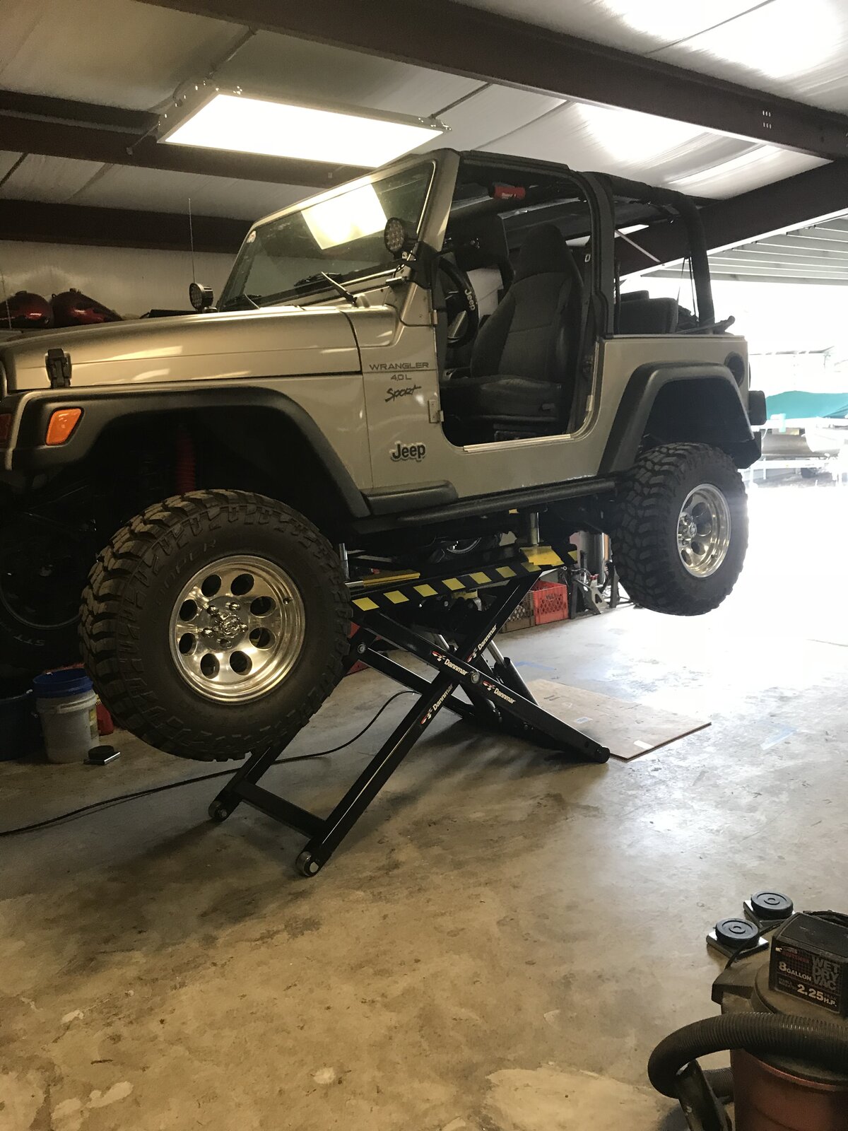

I have a Bendpak Scissors style lift as well. It will hold up to 6,000lbs. Works well and is stable. I like it because it's portable. Here is a picture of my son's Jeep on it:
Here is a review of it: YouTube

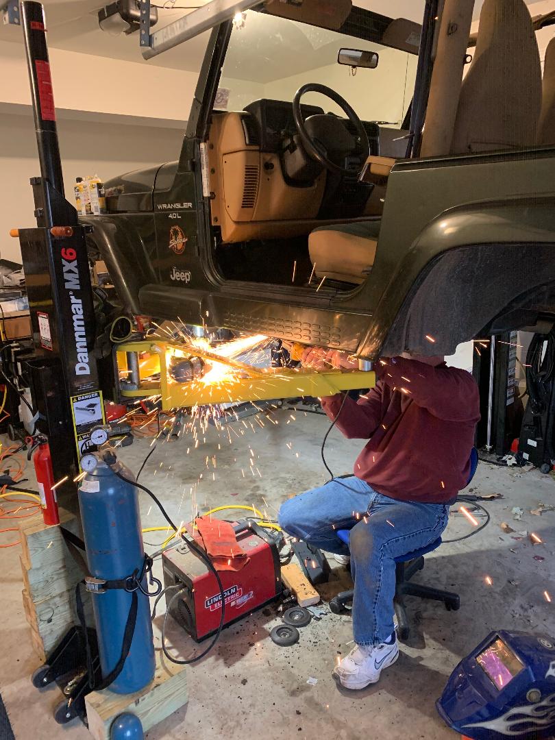

I have a MaxJax lift in my garage with a 12' ceiling. https://www.maxjax.com/
I had to change my garage door opener to one that would sit flush against the ceiling, and you get about 54" of clearance under the car at max height. I have an aircraft-repair mobile chair I use so that I can be comfortable while I am working. 120VAC. You can dismount the posts and roll out of the way, if you are so inclined. I keep the one closest to the wall mounted all the time, and mount/dismount the center post as needed. Rated at 6k lbs. Best money I have spent for a tool: nothing else even comes close. Photos below from my frame swap last winter.

A stool under there is still way better than laying in the ground - that gives me hope for my garage!
