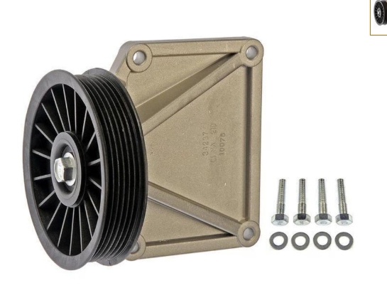

3) Run a A/C delete pulley:

Why would you ever do 3 if you can just run a non AC belt though? Surprised that would even exist

I guess some just want to use their current belt? Or the routing of the belt doesn't work well without the A/C pulley being there?
I just know there are kit available.
But it can't be cheaper than a new belt can it? And there is a routing for no aC compressor, I don't have one. Idk just weird it exists lol
That kit was $75 from AutoZone.
I had one on my Magnum engine because I was going to try to install A/C again at some point.... The Hemi didn't have A/C when I bought it but I added a compressor and the other required pulleys.
I honestly don't know why they make them. One reason I could see is if your car came with A/C and your compressor failed it's a temp fix until you can get the new parts to have A/C again. Because on some engines going from A/C to non-A/C is more than just deleting the A/C compressor.
