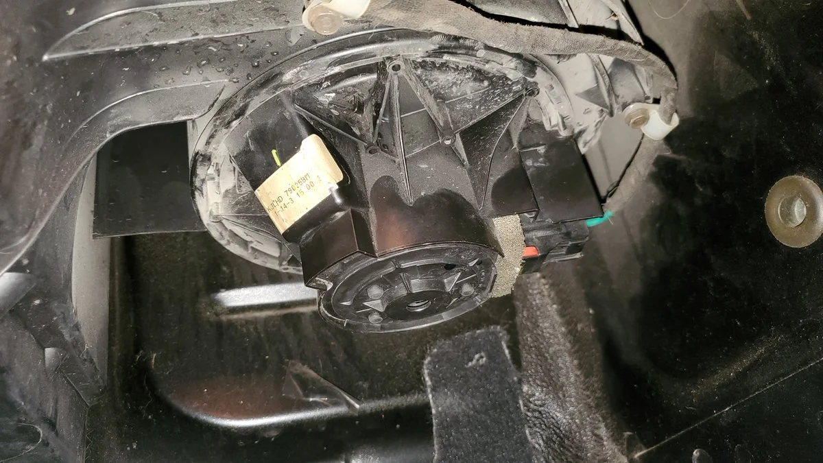

Alright stupid question. How do I get the blower motor out!? I read it unscrews but I cant get the sucker to move help would be appreciated greatly!
My ‘06 has a few screws holding it, then you pushed in on a little tab thing and twisted it and it lowered down into the footwell.
I think it had some screws, maybe not.
In the back corner (farther forward, same side as elec connector), is a plastic tab/tang that you flex downward. Then unscrew. Careful, it's easy to over flex it, then it will not go back to normal position and lock the motor in place.

No screws. I must have confused it with my truck, I dont know.

+1 I replaced mine this way. Pay careful attention to the plug that goes to the motor. Often it gets corroded or burnt from arching. Clean it with contact cleaner and I had to bend the metal contacts a tiny bit to create a tighter fit/connection.
Thanks a ton guys one little tab that would have taken me forever to find! The Manual page was very helpful.
