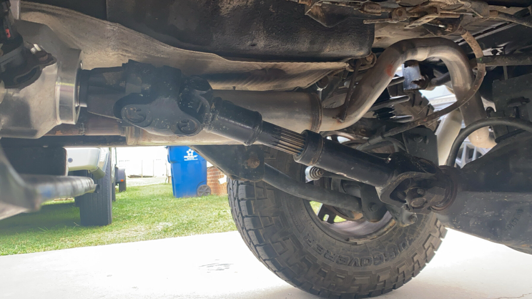

How does my driveshaft angle look
MayzesTJ
May 23, 2024
66
North Carolina
Installed SYE, Adams rear DS. Have jks rear adjustable trac bar and relocation bracket on the way. Have about 4” of lift. How does it look? What needs to be done? Thanks
Pinion looks slightly low, but pretty close to ideal. If it drives without vibes and you don’t get any binding at full droop you’re G2G.
Doesn't really matter what it looks like. It's impossible to tell if it's right from a photo.
Do you have adjustable control arms? Is the pinion aligned within a degree or two with the driveshaft? Does it have driveline vibrations?
In the picture it appears you still have the stock UCAs; with 4" of lift I would expect you to already have adjustable control arms.
Adjustable UCAs can usually assist in correcting pinion to driveshaft angles to 0* when installing a SYE and DC driveshaft.
Yeah PO had done the lift and originally had a tc drop. So installed a sye, will be getting adjustable CAs
Above is the post- optics don’t matter.
What you need to do is keep adjusting the control arms until it is as perfect as it can get.
High level technicians may adjust one 50 times.
