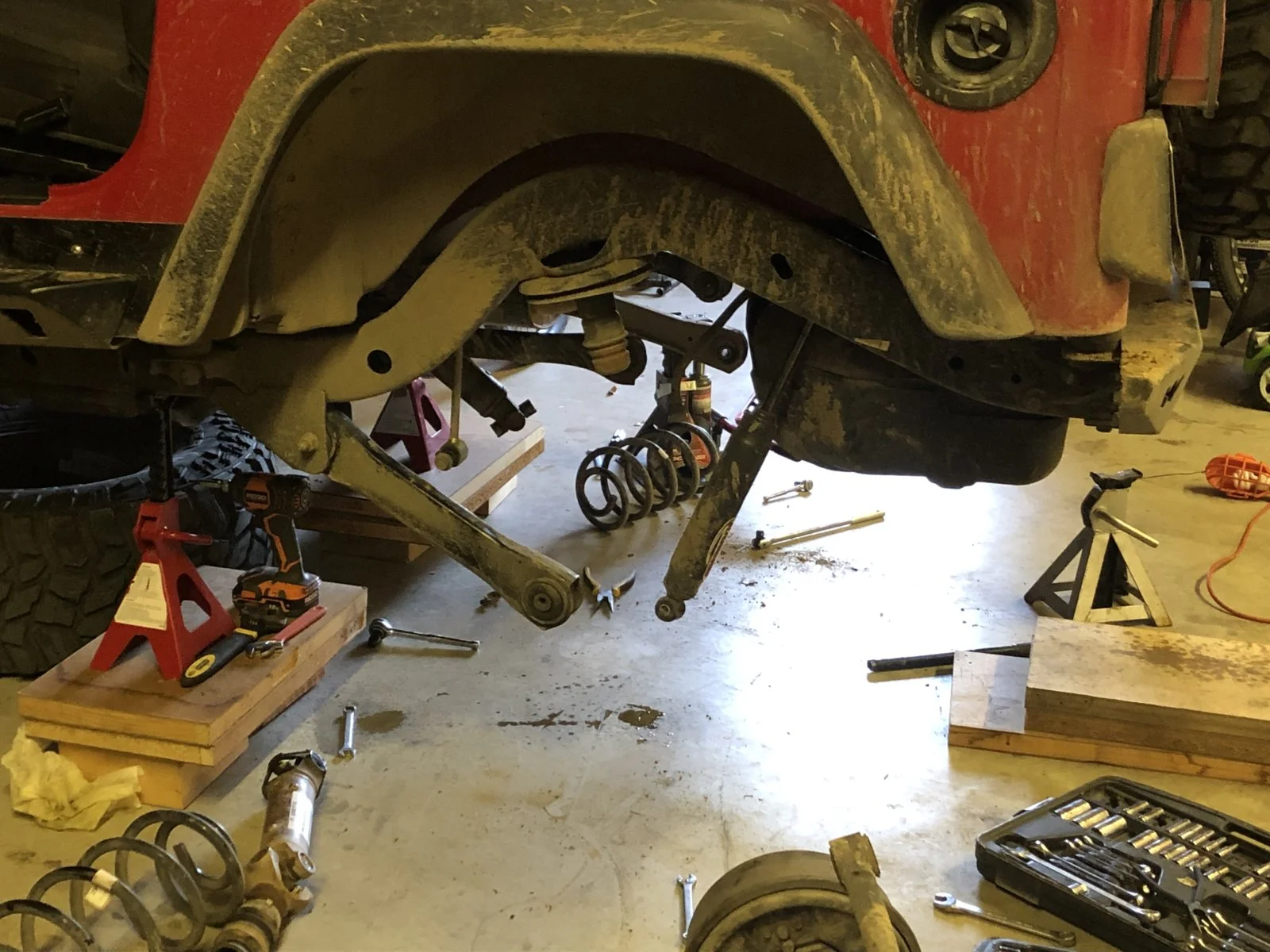

How Long to do a Dana 35 to Dana 44 Axle Swap?
I found it on CL in Austin.
I've been combing CL for one, too. So far, no luck. I wouldn't even mind doing a road trip if I could find one at least in the region. Davey's Jeeps always wants $3,000+ for paired Dana 44 axles.
This has been a long quest. Hopefully I can finish up the swap tomorrow

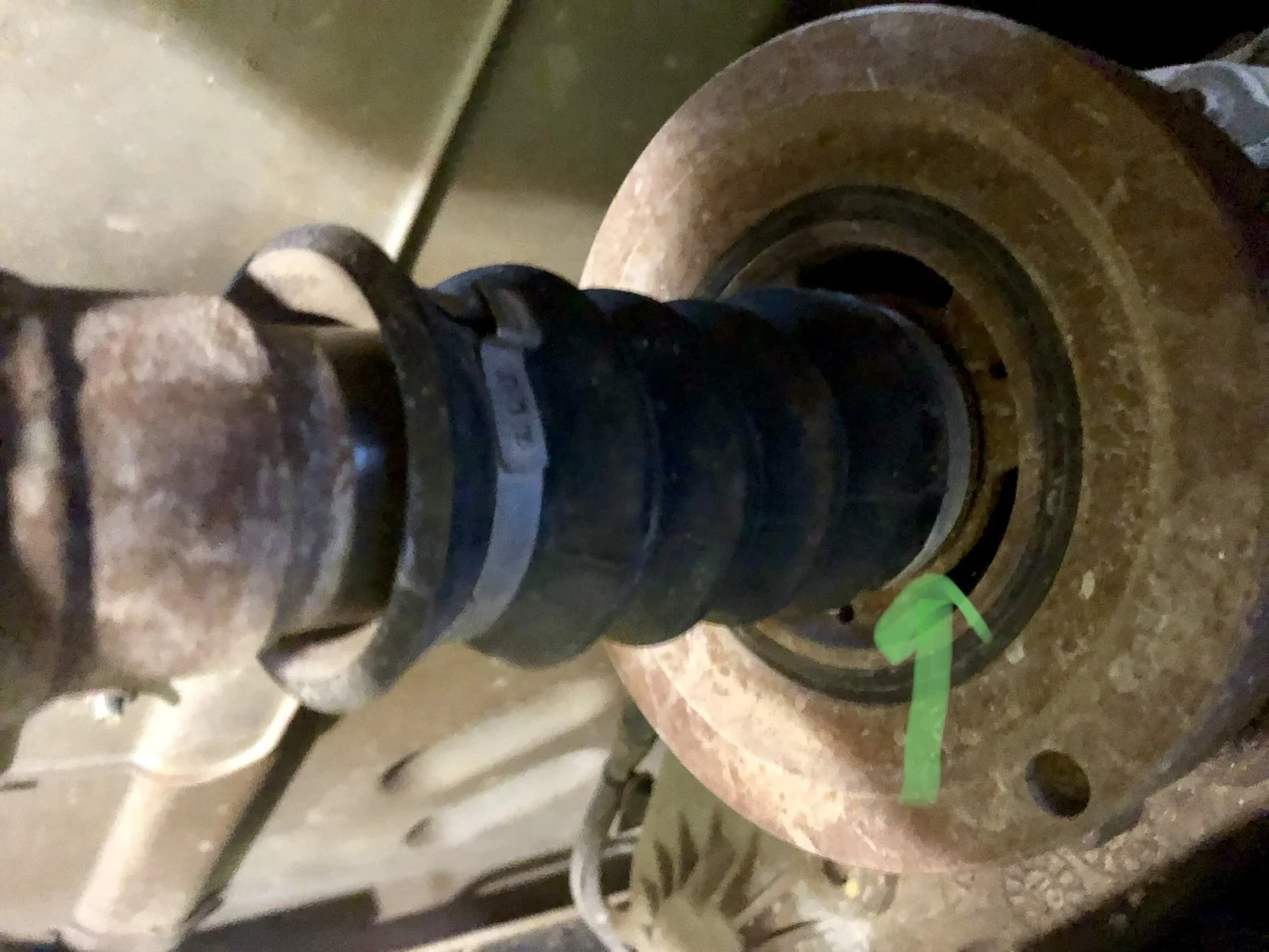

The OE driveshaft should be good to go for your Dana 44 so long as you have some suspension lift installed.
I did this same job recently and used the OE driveshaft, my jeep has zero suspension lift. It was a tight fit, but I was able to get everything connected and has been working fine since.
You might find yourself with a seriously expensive axle or transfer case repair if you take a dip or bump in the road hard enough to need to compress your incompressible rear driveshaft.
This one comment was all the push I needed to finally order the lift I have been looking at for a couple months now :-) Adding 3 inches of suspension lift should take away any issue of a an incompressible rear driveshaft!
