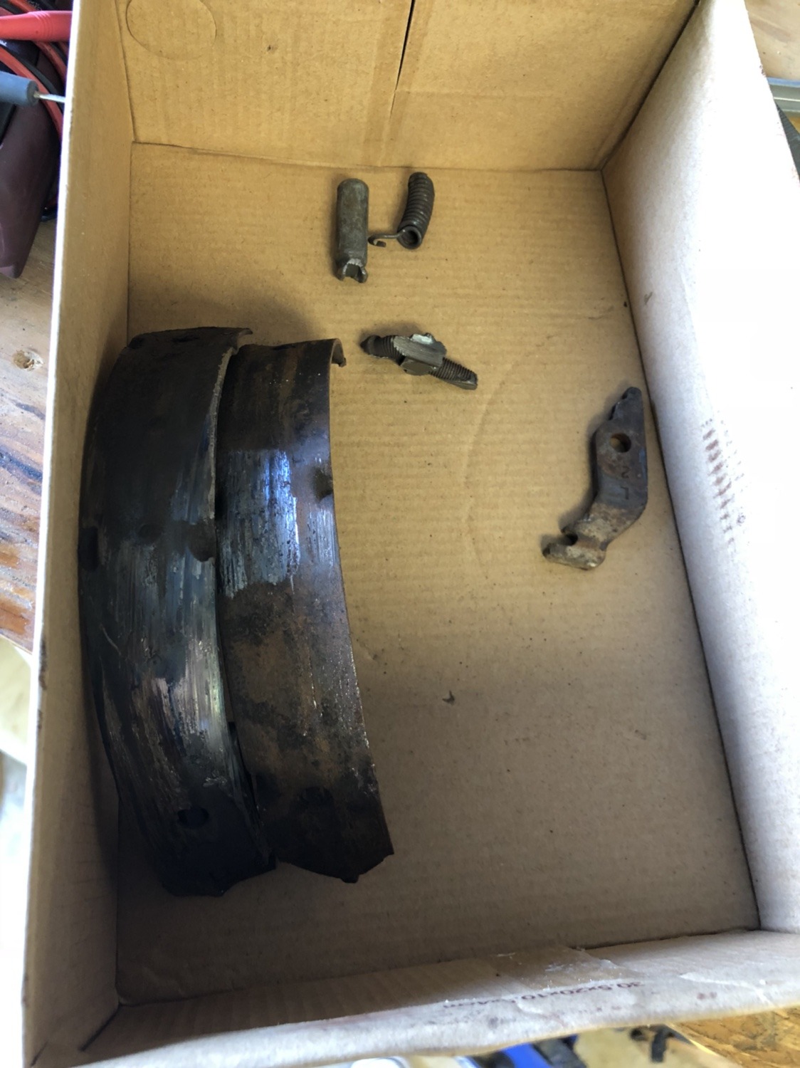

So I got around to looking at the brakes this weekend..... This is what I found.
God Doesn’t Like Ugly!!! That’s Why He Made Me Priddy!!!
You probably ignored and got numbed of the metal squeals to get to that point.
That’s the parking brake... not the brake shoes. It came apart while my wife was driving home from work she didn’t know what happened just heard a pop and grinding noises. Not sure if a spring broke or something, it’s all back together now with all new parts in both sides.
