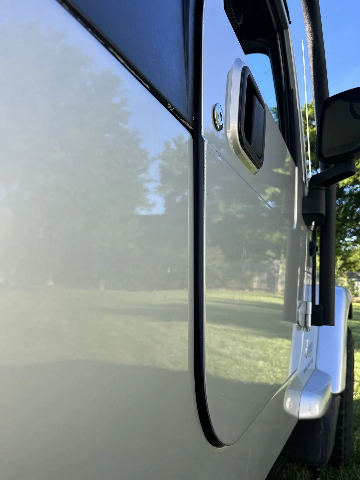

I replaced the weather strip and now the door won’t shut properly. I had to push the upper part of it in and lower part won’t close all the way. Do the new seals need to compress or something?
I replaced the weatherstrip one of my doors and had to move the latch/closure thing on the tub side towards the inside so that it would cause the door to close tighter.
