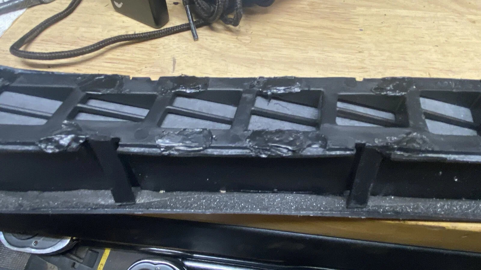

To fix the broken part get it all out of the vent orifice and set it on the bench/table. It’s easy to see how it should all go together. You now see how the factory connected the outer trim piece to the inner piece with wings. There are about 20 of those little spots that are now broken. You can’t JB Weld for Plastics those together. They won’t stay and you’ll just be back at square one, so don’t waste your time. Get a plastic welder from Harbor Freight (~$20 as of Jan 2023). This will be a handy tool for lots of other jobs too.
Follow the instructions using the provided plastic weld sticks. Make sure you have the pieces clamped together before you weld so it’s a tight fit. Weld each spot being careful not to let any of the plastic weld run over the edges (you can remove it with the welder if you do). You can’t have it run over the edges because then it won’t slide into the vent orifice very easily and you may break it again. Doing all this takes ~30 minutes. Let it cool for several minutes. Go on to the Install section since everyone has to do this part.

This is a shot of the plastic weld repair.
