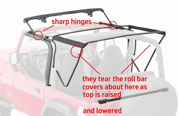

Hi: The original bar covers for my wife's TJ were cut and torn where the convertible bar hinge rubbed against them. This is on both sides, near the top back of the bars, when that hinge between the solid rod and top-tube rubs as it goes up and down.
I didn't want this to happen again, to the new bar covers I just installed, so I cut a couple of little plastic flaps and taped them to the bars. They cover the little hinge part, where the solid bar attaches to the tube with a rivet. But this is temporary, as it is a bit sloppy looking, and they are already tearing a bit. I also thought of filing down the sharper edges of the metal hinge, and might still do that.

Thanks Chris... yes, not the actual covers and padding. We found a nice used set of those on FB Marketplace, from a car that had a hard top on it it's whole life. I DL'd a pic of the top bows/frame, and marked where the sharp hinges are, and where they rub on, and tear, the roll bar covers...

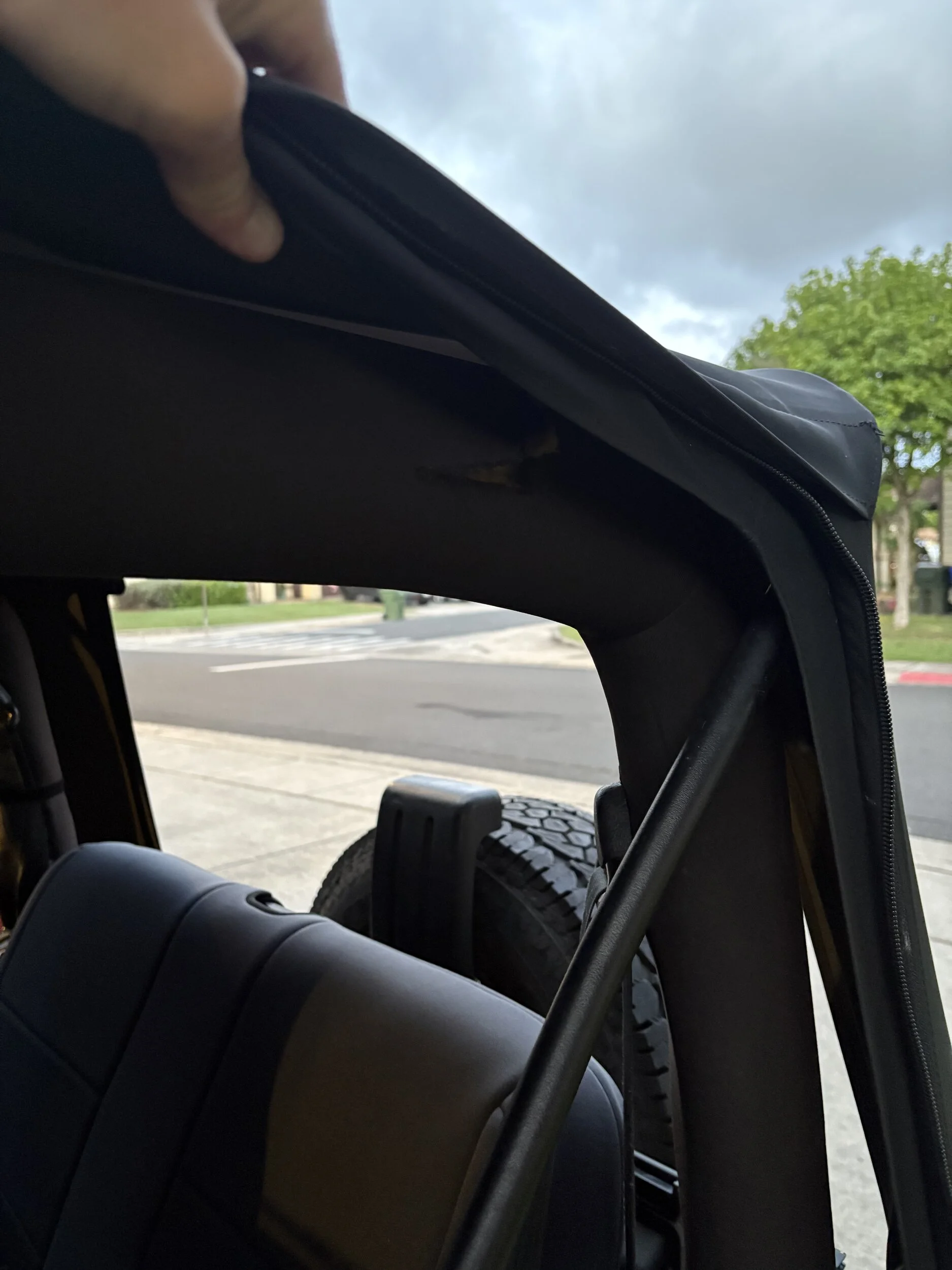

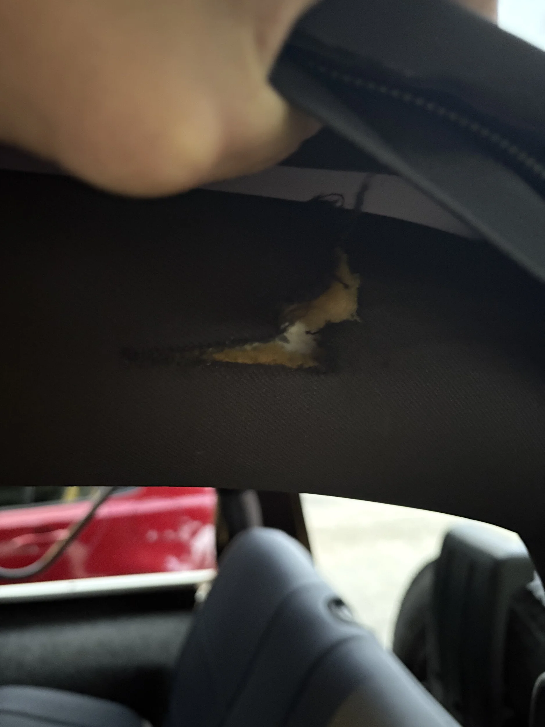

I was surprised to hear someone else has this issue. My roll bar cover has torn at on the drivers side. The covers are old and somewhat faded, but still in great shape so I was a bit ticked off when it happened. Every time I take pull the soft top back I make sure to pull the bar a little bit when it's passing by that section.
I have to admit though, I've been so occupied with other things on the jeep that I haven't taken the time to dive into this issue, but I would love to hear ideas.
Here is a pic for reference if that helps.
