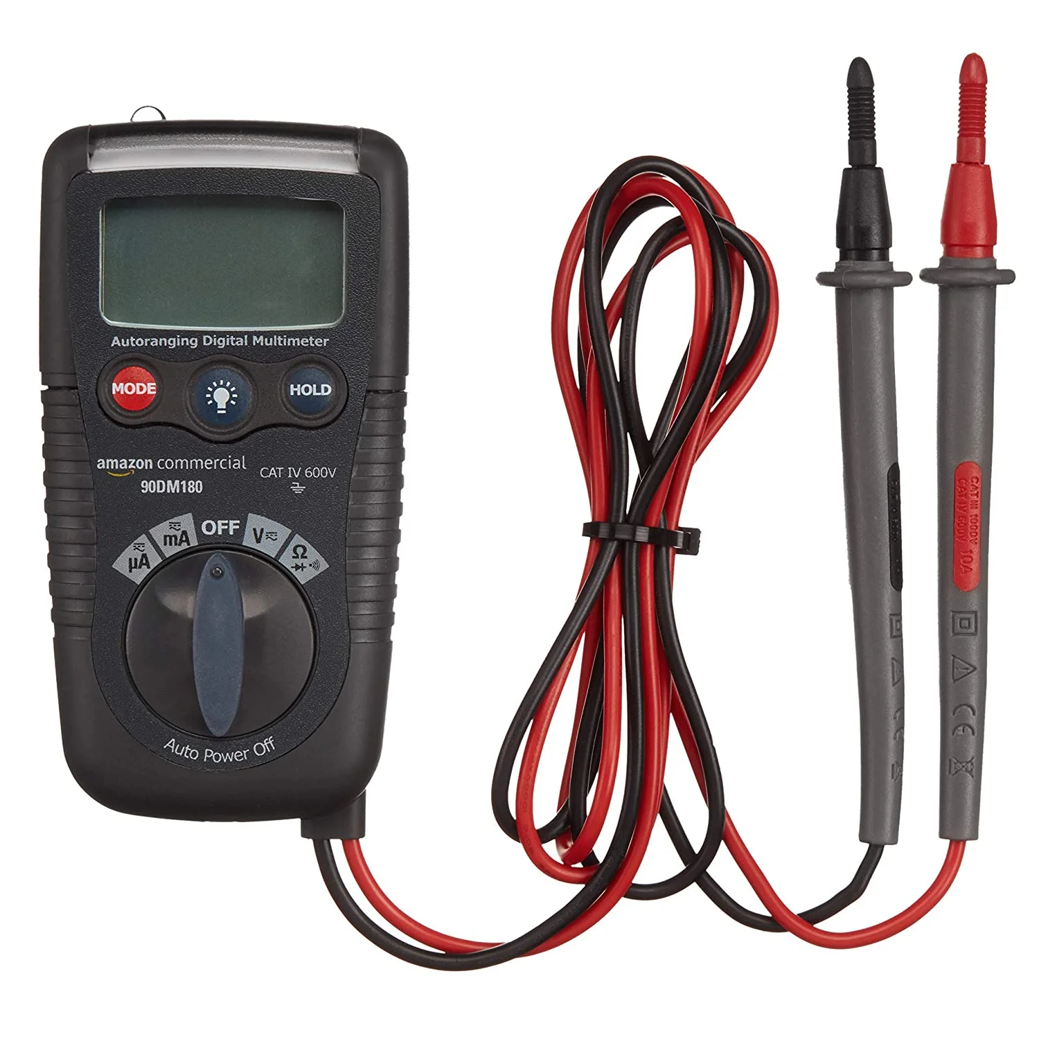

If you have an auto-ranging meter like this simple Amazon model
then select the DC Volts (one click clockwise from the OFF position shown).
