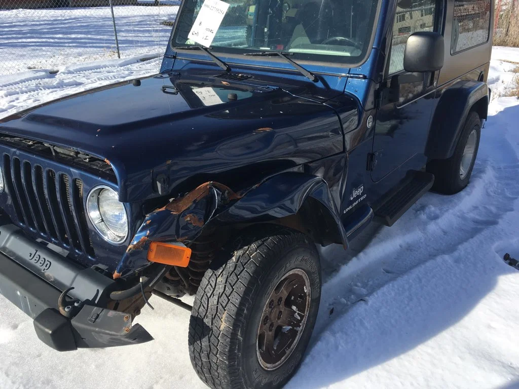

Nice!! Do we get to see a picture of that Jeep?
Its still a wreck...but I did find a hood and fender. once I get the fender off, I can start looking at the frame...even if its bent, I feel that I got it cheap at $6K delivered...
