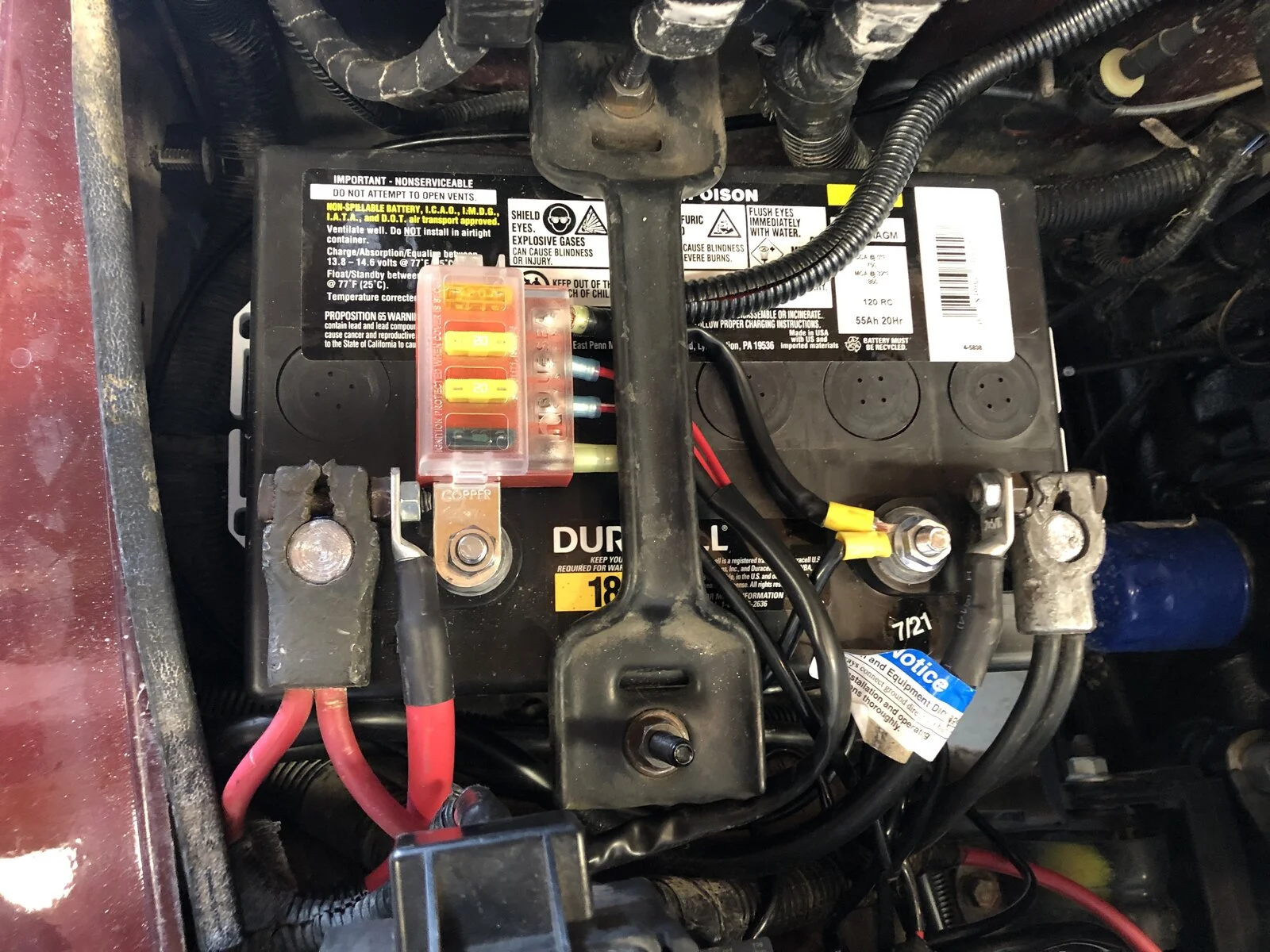

If you have lead connectors you can easily fix them to be tight again around the battery posts. Shave a layer of lead off on both sides of the gap as shown below which will allow the clamps to be tight around the battery posts again. What happens is the battery post and/or the inner round spot of the connectors wear to cause them to no longer fit tightly around the battery posts.
