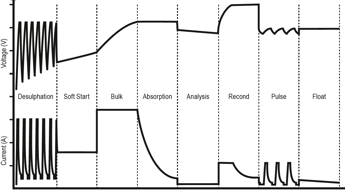

According to the battery charger companies, that is old thinking. Apparently, the reason for the life being shortened is the formation of lead sulfate crystals on the surface of the plates, preventing electron transfer. They claim that applying pulses of high current to the battery will break the crystals from the surface of the plates, allowing electron transfer to occur. Here's the charge profile from my CTEK charger's manual (note the current pulses during the desulfation stage):
This fancy charger is not a dumb device. It's controlling current and/or voltage at various stages to put the most charge on the battery and then maintain the battery in good shape.
I'm still a bit skeptical about it because it's been very hard to confirm what the charger is actually doing. It has a limited number of LEDs, and I've never seen some of them lit, so I don't know if it's really doing what it's supposed to. Of course, I could put a voltage/current logger on it and review that data, but I have too many other projects...

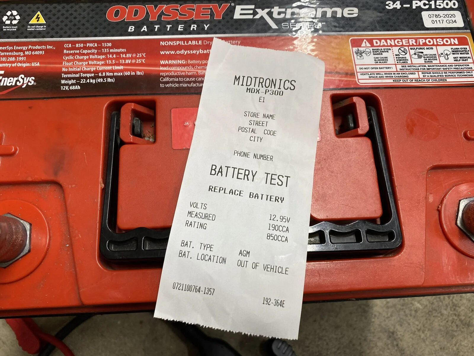

Well, yesterday morning I figured out why it was in Desulfation so long. I didn’t hit the Start button. 🤦🏻‍♂️ I thought it started automatically. Anyway, once I figured that out, I did the Repair and Desulfation again. They were both complete very quickly.

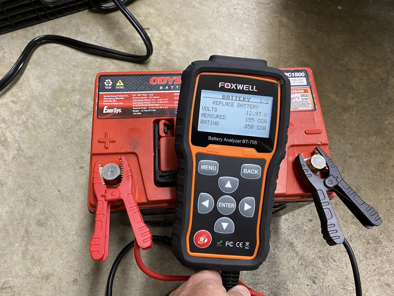

Left it on the 15 amp charge for about 24 hours. It was at 12.97 volts this morning when I checked it with a Foxwell BT-705 Battery Analyzer that I have. It showed 155 CCA (850 CCA battery) and recommended replacing battery. Took it to Advance Auto Parts and had them test it. They showed 190 CCA and also recommended replacement.
Well…crap. 🫤 Time to do some shopping.

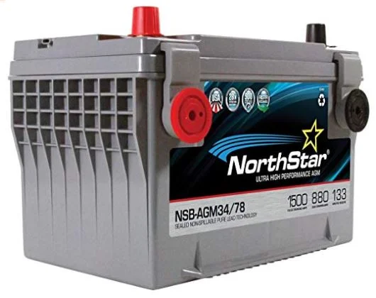

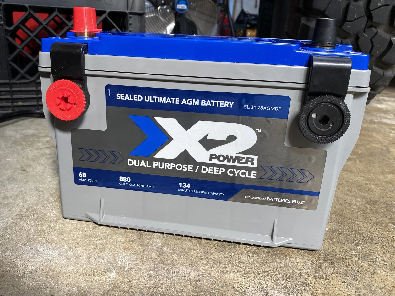

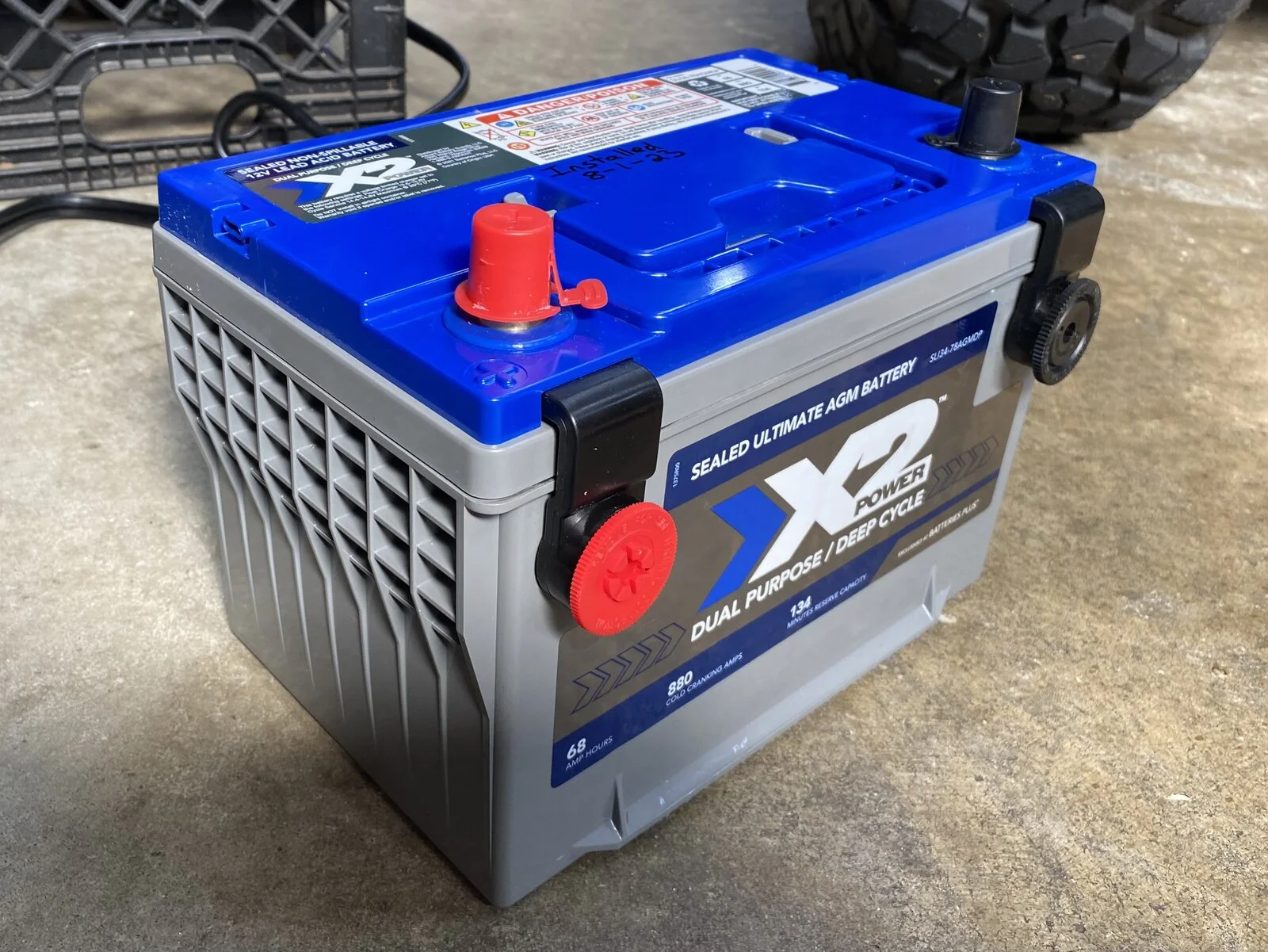

Thinking about getting one of the group 34 / 78 X2 AGM batteries from batteries plus. Apparently made by Northstar also.
I almost got one of those during the height of Covid-related supply-chain issues, but managed to find an actual Northstar instead. I know that doesn't help you, but I did see good things about the Batteries+ version, and they do appear to be a re-badged Northstar battery.
Reactions: MountaineerTom
If it's made by Northstar it'd be an equally good battery, I'm really happy with mine. I really can't tell any difference between it and its twin-brother from Odyssey other than the labels.

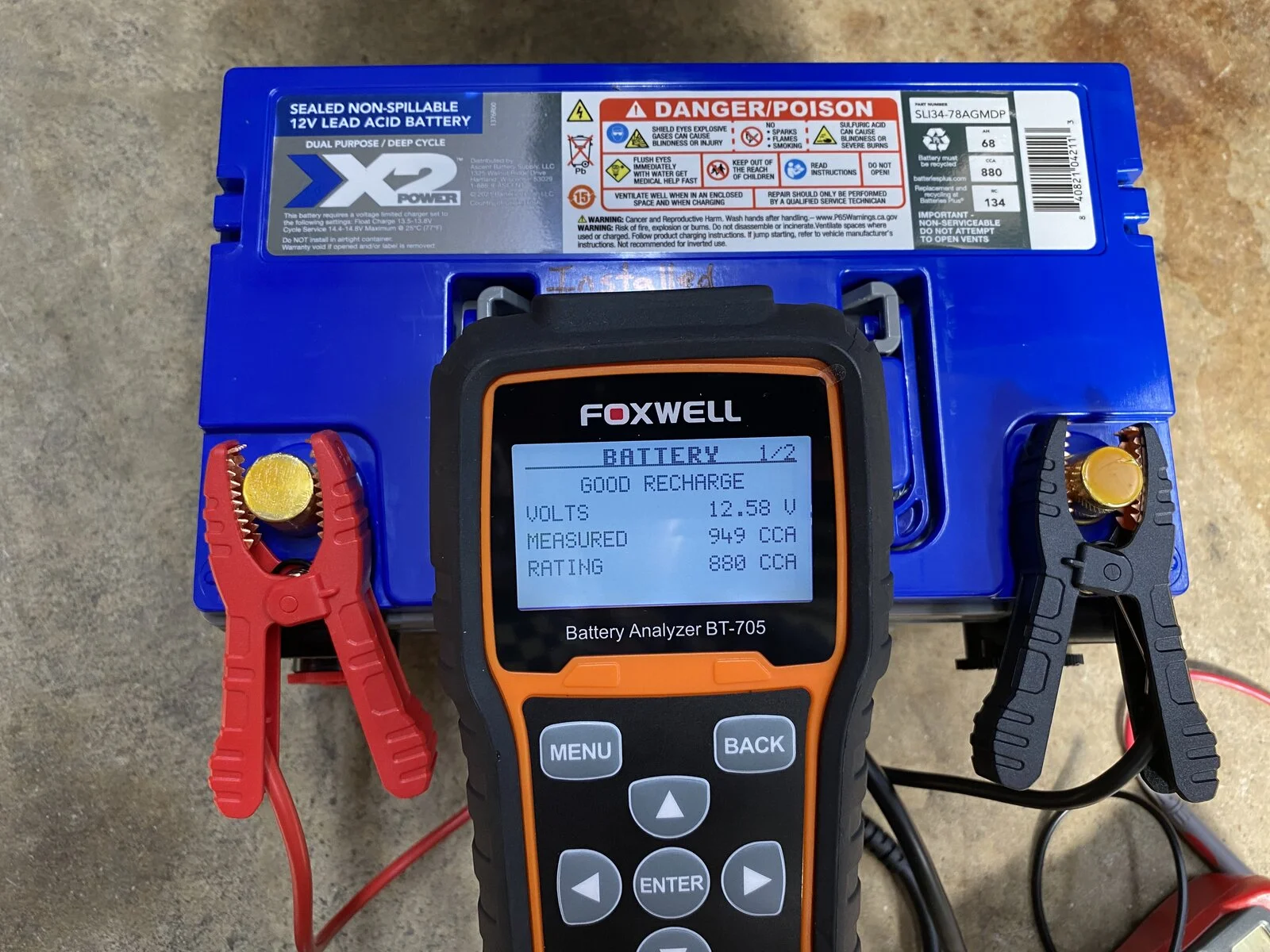

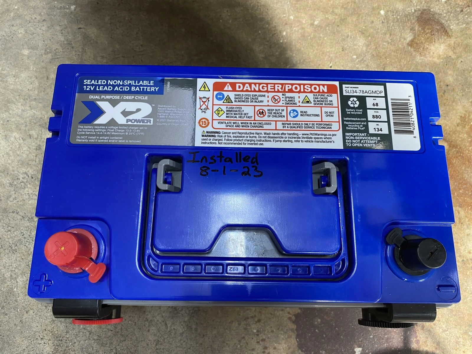

Supposedly, it’s a Northstar battery made for Batteries+. There was a 10% off (up to $30 max) coupon for ordering online and picking up in-store.

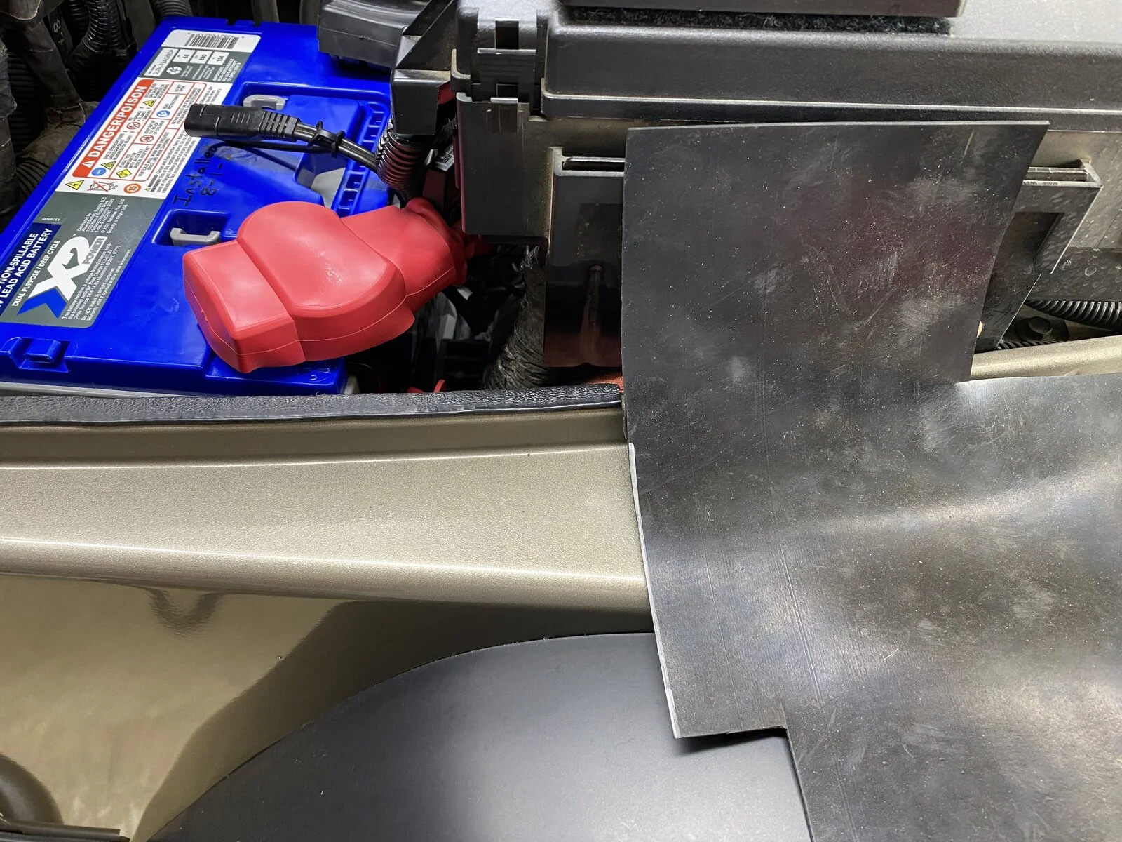

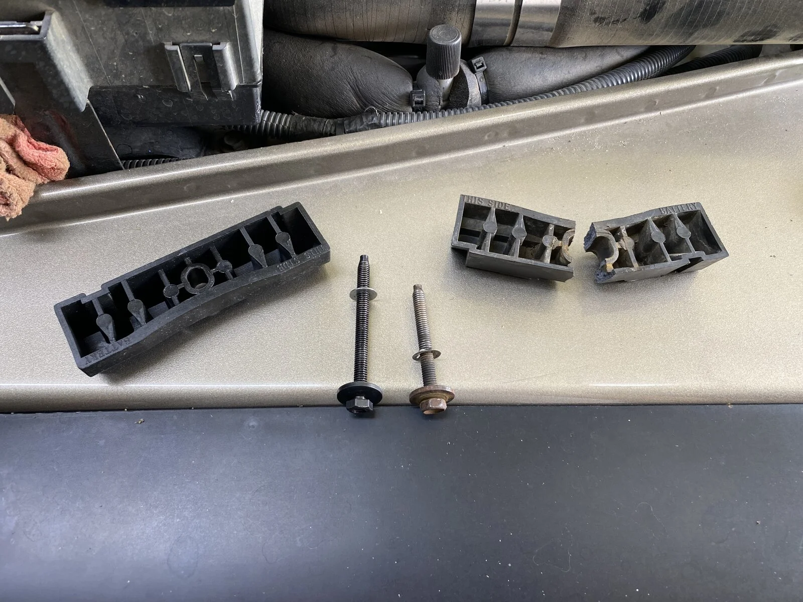

Couldn't finish the install the other day because my battery hold down block cracked. Ordered a Dorman piece from Amazon.
https://www.amazon.com/dp/B00NF18MDS/?tag=wranglerorg-20

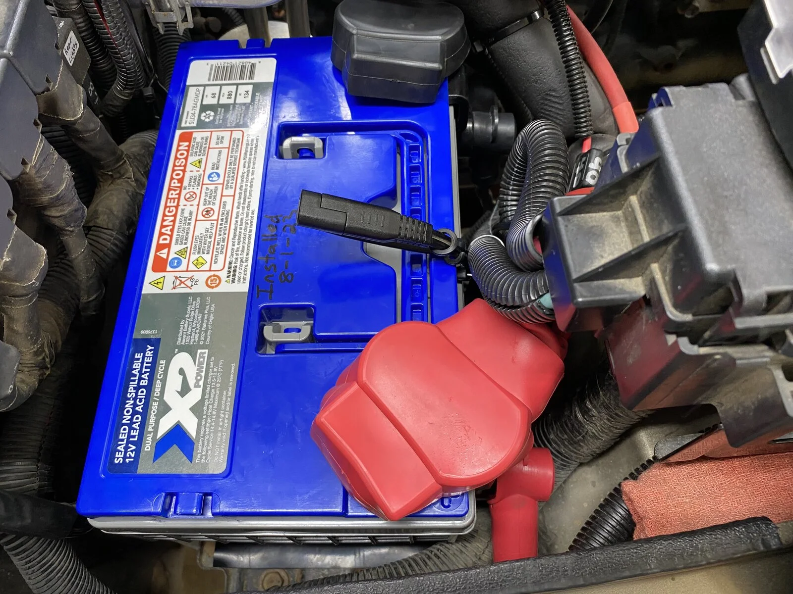

Bolt was in backwards just like some of the reviews state and it was a good bit longer than the original. I just removed the bolt that came with it and reused my OEM bolt, installed from the right direction.
For some reason, the battery sit a little looser once tightened down compared to the Odyssey. I had some thin rubber sheets, so I just cut a piece out to make a mat to sit in the tray. Snugged up tight, but I'll keep an eye on it. Jeep fired up strong.
