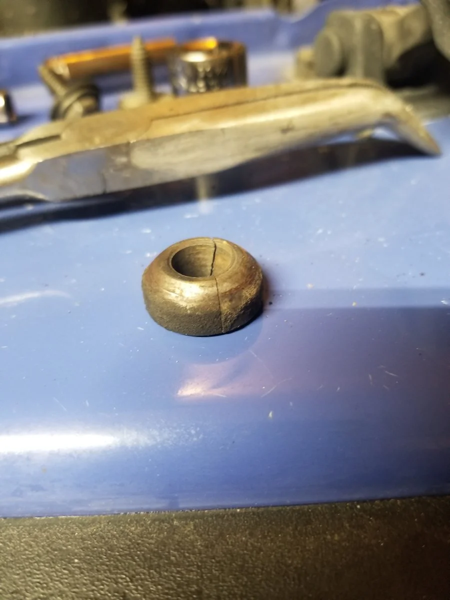

When i pulled the idler pully i found the spacer cracked in half.
It is tapered on top to center the pulley. Any ideas on where i can get one. Im not sure if ACE is going to have them.

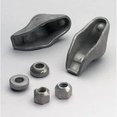

Well I figured out what it was. The previous owner used to small block Chevy rocker arm pivot bushing as a spacer. Why can't people just do s*** the right way
