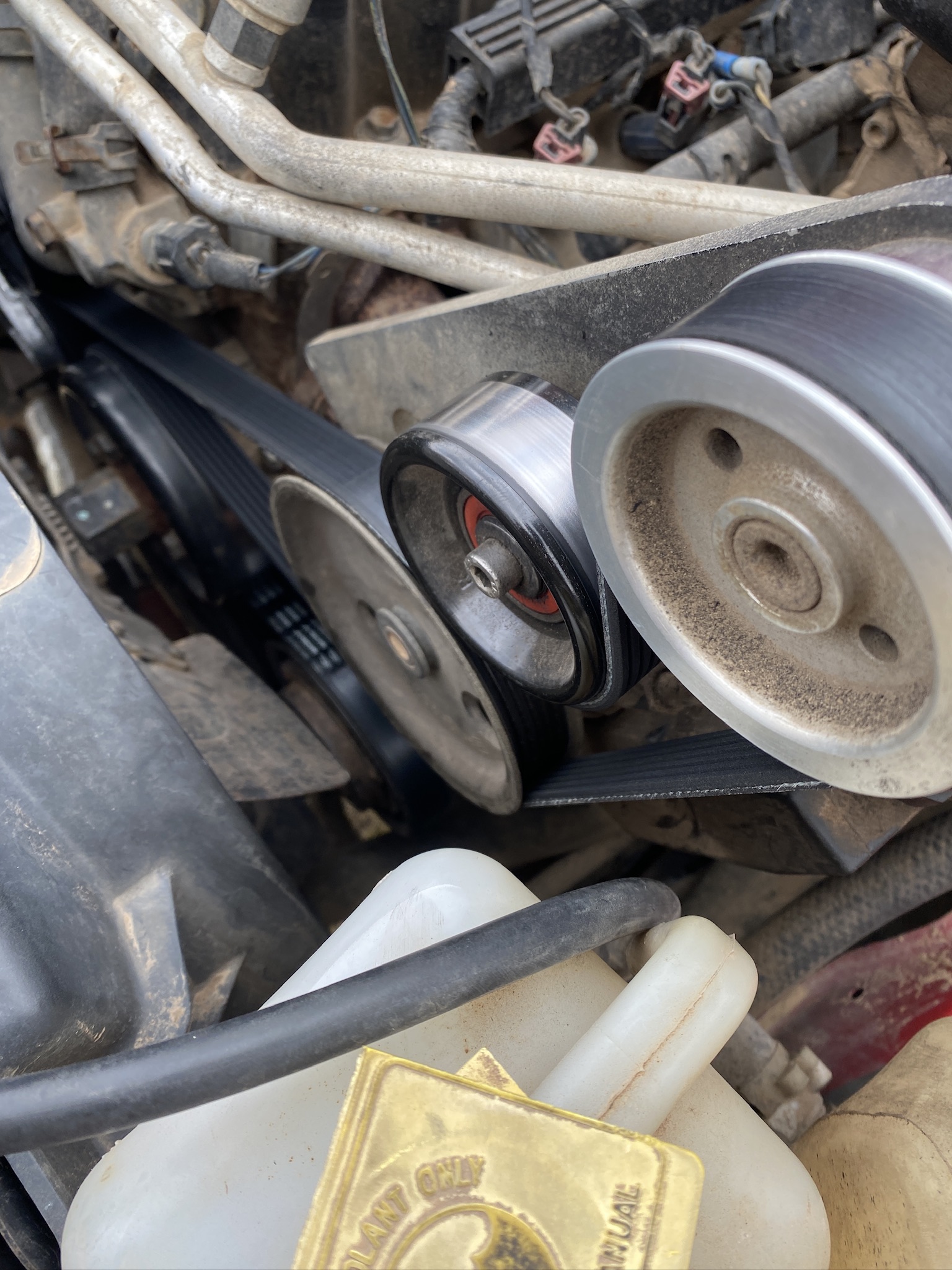

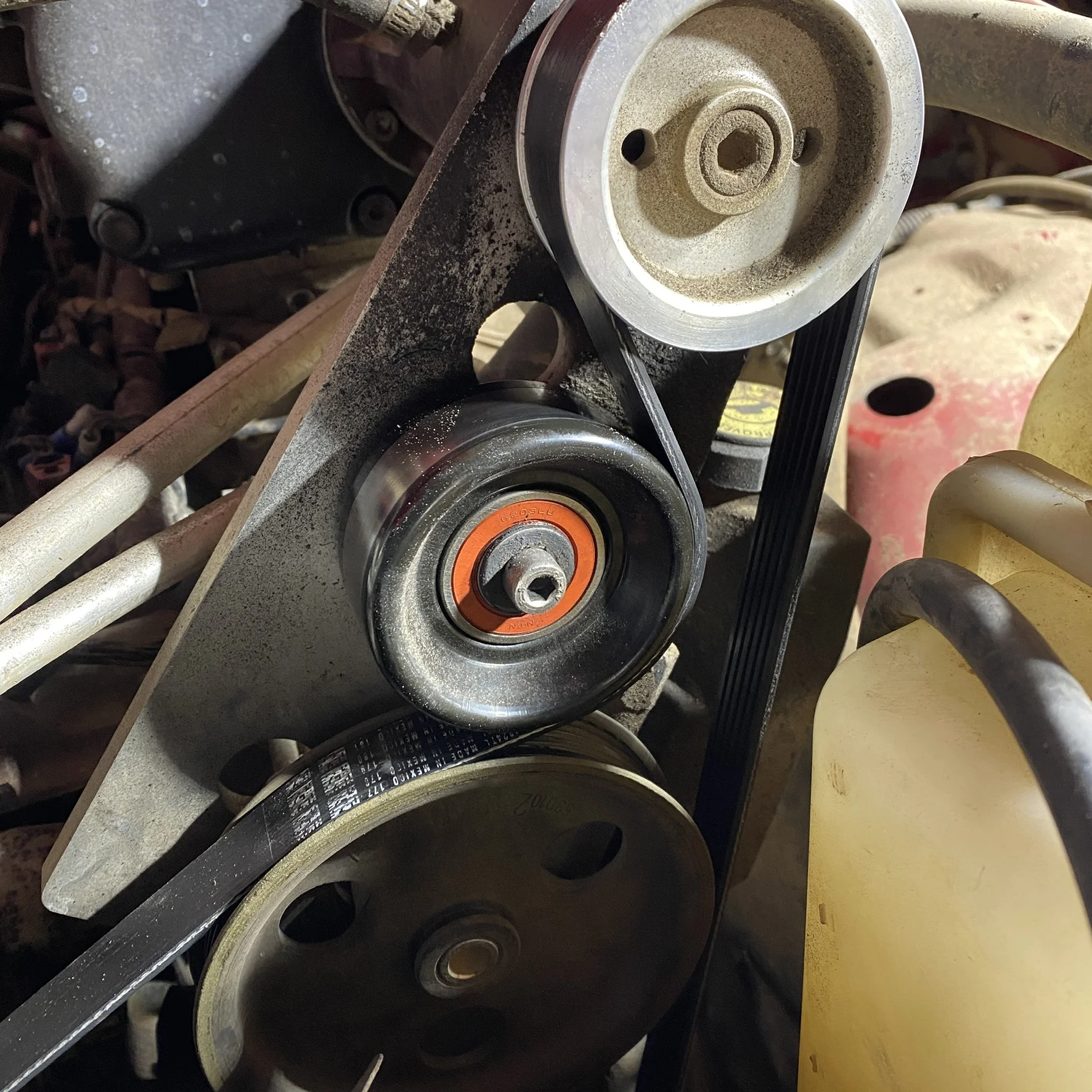

2) Is the belt routed properly? See pic below of how mine is routed. The belt doesn’t have much contact with the power steering pulley which I think is why I loose power steering intermittently for short periods of time. I can see one other belt routing possibility, but the clearance would be close. I’m not actually sure if there is enough clearance for the cooling line.

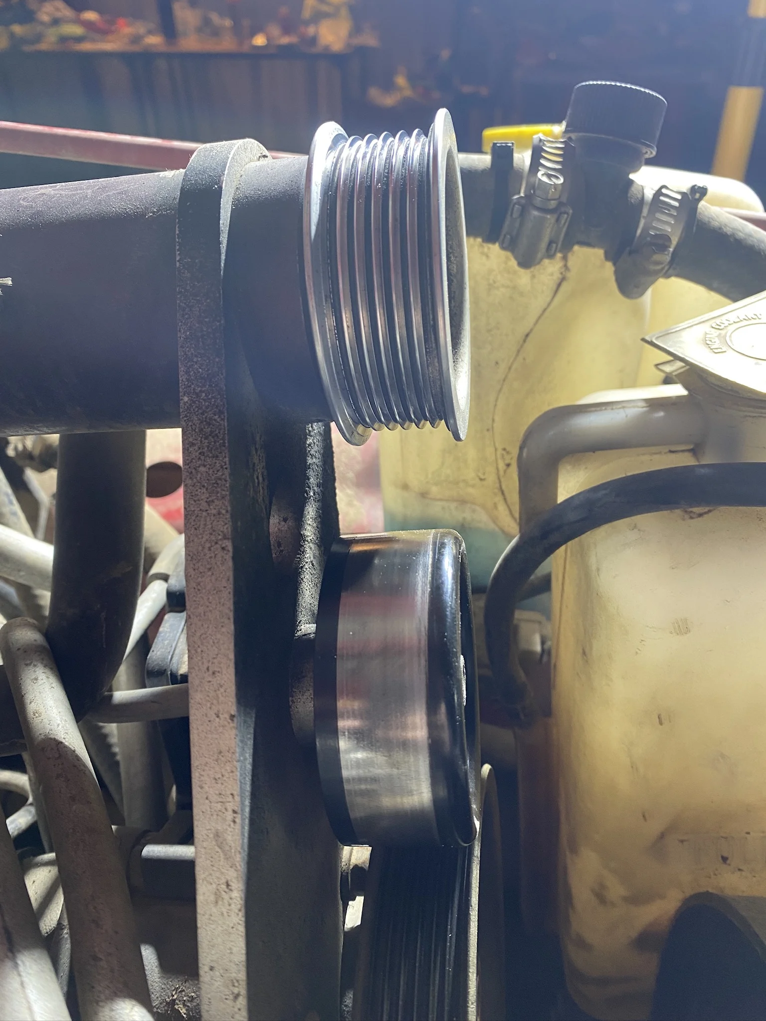

3) Would a spacer behind the idler pulley for the supercharger help with the squealing? The idler pulley for the supercharger is not in line with the pulley for the supercharger. See pic below.

Here’s a pic showing the belt contact with the power steering pulley. Supercharger pulley is on top, idler pulley is in the middle, and the power steering pulley is on the bottom.
Here’s a pic showing the supercharger pulley and idler pulley. I think the idler pulley needs a spacer.
The wear from the belt is nearly centered on the idler, that's not your problem.
There's almost no belt contact on the pwr steering pulley, that's most likely the squealing as it slips and why you lose pwr steering.
No idea if that's the correct belt routing for that.
@JKP and @TJ Jim That’s what I thought about the power steering as well. @KennethS I agree with you, but the clearance getting back to the stock idler pulley is going to be close to miss the radiator hose. I’m also pretty sure that I’ll need a longer belt, but I’ll play around with it more this weekend.

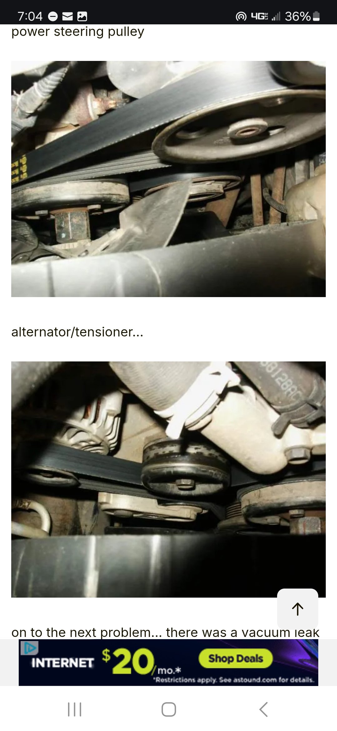

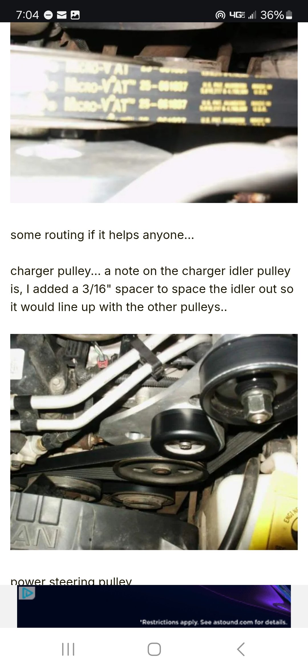

Instead of doing that look at the pics in this avenger sc thread. Looks like the belt is hitting both sides of the ps pulley
Reactions: OkieJoe
Some more pics
"belt # 1037.. the supplied belt was 1033 and apparently does fit some.. just wouldn't work for me. "
The OP in that thread has the exact same setup as mine. It looks like our belts are routed the same. I don’t think that the belt is hitting both sides of the ps pulley. Mine kind of looks like it does also, but there’s a small gap between the pulley and belt. After reading through the thread, it sounds like the PS issue was a concern with the earlier version of the Avenger supercharger. I’m still going to play around with rerouting, but that thread has at least confirmed a couple of things for me. Thanks for sharing it.

Look at the other pics,the last one in particular. It is indeed in contact with both sides. Also gives a pretty good idea of the rest of the routing

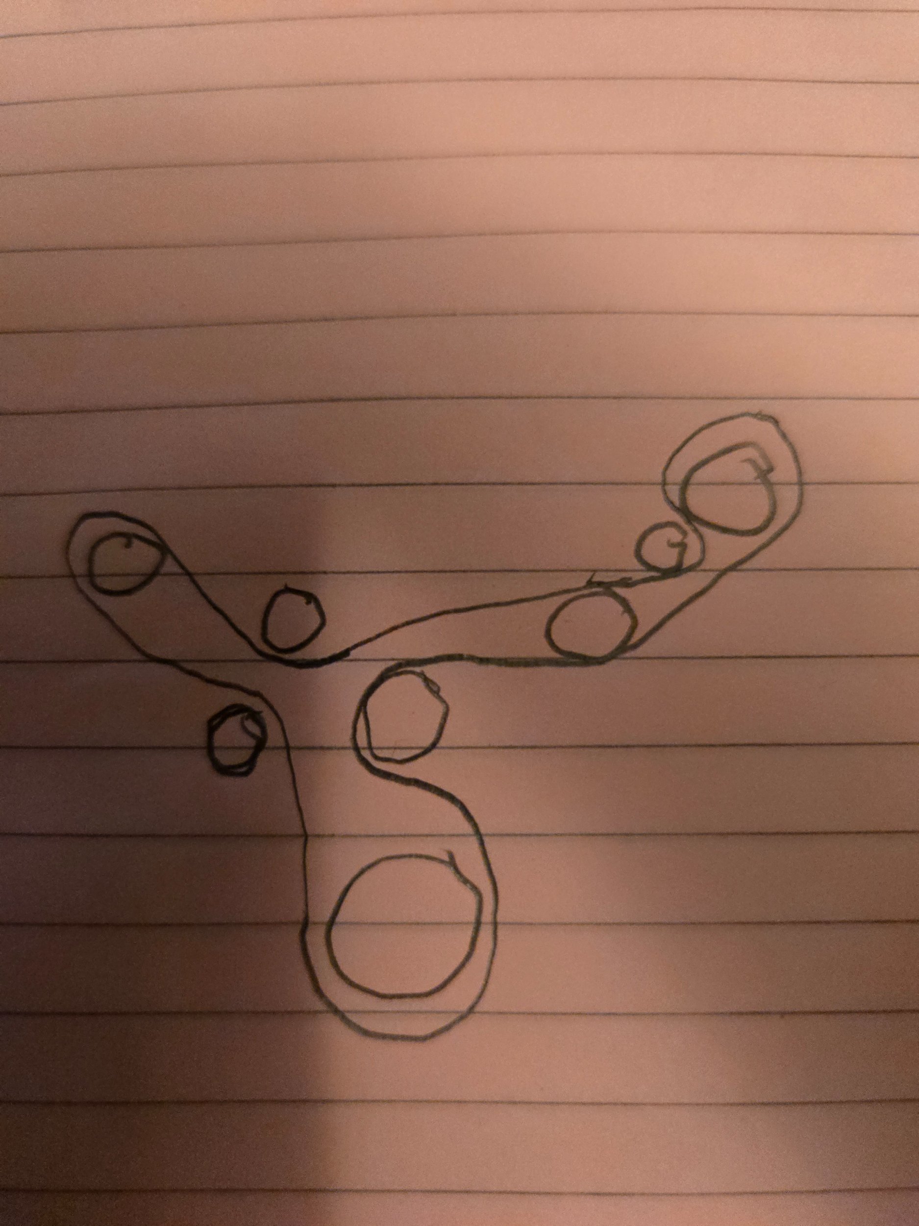

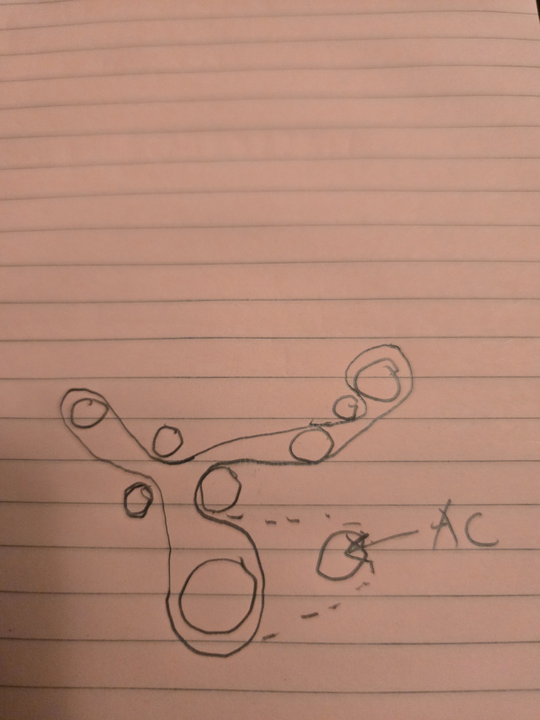

You are correct. Pretty sure now that my belt is not routed correctly. What I’m having trouble visualizing is my AC pulley. I can’t tell how it’s routed in the pic that you provided. It looks like that one has AC as well. I completely understand your drawing, but I’ll have to figure it out with the AC. With the way mine is routed now, the AC pulley is what’s preventing the belt from making contact with the PS pulley on both sides. My old eyes are getting tired, but I’ll make a quick drawing of my setup tomorrow morning and get it posted. Thanks again for the help.
Oops.yeah,I meant to include that
After a good night of sleep and coffee back in my system, your drawing makes perfect sense. I’ll be heading to the parts store later today for a new belt. I’m confident that this will fix my issue. I’m starting to understand why folks look for a stock TJ when buying one. I’ll post an update later today with the new routing of the belt. The pics and drawings that you provided have helped tremendously!

I took your advice and measured… multiple times. The reason for the multiple measurements is because I kept coming up with a much shorter length than what the PO had installed which was a 1031. I was expecting to need a longer belt. Double and triple checked before I trusted my math. Ended up buying a 1025 and it works perfectly with the proper routing. The squealing sound is completely gone. Thanks again for all the help!
