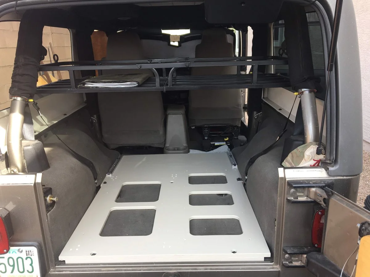

You could make a base plate out of 3/4” plywood, add some pronged tee nuts, and mount the cans to the plate.
The rear edge of the plate can be secured with the M8 bolts that hold the rear hooks for child safety seats. For the front edge you may have to get a bit creative. Maybe use the seat belt anchor in the center or the a seat bracket bolt on the edges???
You would build smaller version, without the cut outs, of this full length plate I made for my LJ with the seat removed.
I used spacer blocks on mine where the bolts passed through in order not to crush the carpet when you tighten down the bolts.

@2003TJ I completely get leaving in the the rear seat.
I showed my base plate only as an example of what you might want to think about in a shorter version.
Jgaz exactly as I assumed you showed your base plate. A shorter version would have to be made, in my case. Think these Ammo Cans will work well!
Could you build a base plate as big as the whole rear deck and use longer bolts to mount the bench seat through the 3/4 ply, and then into the floor mounts? You'd get a super stable mount for anything you need. Pull the seat and have other boxes mount right in. Ready for an offroad weekend in a Jiffy.
