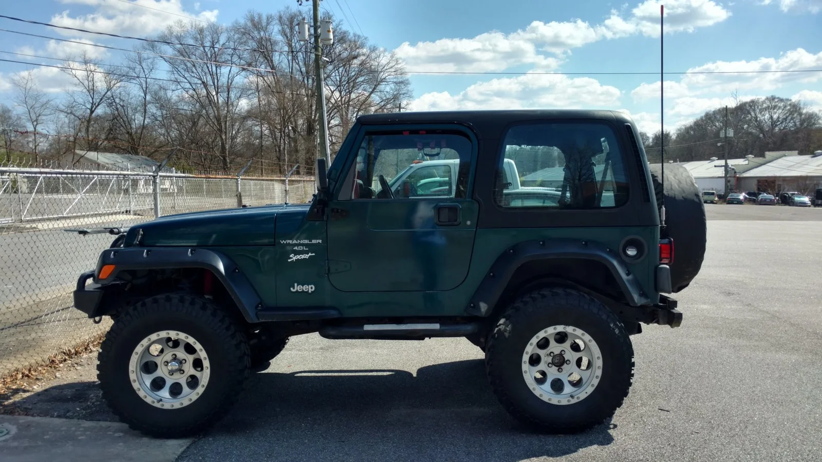

In general with roughly 4" of lift, no it won't. The wheelbase is determined by stuffing the axle fully and centering the wheels in the wheel opening. With a 35" tire and a decent amount of uptravel, you don't have much leeway at either side to adjust the wheelbase so you center the tire and the wheelbase is what it is.
