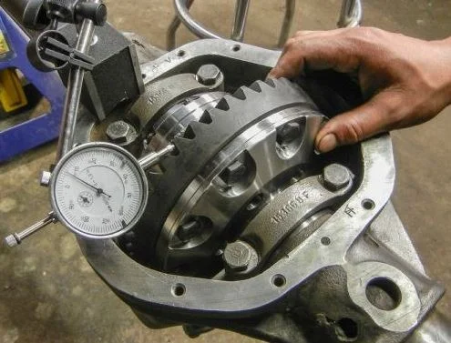

@Rob5589 so I've got the old diff out now. I measured backlash before taking it out (measured .003 to .004 - pending I did it right). I've only got the two spacers, one on each side, so I'm assuming the shims are underneath the carrier bearings. I have new bearings and a set of shims. Question: Is it easier to just reinstall the existing shims and mess around with different sized spacers, or will that not get me close enough to the true backlash and pattern I need? I feel like I need a setup bearing for this because I really don't think this DTT will be the same fit as the open diff. Thank you for your time and sorry to @Thumper4fun for highjacking your post. I hope we can add something to benefit from it for others.
Those “spacers” are the carriers shims. I just regeared mine 44’s and there were no shims under the carrier bearings, just one thick shim on each side to adjust backlash. When reinstalling, I started by using the original thick spacers, checked backlash and adjusted by using different thickness shims until BL was within spec.
Reactions: MtnRanger160
The shims that came with my new bearings only fit around the housing. They're not large enough to fit where the spacers are. Guess I need to get a new shim set then. Thanks for the help.
I picked up a master install kit and it had a selection of shims for the inner and outer pinion as well as shims the same diameter as the thick shims
