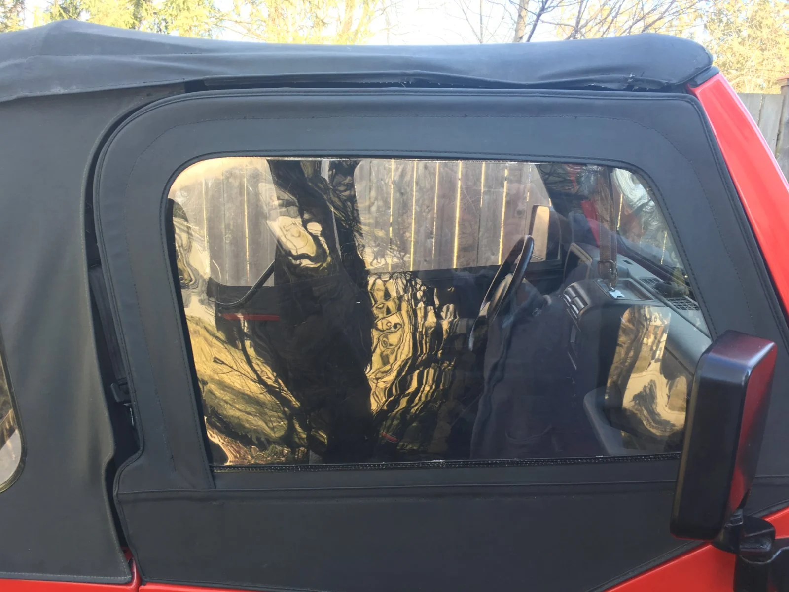

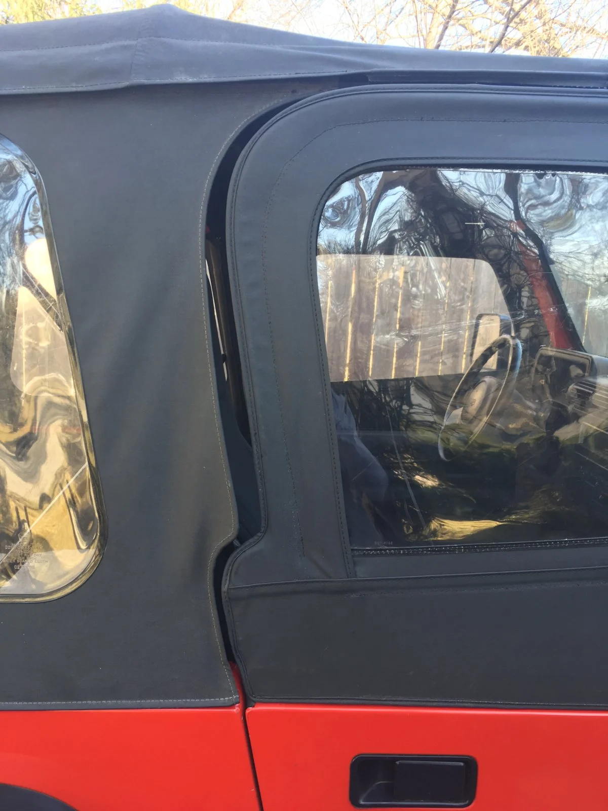

Over the weekend I installed my soft top, for the first time. I own a 20 yr old jeep, which came with both hard top and soft top. After we installed the soft top (which, according to YouTube is easy, but is definetly not) there are very large gaps around both windows. Is this a simple adjustment?

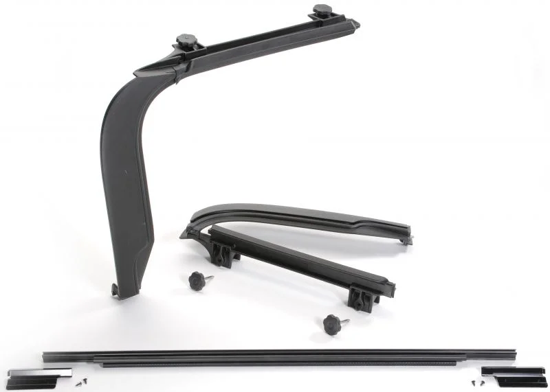

Did you also install the door surrounds/frames that kind of look like big boomerangs? They serve as the door jamb behind the top-half of the soft door window, and they serve as a frame for the top to snap into to give it a tight fit.
These, the top-left part in this photo. They are shown installed above in Txxtsty's photo.
