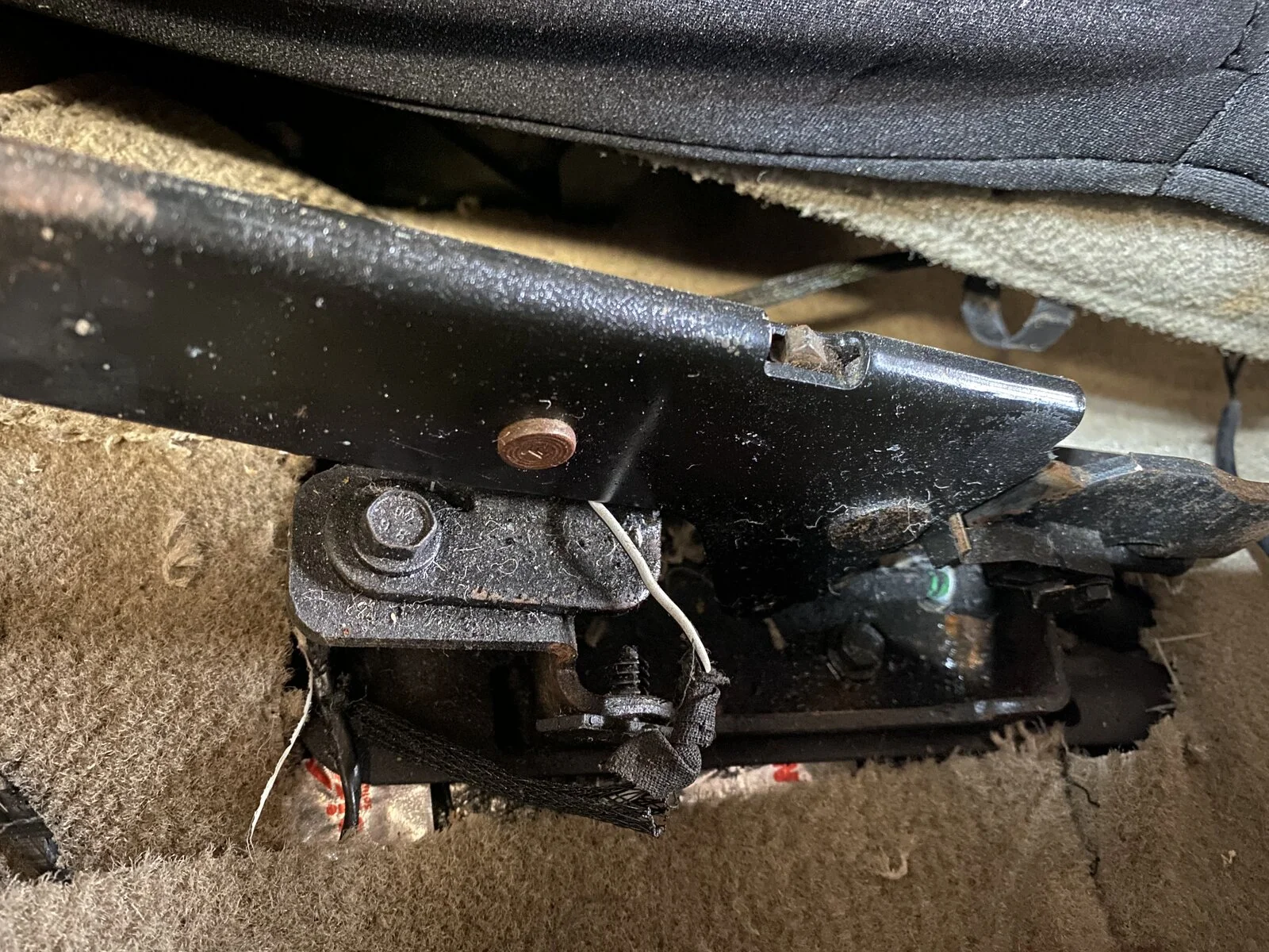

I loosened up my parking brake to do my rear drums. I went to tighten the cable back and when I did, the brake light on the instrument panel stays on. If I engage the parking brake the light goes off. So I re-loosened the parking brake cable and now the indicator comes on and beeps at me multiple times while driving. Seems to go off temporarily when I lightly pull up on the parking brake. Any thoughts?
Figured it out. Sensor wire was disconnected and grounding out when parking brake was down.
