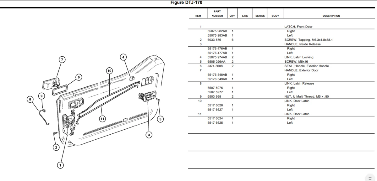

Does anyone know the piece for the inside half doors door latch? Mine snapped when I was opening the door the other day, so now I pull the interior handle and nothing happens. I need the lower latch rod retainer
Not sure what part you mean exactly, but all the FSMs and part # guides are over in the TJ Resources section of this forum, here's a snapshot of the half door's latches and stuff for your 2001
