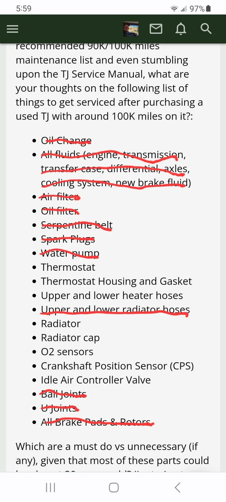

In the 3 years since I've owned mine (bought with about 145k miles on it) I've done everything struck through in red, and well as a bunch of other stuff.
The thing is, these jeeps are really easy to work on, and diagnose. O er 3 years, I haven't really noticed the cost because any one of those things I've done wasn't very expensive if you are willing to turn your own wrenches.
There's tons of YouTube videos on all of this, and there's a bunch of knowledgeable people here willing to help when you have a question.
I wouldn't fret. Start with the easy stuff. Changing fluids, checking brakes to see if they need replacement, checking hoses and belts for cracking, replacing what needs it.
By the time you are ready to tackle bigger stuff, you will have built skills and knowledge, and have a better idea of what questions to ask (and what videos to search) to tackle them.
Reactions: Granite and sab
Thank you! This sounds like solid advice and makes sense to start small before trying to get everything fix at once! The ones you highlighted in red also seems to match what others are saying! Awesome!
