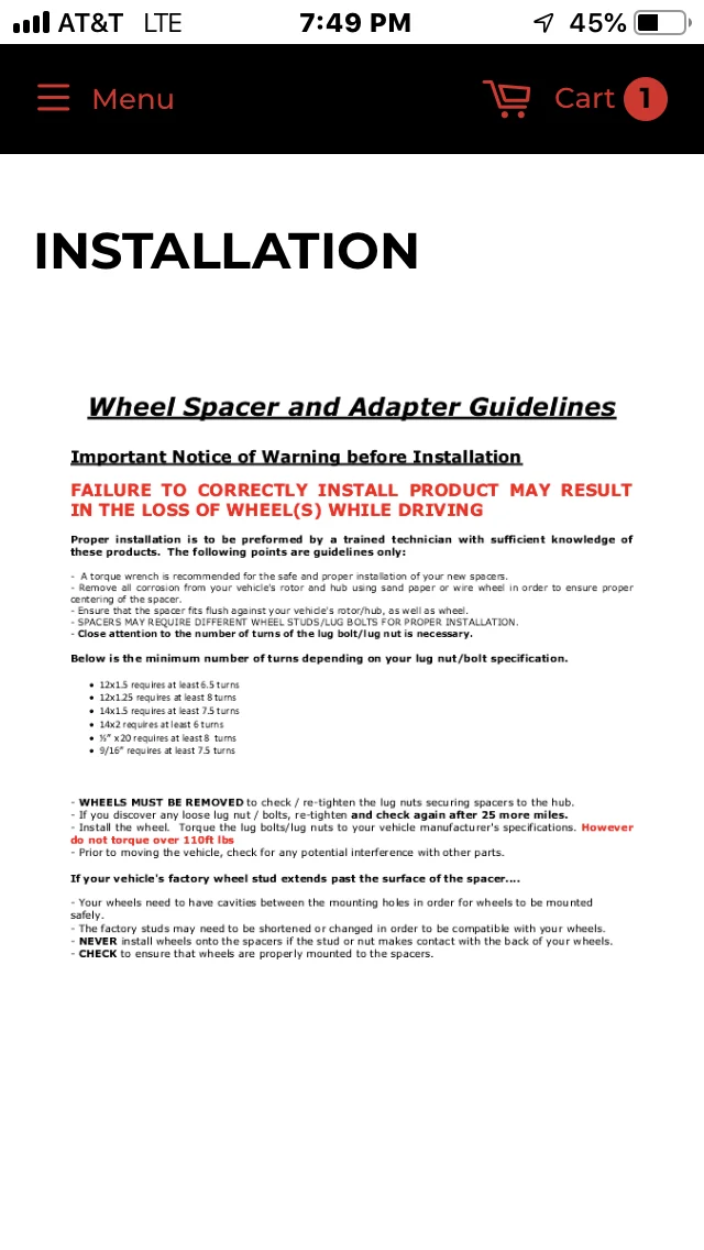

Thanks for the response. What confused me was your reference to "jeep specs."
The specifications posted appear to be from a spacer/adapter manufacturer rather than a specification published by Jeep/Chrylser.
Oh sorry. My fault. This is the spec from Titan, a spacer manufacturer.
3 studs on each side only had about 2 or 3 turns of the lug nut
