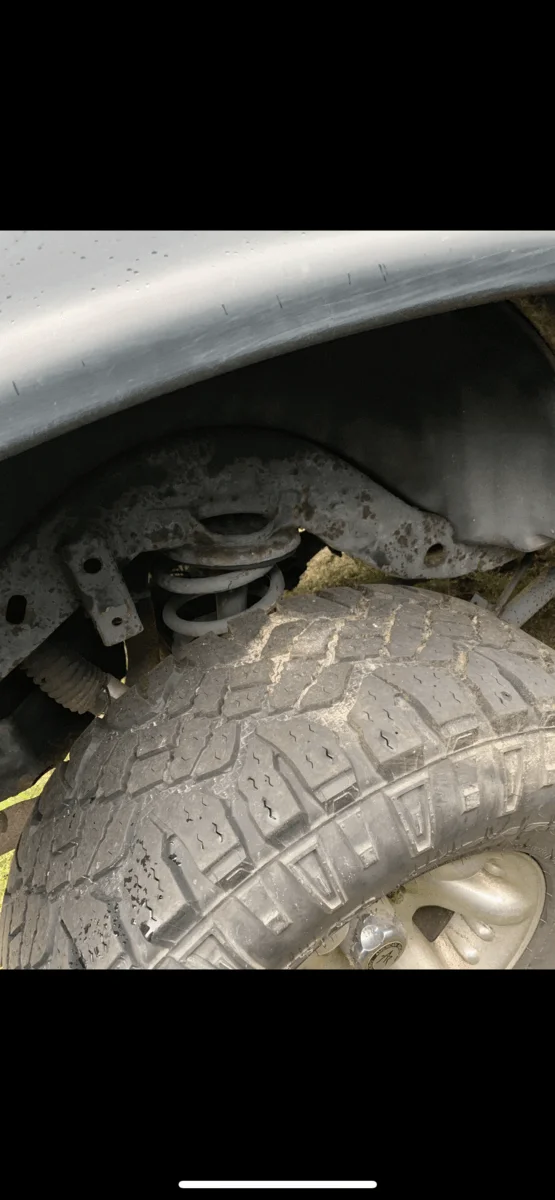

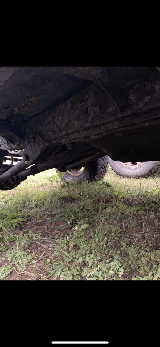

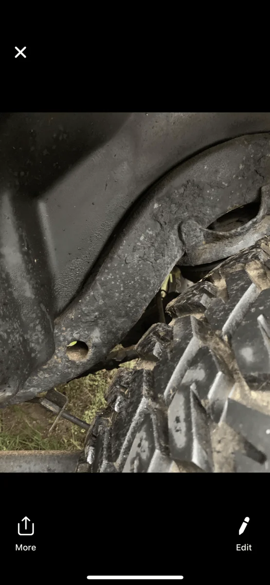

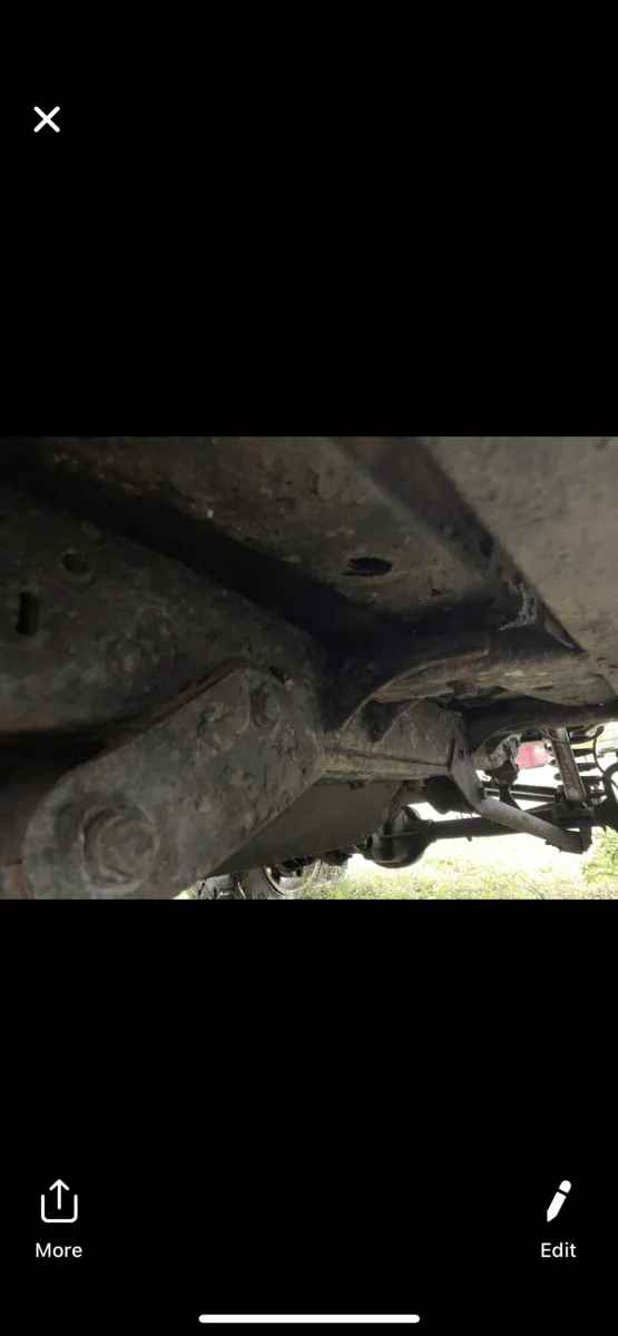

Hello, I am new to the forum, but I already own a 1997 Jeep Wrangler TJ. With that said, I am looking at another pretty far away, and received these pictures of the frame. I am aware that frame rust is a big problem with Jeep TJ's, but am not the best at determining what is bad/needs a frame swap, or what needs just the surface rust removed from pictures. How bad is this frame, like could I scrape the rust off and add some paint, or would it need weld in pieces/swap? TIA
That body and frame will need a significant amount of work, but it is salvageable, depending on how much effort you really want to put in it. That will likely require a body off restoration if you want it to last more than a couple years. Expect to put hundreds of hours and a couple thousand dollars at a minimum. It will need to be stripped, sanded, maybe welded, and recoated. Same goes with the underbody. That torque box is showing signs of rust as well.
However, you won't really know how bad it is until you take a hammer and screwdriver and try to poke holes.
Personally I would pass. Not worth the trouble. You'd make much more money parting it out versus fixing it and selling it.
If I owned it, I would frame swap it.
I'm going to say this once and only once: STAY AWAY FROM THAT THING!
What you see there is serious frame rot that has been spray painted over, and the paint is starting to come off in some places. Run!!!!!
