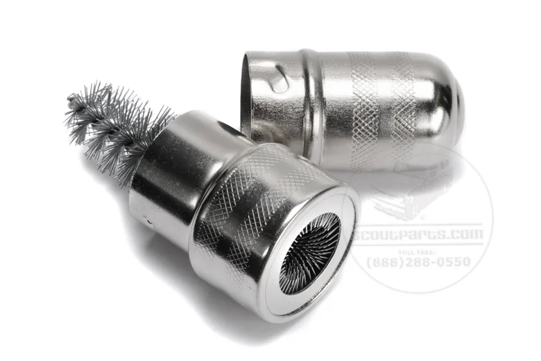

Remove (!!!) both battery connectors. Then use a wire battery brush to get the battery posts and inside of the connectors bright and shiny clean. Reconnect them and tighten the nut tightly enough so the connectors cannot be moved around on the battery post with even significant hand pressure.
Even if a battery post and connector looks ok it can still not have a good-enough connection to the battery post. It can be dirty/loose/corroded which is not always discernable by just looking at it.
No guarantees but your issue is commonly caused by a bad battery connection.
This is a good type of wire battery brush, it has male and female pieces to clean both the posts and connectors.

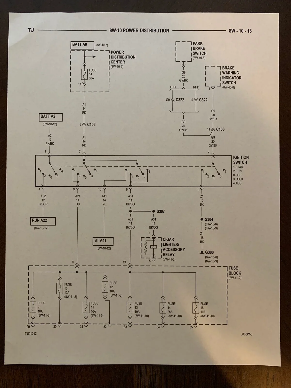

That problem sounds like either the ignition switch or the transfer bar between the key tumbler mechanism and the ignition switch.
The ignition switch has Run and Start contacts inside which power up numerous circuits in the Jeep.
The forum has a TJ Resources section that has PDFs of the FSM for your year TJ where you can search thru section 8W-13 for the ignition switch wiring harness.
