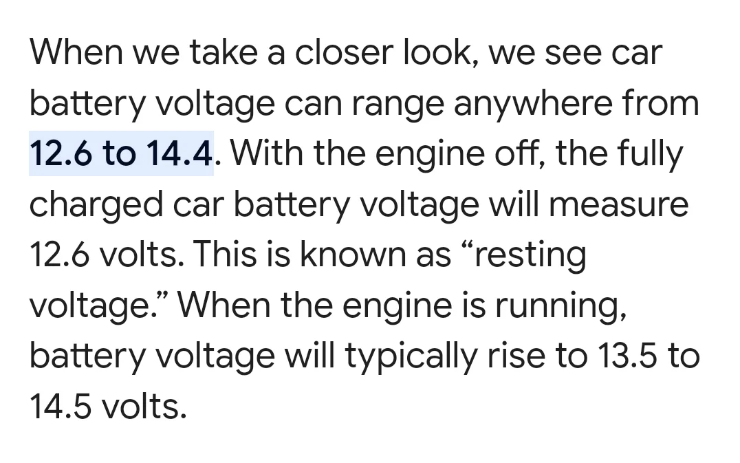

12v isn’t enough. Sounds like your alternator is going tits up. Or your battery.
It's at 12.49
