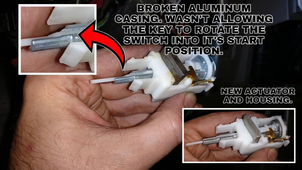

Unless you removed the ignition actuator and verified the tip is not broken, that's my internet diagnosis guess.

I tried starting it with the ignition switch removed with a screw driver and it still wouldn't turn over.
