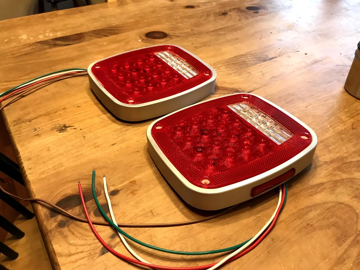

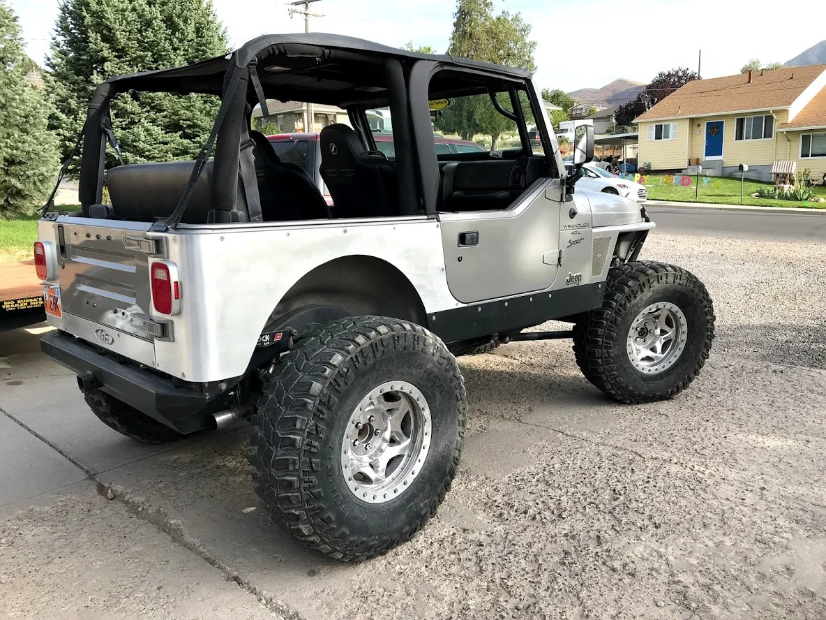

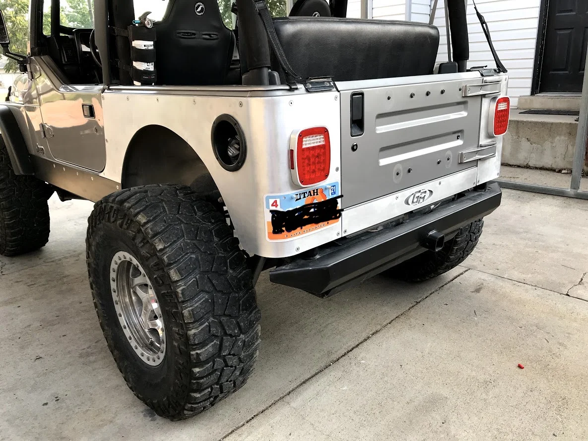

The tail lights arrived, although 2 days late. FedEx dropped the ball twice in back-to-back days in delivering them. I contacted the sales rep I used to work with when I was shipping manager, and he helped get things straightened out. At any rate, these things are a work of art, attention to detail is top-notch. I debated between the black anodized and the raw aluminum housings. Savvy claims that the "Mil-Spec" anodizing doesn't fade. While that was a concern, it came down to availability. The black housings were on backorder, so raw it was. I actually like the look with the aluminum corners. I feel that they compliment each other well.

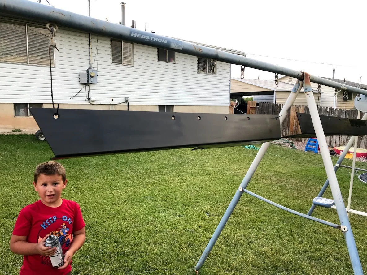

The sliders came in right on time last Monday. That evening I test fit them and marked where the holes would need to be drilled in the body and then took them to be sandblasted at IPA sand blasting in Provo. He is quick and does the blasting for a decent price. I've had him do axle housings, control arms, bumpers, etc. He is usually same day if you can get it to him early enough in the morning. While there when he was doing my axles, he explained that the guys from Bitchin' Rides have brought stuff to him to be blasted. Kinda cool.
After I got them home I hung them in my paint area for 4ish coats of Steel-It.
Installing the lights went straightforward. I wired them while watching Dennis @ Teraflex flop Slimer on Hanging Tree one night after work. When it came time for install, it was just a matter of plugging them in and checking that they were working properly. I did have to get an LED compatible flasher relay. Superbright LED's said that the 01-06 TJ flasher would work with a 2000 TJ, THEY WERE WRONG. The 01+ flasher is a 5 pin unit, and the older TJ's are 4. I did some research online and found the correct one needed. Fortunately O'Reilly's had one in stock so I grabbed it and installed it.
The sliders initially installed easily. Barnes 4wd explained that there was no modification to body mounts for the sliders to be installed, but when I went to install the 4 rearward body mounts the gaps were so large that I couldn't even start the bolts. I ended up cutting my body mount spacers where the sliders installed .5" shorter to account for the additional height provided by the sliders. Ideally I would have used a band saw, but all I had immediately available was a c-clamp to hold the puck and a 4.5" angle grinder with a cutoff wheel. Not ideal, but I made it work. Once the body mounts were cut, and cleaned up with a flap disc, install went quickly.

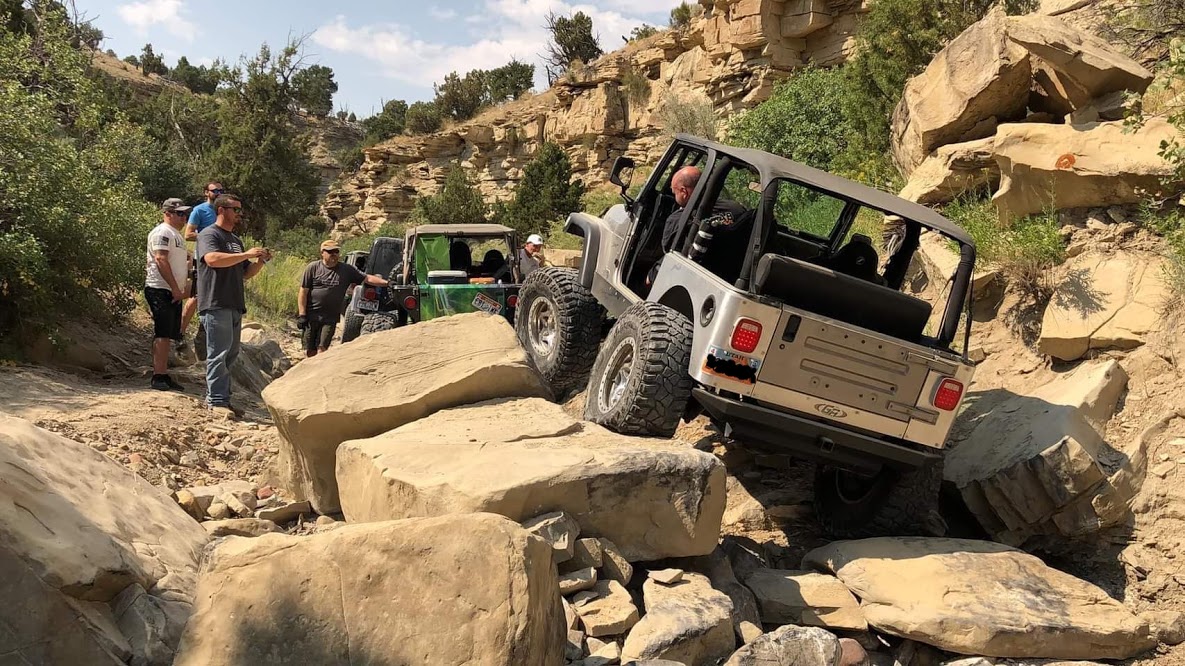

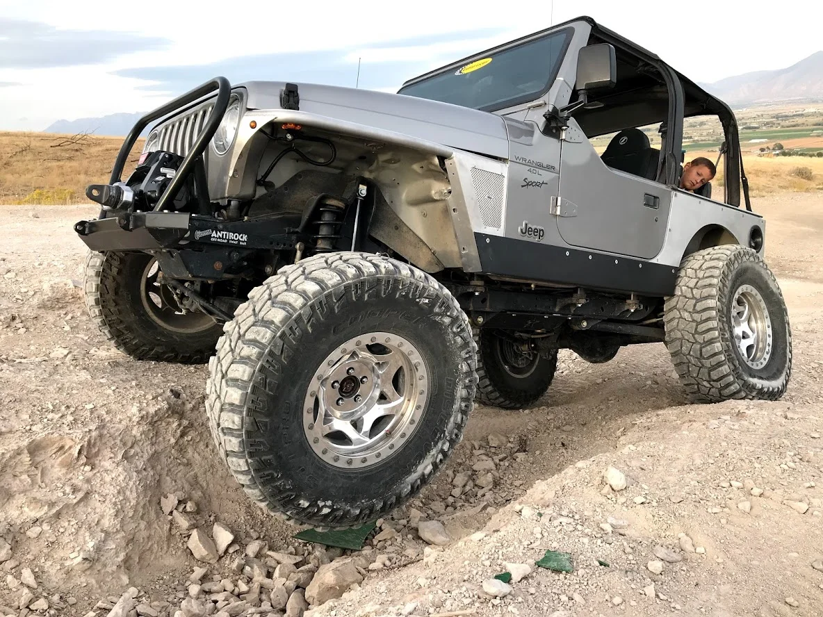

Yesterday I drove down to Price, UT to run Pinnacle 1. I already made good use of the new sliders. Everything seems to be working well.

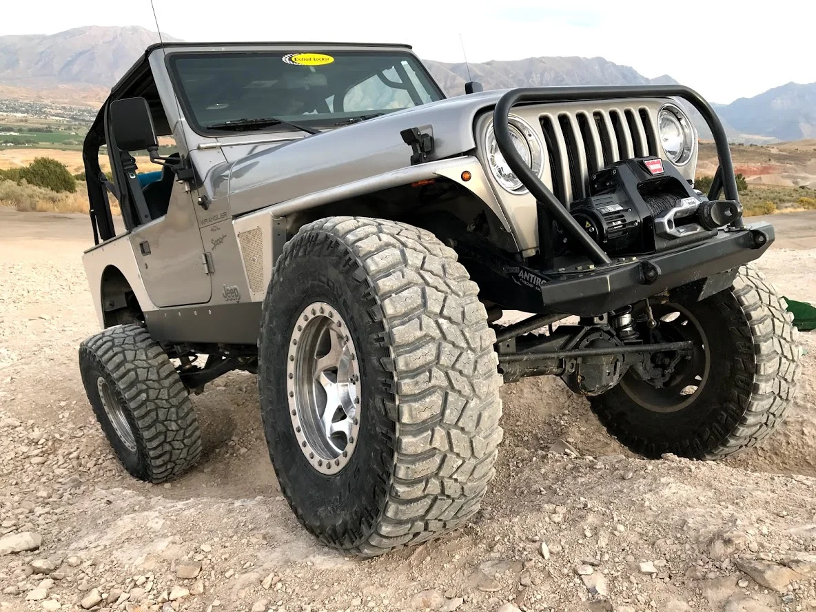

Thanks! I'm digging the 37's. The bumper is a Teraflex unit, though I sanded off the name stamped into the material. I don't have the best relationship with Tera, so away went their logo on the bumper.
Hahah can’t say I blame you. Not a Teraflex fan myself. But the bumper is sharp! Simple and low profile. Any plans of going to the upcoming trail hero?
The bumper is awesome, and was the right price. Got it for a smooth $50 off of KSL. I ground the logo out, sandblasted it and painted it. Looks new again.

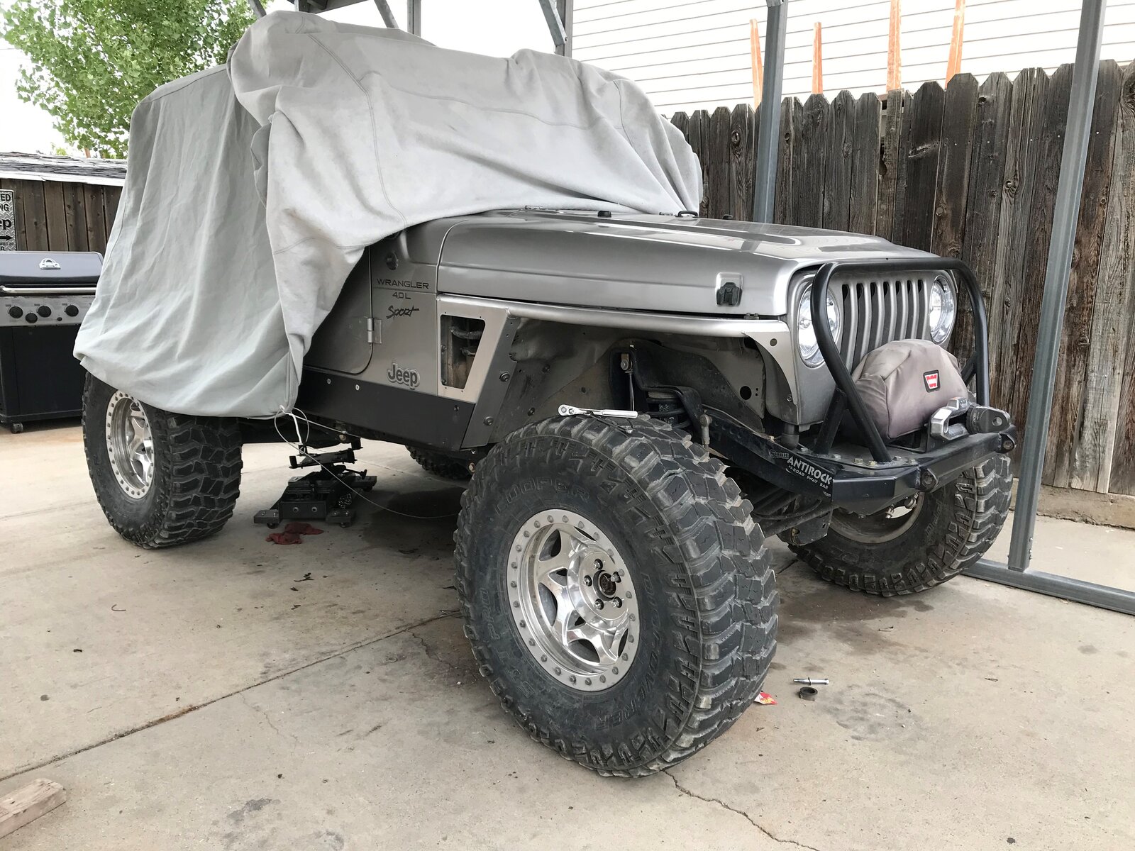

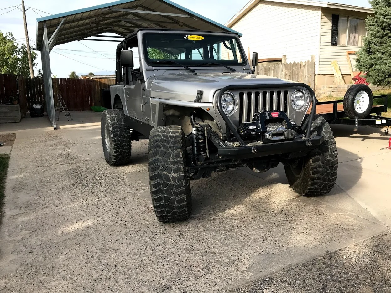

Well, it bugged me that I had rear aluminum corners and stock front fenders, so I talked my wife into letting me get front tube fenders. Wanting to stay consistent with the aluminum theme, it narrowed my options quite a bit. Just a few years ago, several companies were in the market of TJ aluminum armor. Some included JCR, Metalcloak, GenRight, Poison Spyder, and Artec. Fast forward to today, I was only able to find 4 that still make aluminum armor. I settled on GenRight aluminum fenders.
I initially was drawn toward the zero flare fenders, until I came across the Boulder Fenders. I immediately loved the look of them. Ultimately I went with the standard height due to the complexity and additional cost of getting all the underhood goodies to be relocated, and working properly.
Even with maintaining the standard height flare I anticipate to still get an additional 2-3" of uptravel because of how low the stock fender flares hung, and the fact that these fenders are significantly narrower than stock.

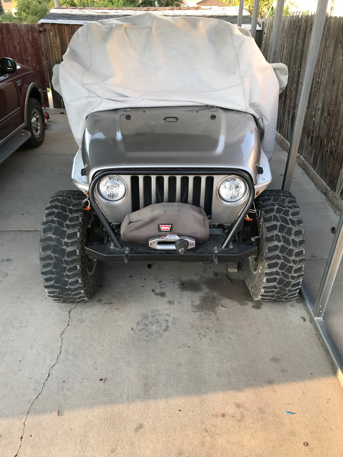

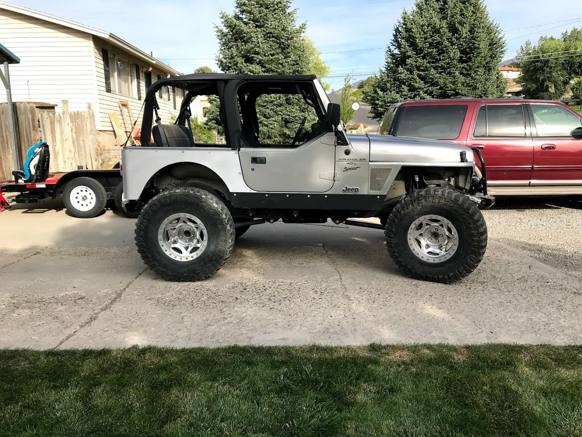

Please post some photos of the entire Jeep. I’ve been contemplating these fenders. I’d be nice to see the Jeep as a whole.
Buttoned up everything over the weekend, and took it out to my local test area. Love how it turned out. Looks like I can adjust my bumpstops some, hoping to get an extra inch or two of uptravel.

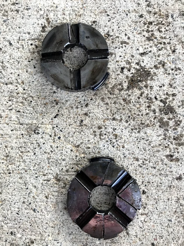

On the return trip, I turned the corner return home, and the front end jerked, and made a loud bang. With it having a Detroit in the front, it isn't uncommon to have situations where the locker does make a little bit of noise, but nothing of this level and something that would actually shake the steering wheel. Figuring I would check before heading out on our trip this week, I pulled the diff cover off just to be sure all was well.... which it wasn't. I opened the front diff cover and immediately saw a cracked ring gear tooth.
Not anticipating any further damage, I ran in the house and threw together a Hail Mary, ordering parts and working with friends who have installed R&P in the past. After getting it all ordered, I began to further tear down the differential to find out that one of the bolts that holds the Detroit Locker together had snapped, and is what ultimately led to the failure. I found the head of the bolt sheared in half in the bottom of the differential housing. At that point I accepted defeat, knowing that it would be more money that it was worth to rebuild it, anticipating down the road it likely would grenade itself again with me recently
