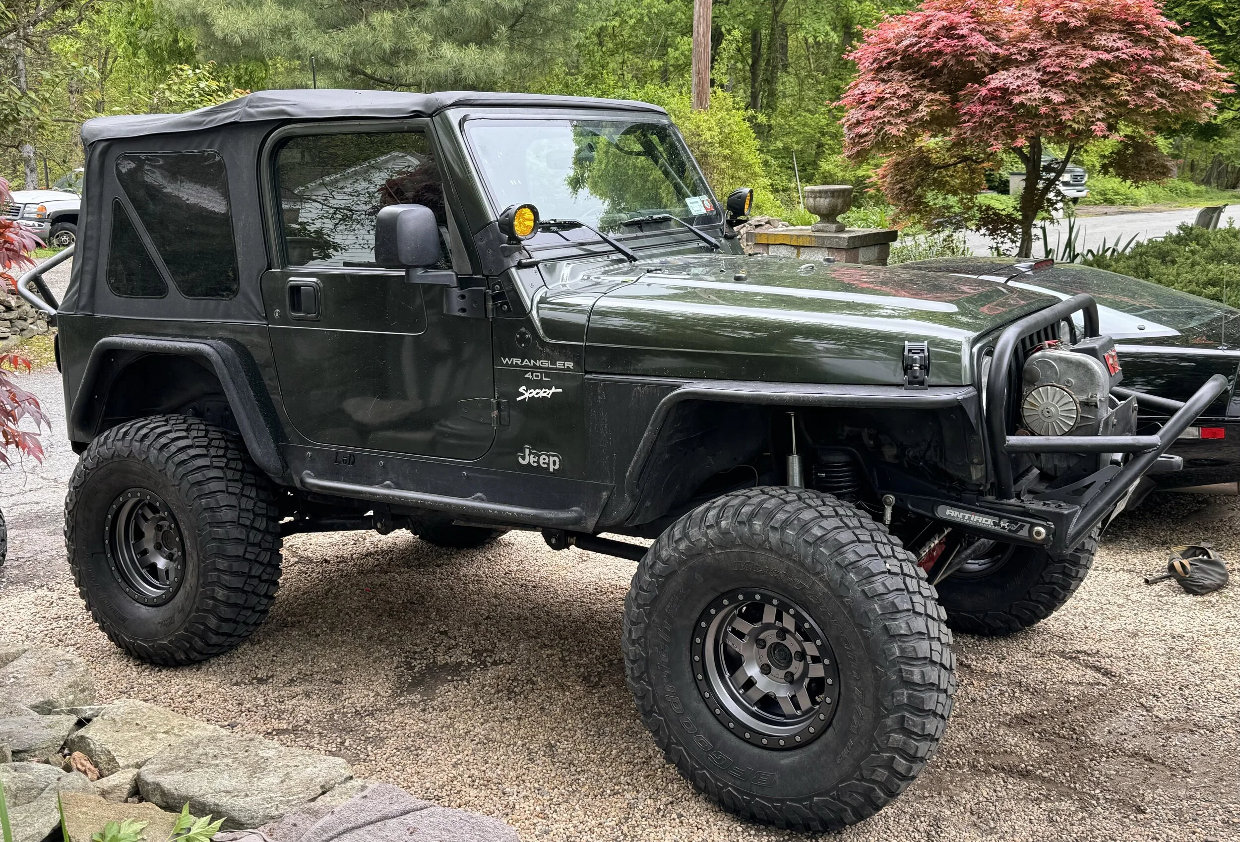

Been meaning to throw together a rough build page for the past couple months now, mainly to keep track of what I have done to the tj in the past 7 or so years I have owned it. Will add to this as I remember everything done.

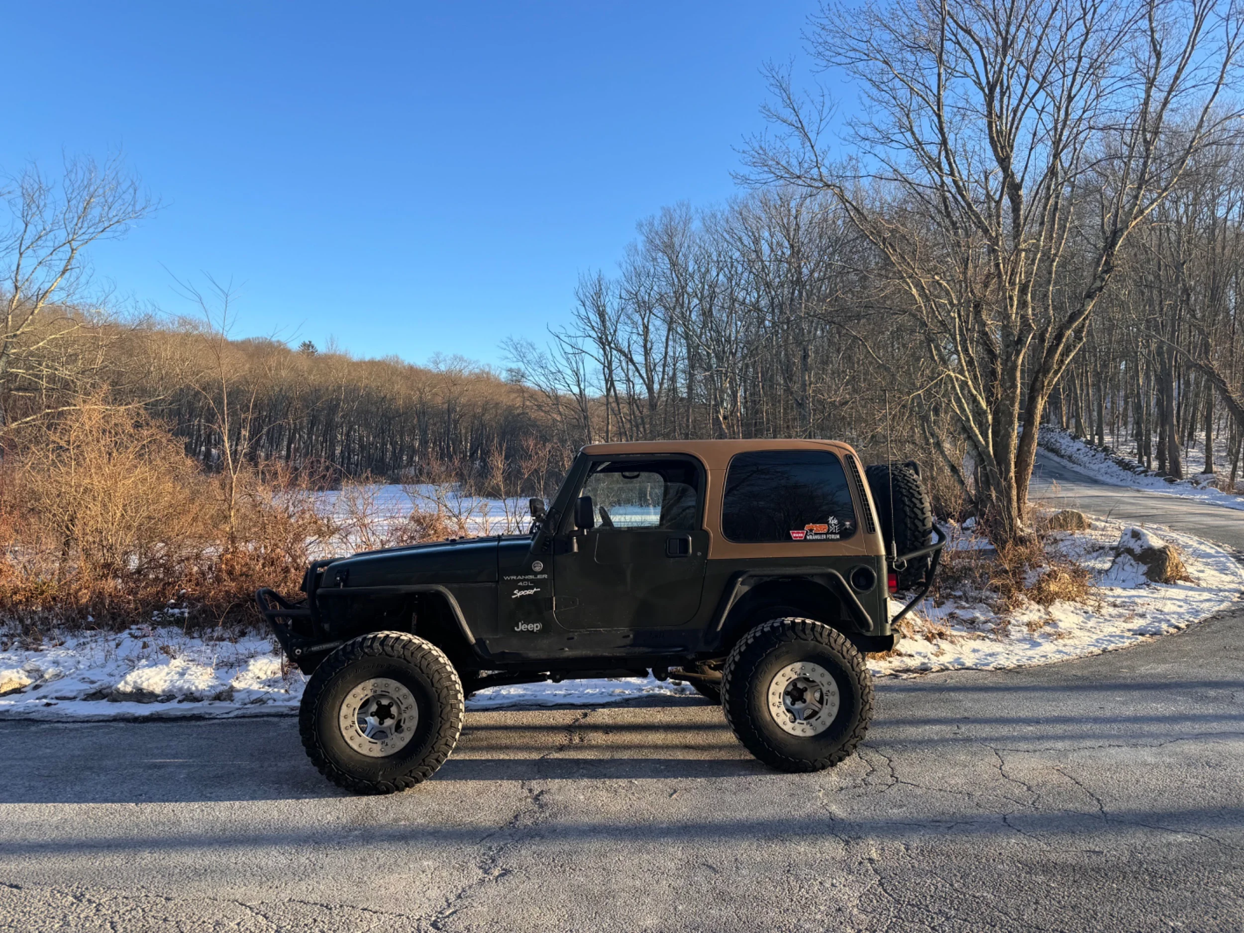

1998 Tj Sport with the 4.0 and the Ax-15. Has 170,000 ish miles on it now. Motor swapped around 130k due to some high water in New Hampshire.

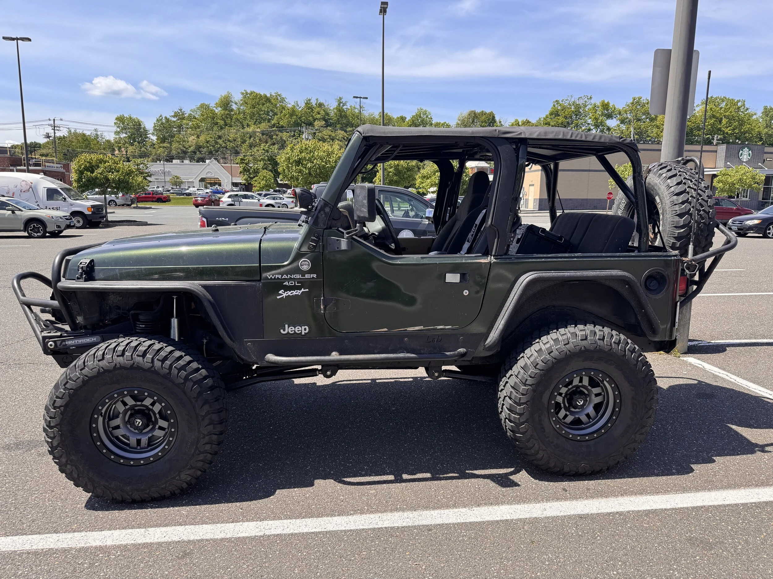

-Rustys high clearance long arm kit, front end turned into a 3 link with barnes brackets
-Dana 30/Dana 44 regard to 4.56 with a Detroit locker in the front and a Yukon zip locker in the rear. Front is sleeved and trussed. Rear has G2 Chromo Shafts.
-Currie Correctlync Steering and a rough country track bar in the front, JKS in the rear.
-Currie Anti Rock up front
-Adams driveshafts front and rear, Rugged ridge SYE on the T case
-Skyjacker 4" dual rate springs with JK bilstien 5100's
-CCFabs DIY fender kit front/ Rear

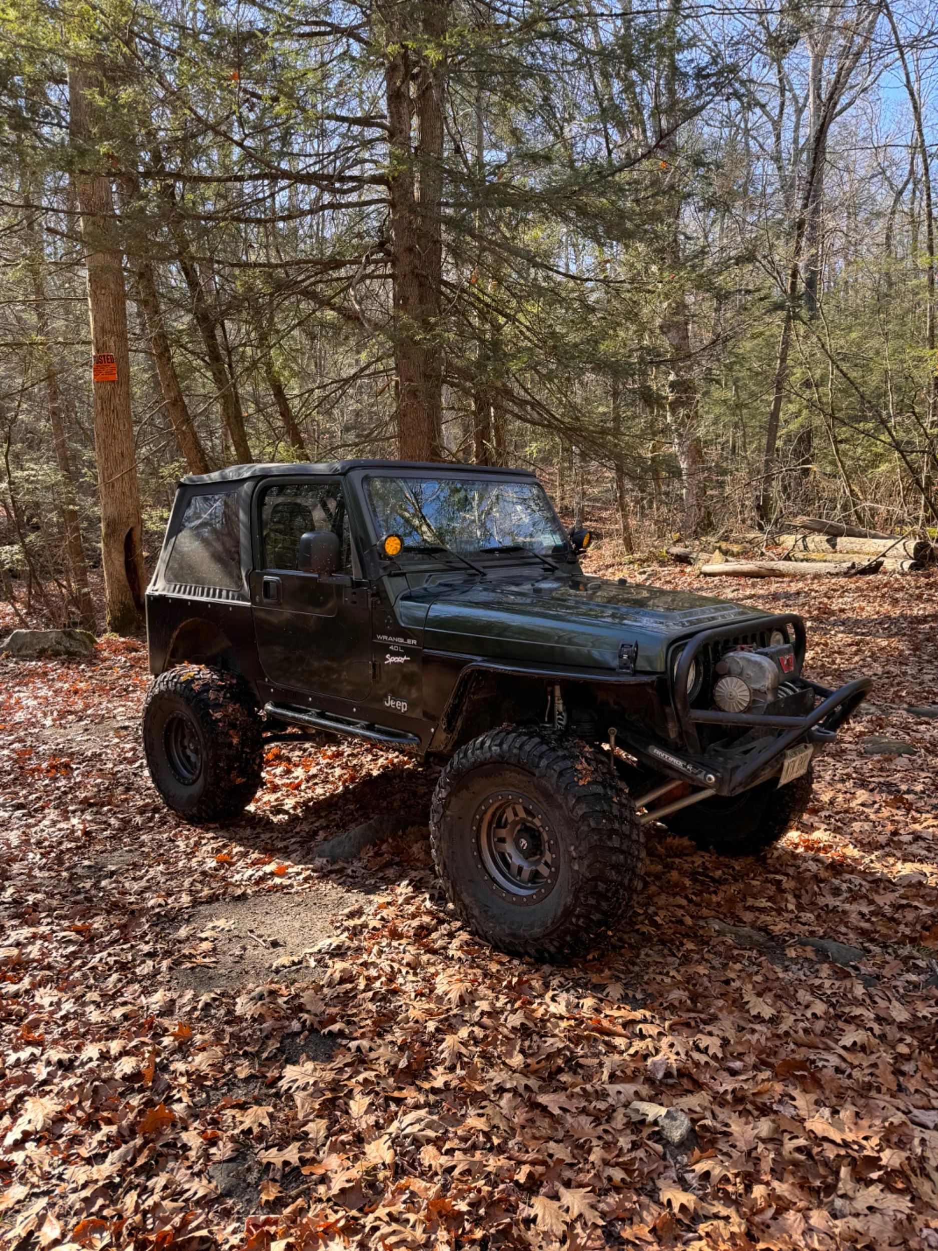

-Motobilt stubby with an added grill hoop
-Warn 8274 with a homemade winch plate

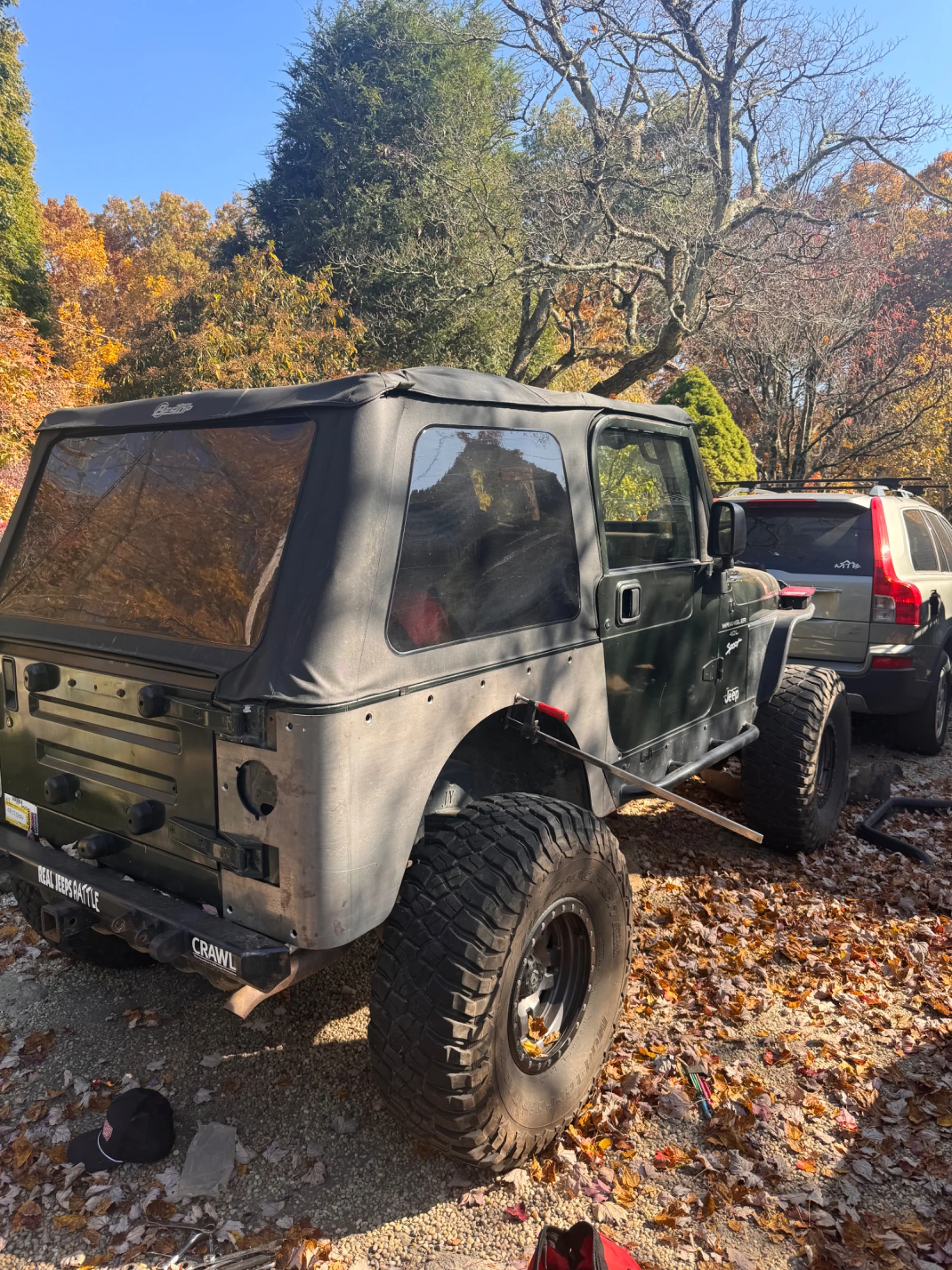

-Homemade drop down tire carrier similar to the poison Spyder
-35" BF Goodrich KM3's on some Fuel Anza 15x8 wheels
-Homemade Cage tied into the sport cage

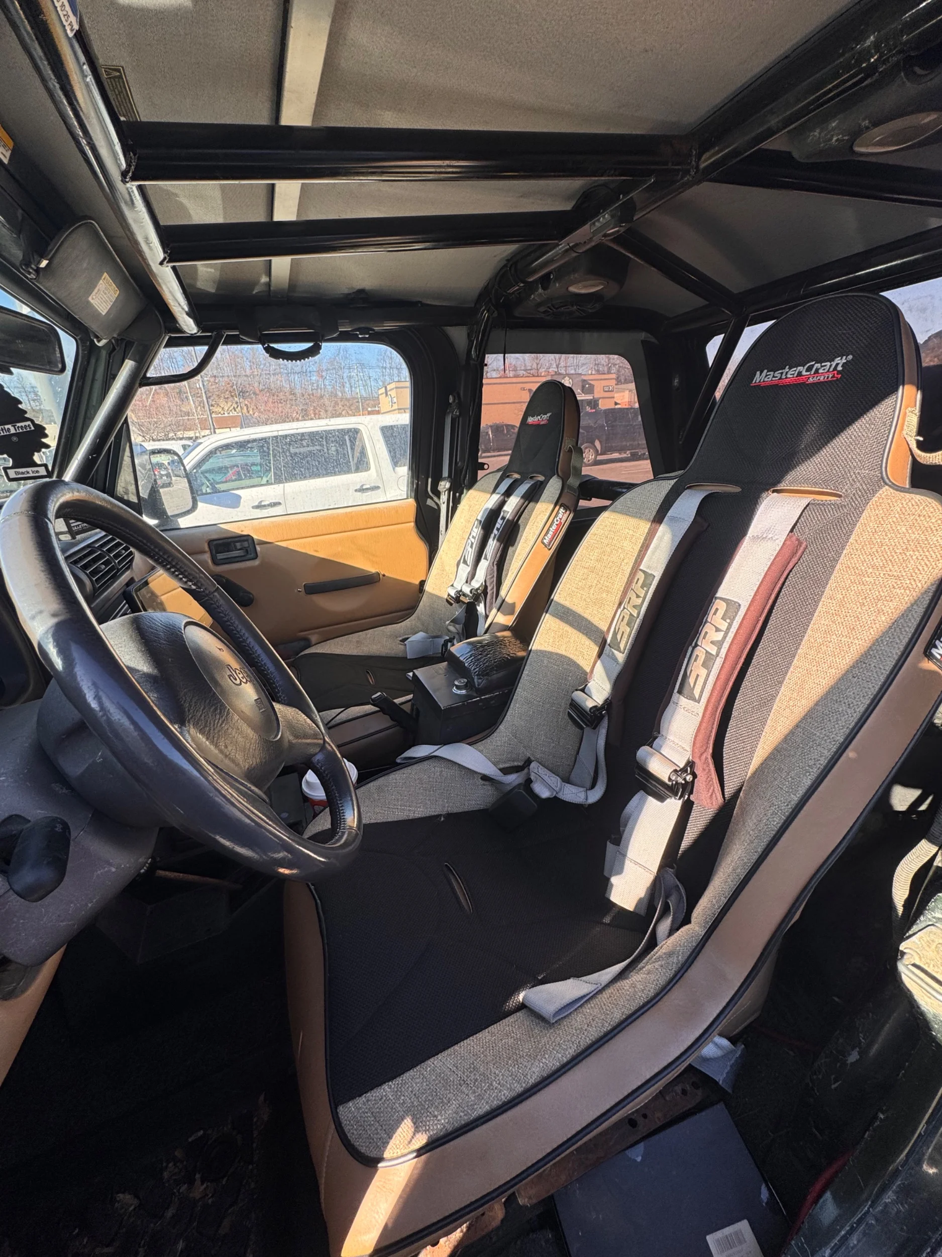

-PRP enduro reclining seats with PRP 4 point harness and rock hard harness bar
-Bestop Trektop NX Soft top
It's the typical northeast Tj, so it has been patched and has its fair share of dents and scratches. I would not hesitate however to hop in it and roadtrip it just about anywhere.
