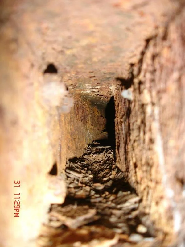

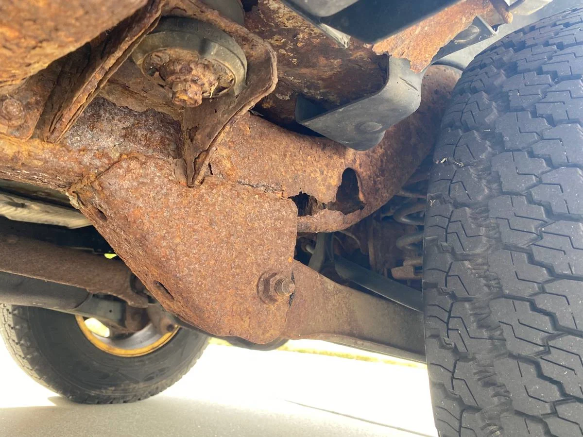

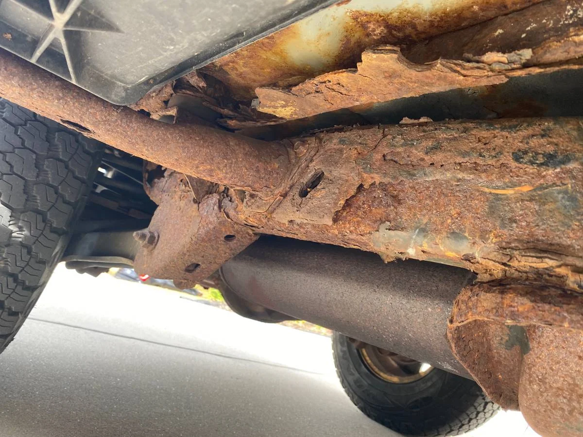

You can tell that the inside of the frame is flaking and rusting just from the pics. It's a tough situation, very common in my area. Each person is going to have their own opinions and how many years it has or doesn't have left is purely a matter of speculation. Don't be surprised at the number of local people that will reject it out of hand, then proceed to drag their own vehicles through the salt and mud without proper care or maintenance.
Dollars, condition, and location. If the ask was $100K his great grandchildren will still be trying to sell it. If the ask was $10 it would have sold in seconds.
It doesn’t look that bad to me, and I’m restoring an Ohio Jeep that definitely looked worse from what I can tell. I think people are holding their money.
rusty frames don’t scare me.

In Ohio, have done a frame swap, I would be skeptical that frame doesn't need patched/replaced.

Having looked at a ton of NE jeeps over the years, I'll agree there is likely some internal rust and flaking, especially given the absence of drain holes. But speaking relatively, that frame is one of the better ones I've seen (at least from pictures). I wouldn't call it 'toast' by NE standards.. We don't see too many of the pristine frames some of you do. It's just the cost of doing business.

That frame is toast, and any frame that needs safetycaps is still toast. Torque boxes at body mounts look like they’re hiding some nice surprises as well. GLWS at that price point.
Frame and torque boxes are a mess. Regardless of what folks "will" accecpt, that does not make them acceptable. Any frame that has caps and repair pieces that were used to replace rotted out sections is crap and an absolute deal breaker. Throw in those torque boxes and I wouldn't take that rig for free.

I mean for free I wouldn’t be scared to make it work…. Wrecked rust free tubs are out there, depends how much work you want to do.
