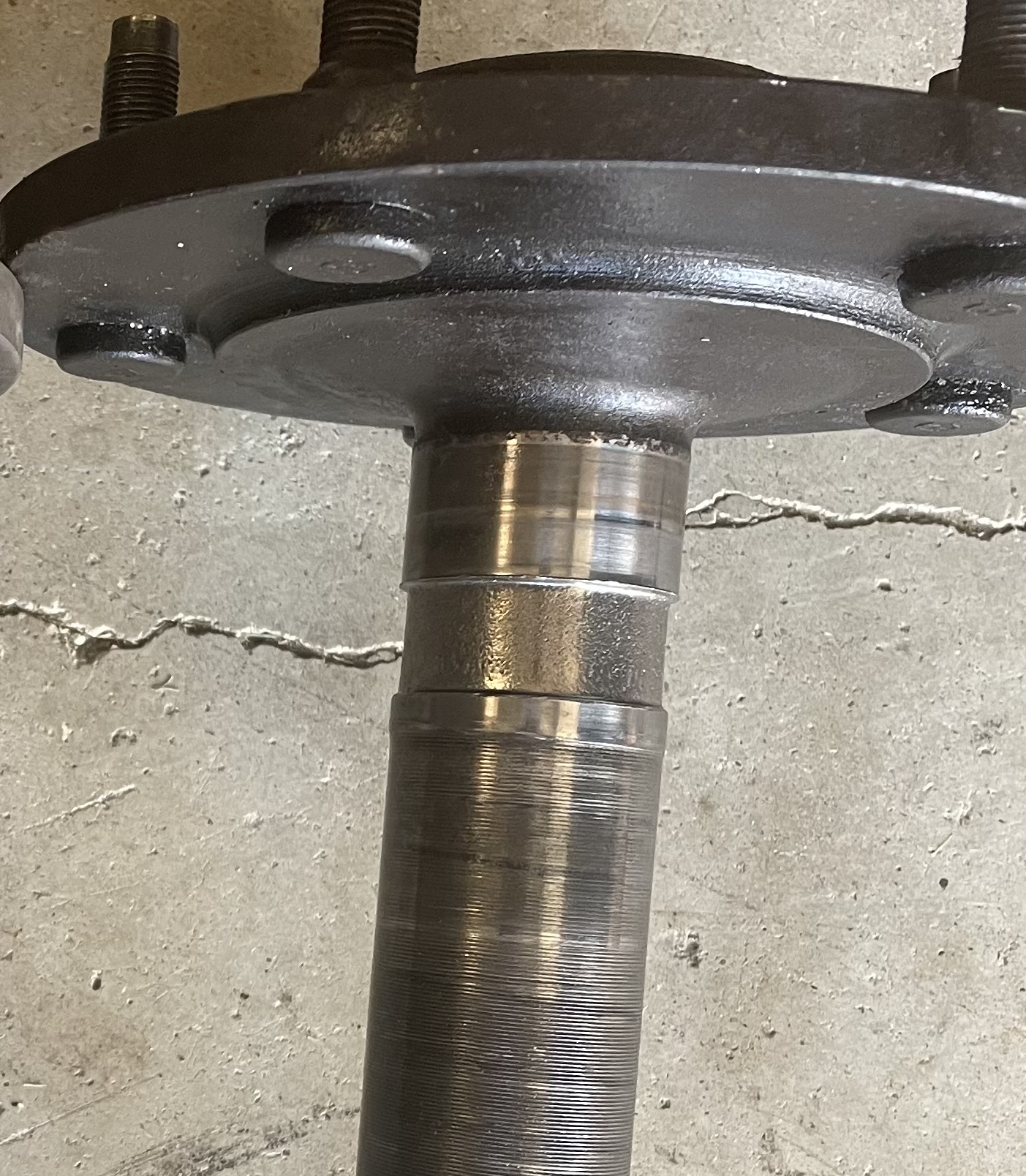

Well, I noticed that my rear axle bearing seal was letting fluid by. Of course it had to happen while I was on my way to camp towing my little trailer and all my gear. I checked the diff fluid, topped it up - it was only a few ounces shy of full. After the weekend I drove it home.
Finally got it apart today and man.... what a mess. As soon as i pulled the diff cover and saw all the glitter I knew it might be a bad day. I gave the pinion gears a good look and no unusual wear. Got the tire off and had alot of vertical play in the axle. Slid the axle out and was greeted by a nice deep groove.
I am hoping that is where the glitter is from. Ordered an axle and will install tomorrow. Then I'll pull the otherside and see what that looks like.

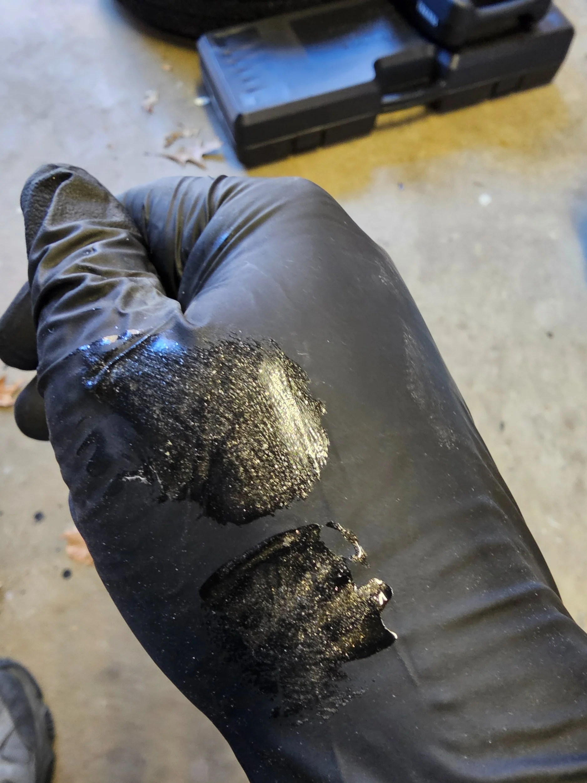

Do you have a magnetic fill plug on your diff cover?
No, I have this stupid rubber plug. I will stick my neodynium magnet on the outside of the diff cover after I put everything back together. I'll probably run a couple hundred miles and drain and refill again. The magnet should catch everything

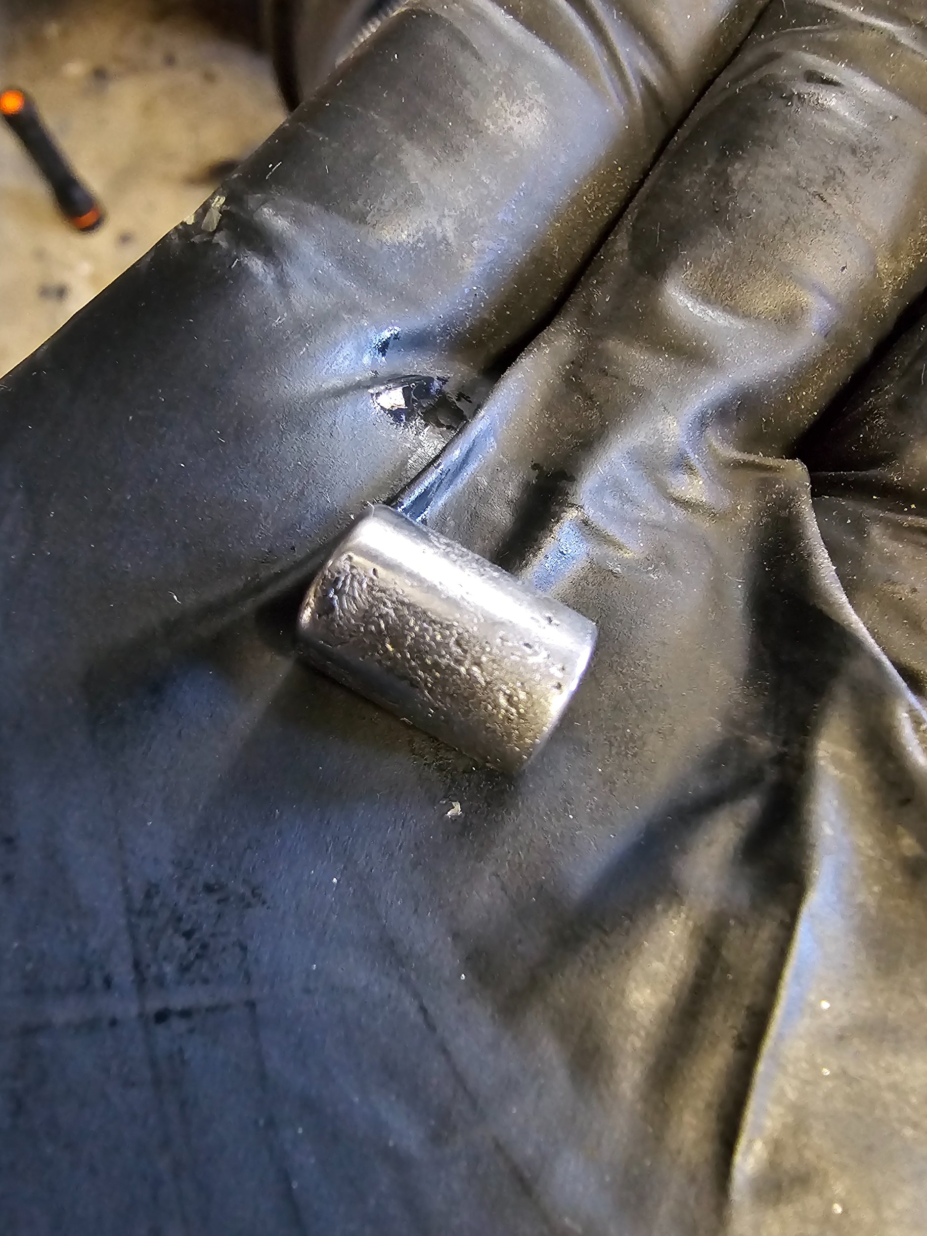

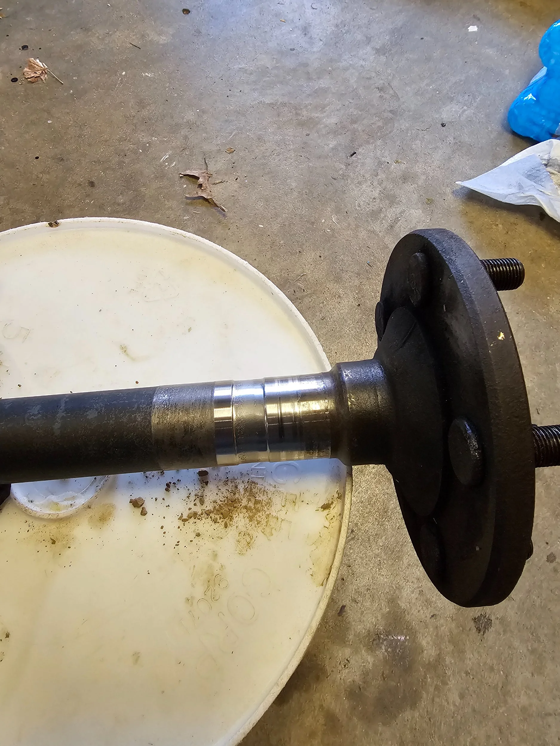

😱 lol we'll just call that a bearing race! If i didn't have a few extra bucks, I would have done the same thing. Luckily the axle isn't terrible and it is an easy fix since it is apart.
Its really not hard to pull the carrier to do a really good job cleaning the crap out of the tubes. If that one looks that spent Id do both axle bearings and seals and check the carrier bearings for damage from the metal.
