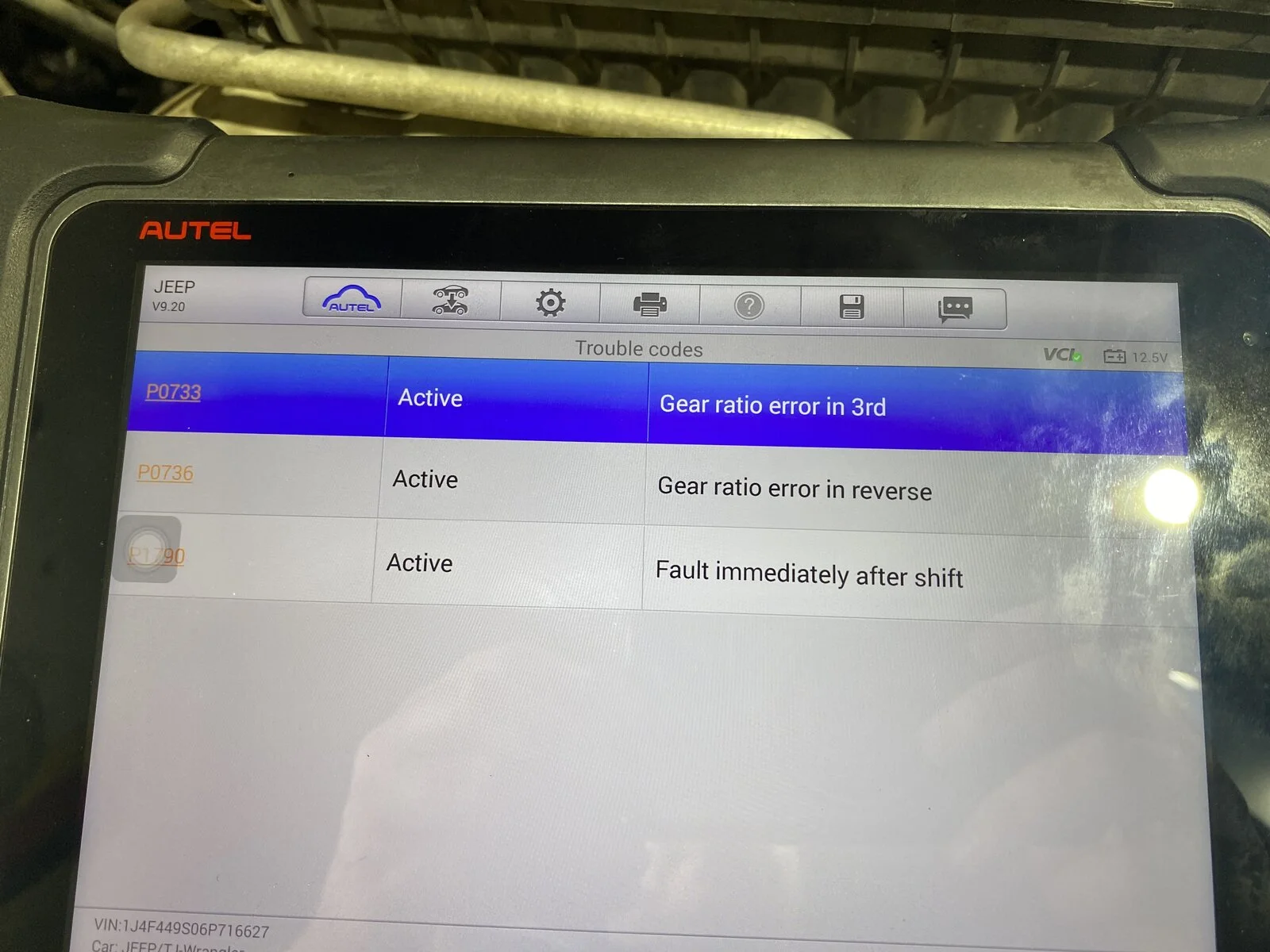

Took my Jeep on a very light off-road excursion today in some soft sugar sand. Right after engaging 4-Low I felt a couple weird shifts and then everything seemed normal.
Ran around maybe 20 minutes then pulled out to get back on the road. Went to reverse back a little and reverse engaged but was slipping so bad. You could tell the jeep wanted to move but couldn’t.
Drove it to my shop where I found I only had 1st and 2nd gears. Once there, on flat ground, I verified reverse was definitely engaging and would attempt to move the jeep, but just wasn’t grabbing hard enough and would slip.
So I check fluid level and condition in park on flat ground. Fluid looked clean and level was perfect.
Scanned the jeep and found the following faults.
P0733 Gear ratio error in 3rd.
P0736 Gear ratio error in Reverse.
P1790 Fault immediately after shift.
Cleared faults and found I still had no reverse. Did not attempt to drive any further to see if it would shift in 3rd or 4th after fault clear.
So anyone have some insight on these faults and issues?
If it’s rebuildable, I’m down. Just not sure what path to take for diagnosis.
Or am I going to need to start looking for a replacement?

Sounds like you blew a clutch and it took out either another clutch or clogged stuff up. It can probably be rebuilt, they replace most of that stuff in a full rebuild anyway. A good shop can read the clutch volume index if you really want to double check but it sounds like at least one clutch has failed. Once that happens all the internals get clogged and things go downhill fast as far as normal operation. It's almost certainly not the control module, it can't tell reverse to slip, that clutch doesn't feather or ever use partial engagement. If you want to rebuild it then stop driving it and have it towed or pull the transmission, if you are just using it as a core it doesn't matter. If you pull the pan you'll probably find a big mess.
It's always rebuildable. I mean, they built it in the first place, no reason to think it couldn't be done a second time. Just start a thread on it, I've never seen a 42RLE up close before.
