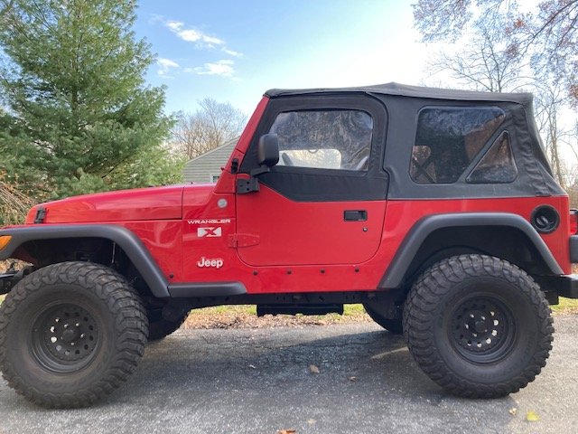

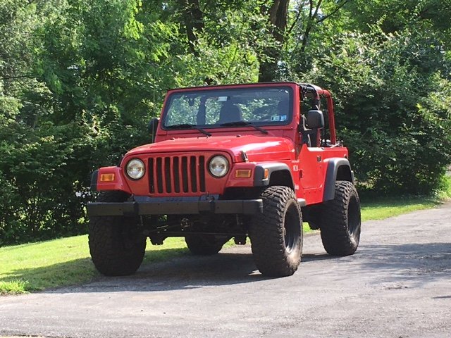

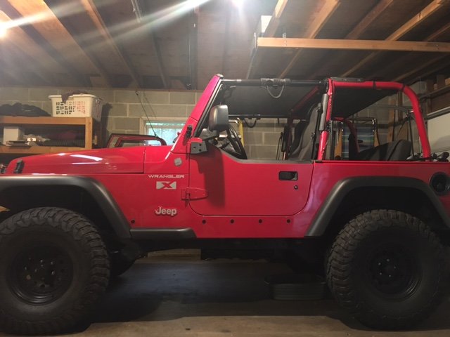

no need to 'chase' coil spring heights, if you indeed have old worn out RC springs it would be a good time to slap some new ones in, just get one inch taller in the front & you'll be fine; I did this with a set of Teraflex 3 inch front & 2 inch rear, perfectly level:

Factory rake is hideous

That looks great and I agree, the factory rake is no bueno. If you get a chance, do you mind giving me your front and rear bumper heights? Mine is currently 21.25” to bottom of rear bumper and 23” to bottom of front
