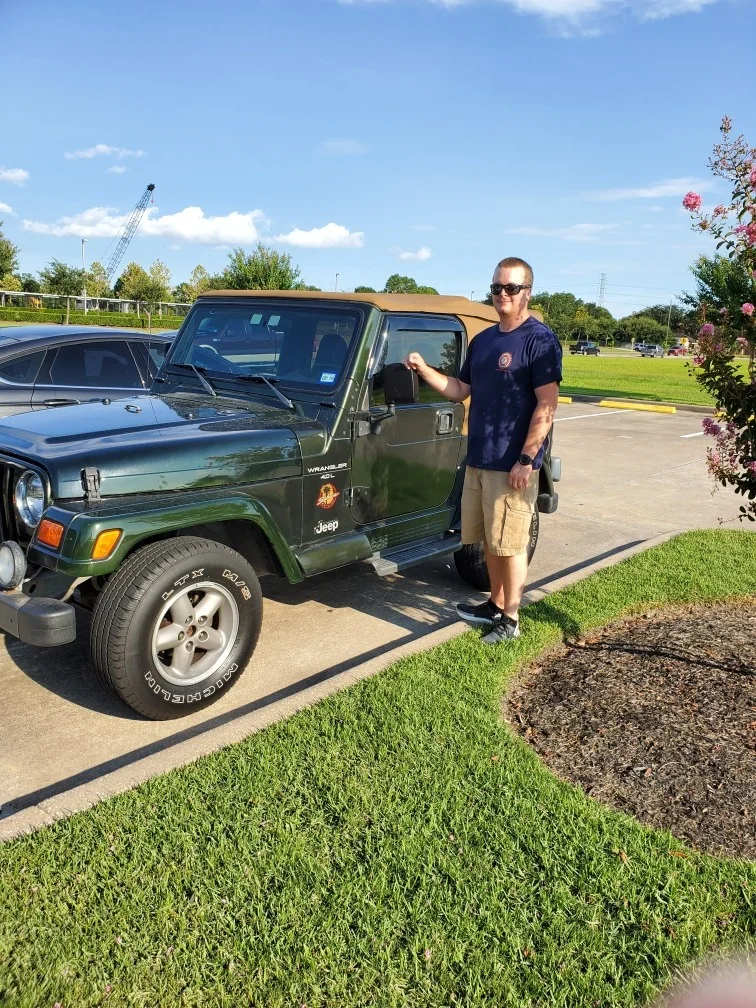

Hi all, I recently acquired a 98 Sahara. I just put on a new set of 30x9.5x15's BFG KO2's.. The whole Jeep is entirely stock. Tires are sitting on the factory "grizzly" rims. I'm looking for anyone that has similar size tires and a leveling kit installed? Any pictures?
Also the Jeep has 228k miles and I'm sure the stock coils are tired. I'm wondering if buying a new set of factory ones will pick it up a bit.
I'm not looking to lift the Jeep. Just a level.
Thanks!
At 228k the factory suspension is in need of replacing, both shocks and springs I would say. That being said, the correct way to do this would either be to put factory spec suspension back on (i.e. shocks and springs with no lift), or go with a mild lift kit, such as 1" or 2".
I'm not so sure "leveling kit" is a term that is used much in the TJ world. I see it used a lot in the JK crowd, but not much with TJs.
If you're looking to maintain the stock height, the best bet would be something like Moog coil springs and Rancho RS5000X shocks with 0" lift.
