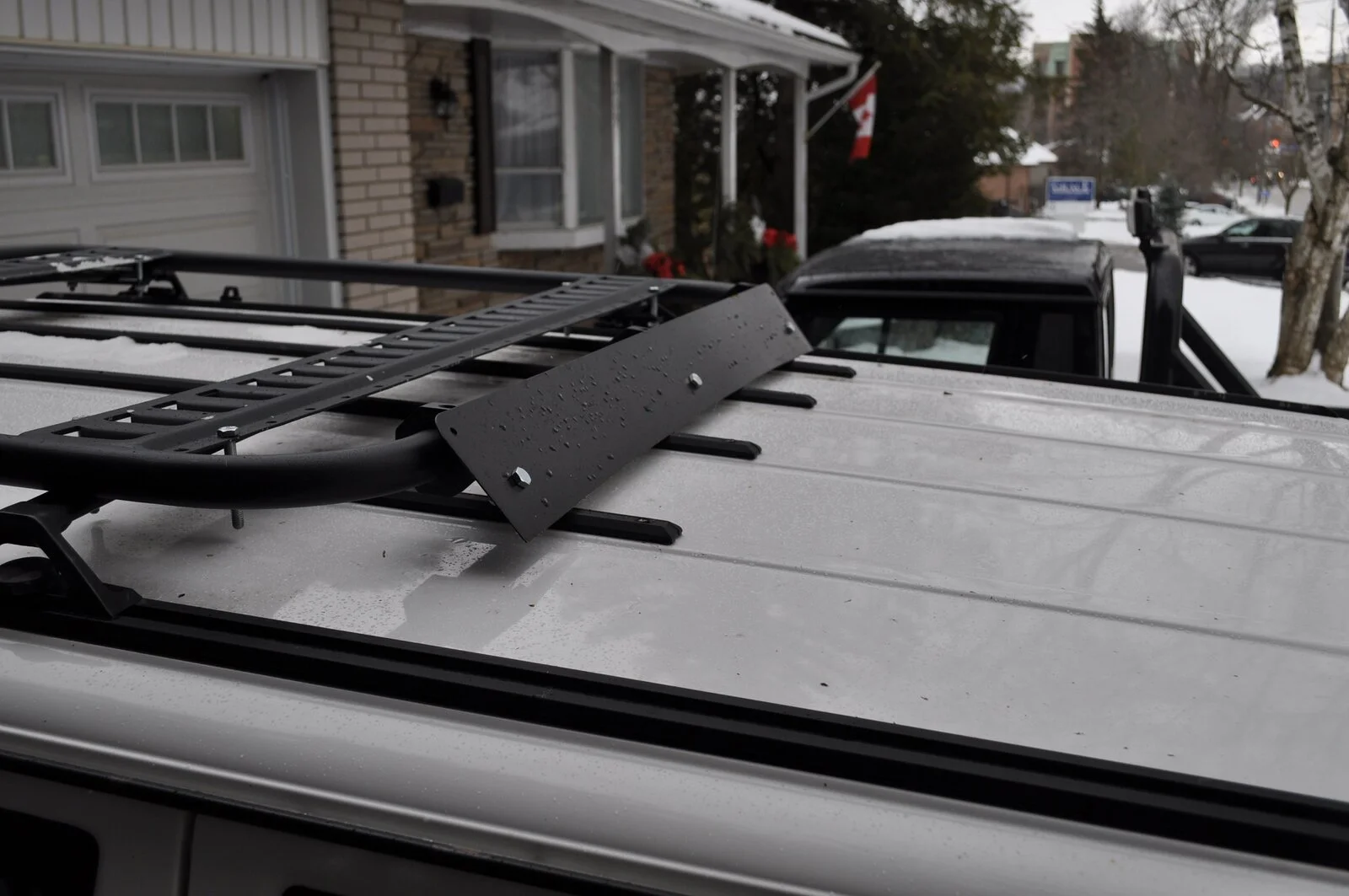

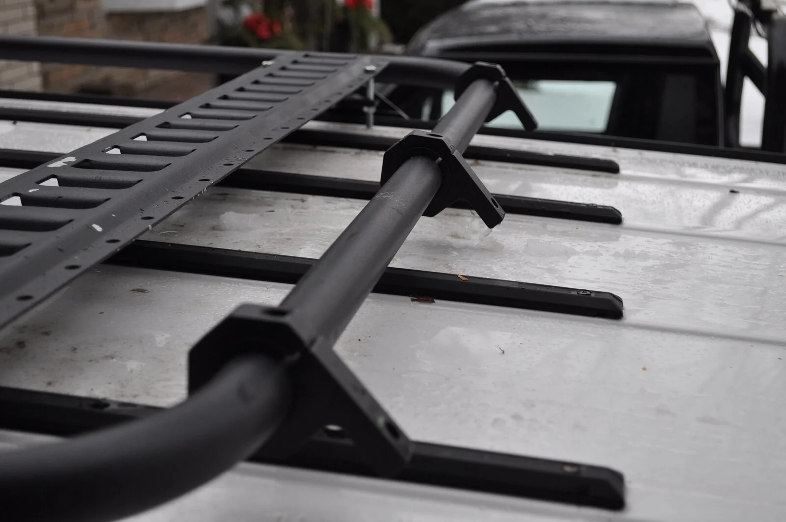

I just made a roof rack for my XJ and it "hummed" like I thought it might. I made a wind deflector for it and it solved the problem.
I'm in the process of making one for my LJ and will be using a light bar (no lights) for the front of it. Hopefully it won't be a problem but I'll do something similar if it does.
