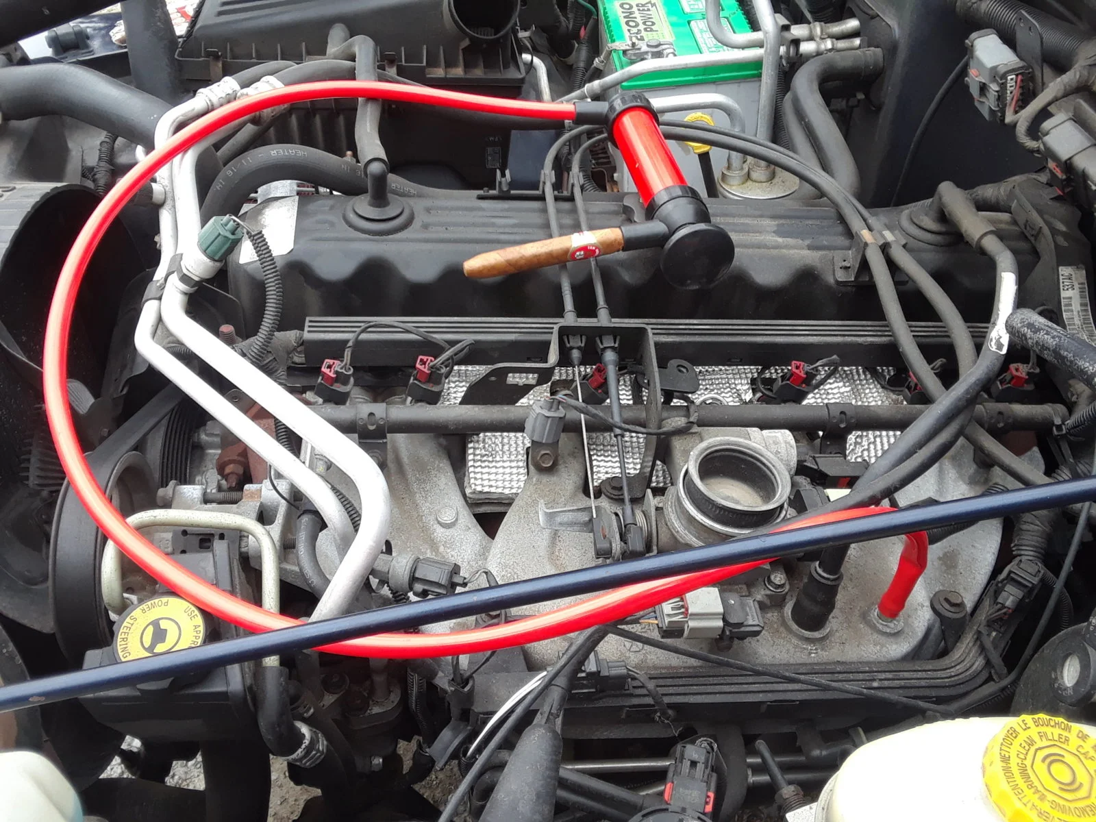

Try.this cheap vac tester...
It's a simple fluid transfer pump, $10 at Harbor Freight and a cigar.
With this set up you can do your own simple vac test.
Plug the tail pipe with a rag and plug the throttle body also. Works like a charm!
That’s awesome! I’m def gonna pick one of these up! I seen where a guy made one out of a paint can on YouTube. But it wasn’t Clint Eastwood approved haha! Thanks for the info!
