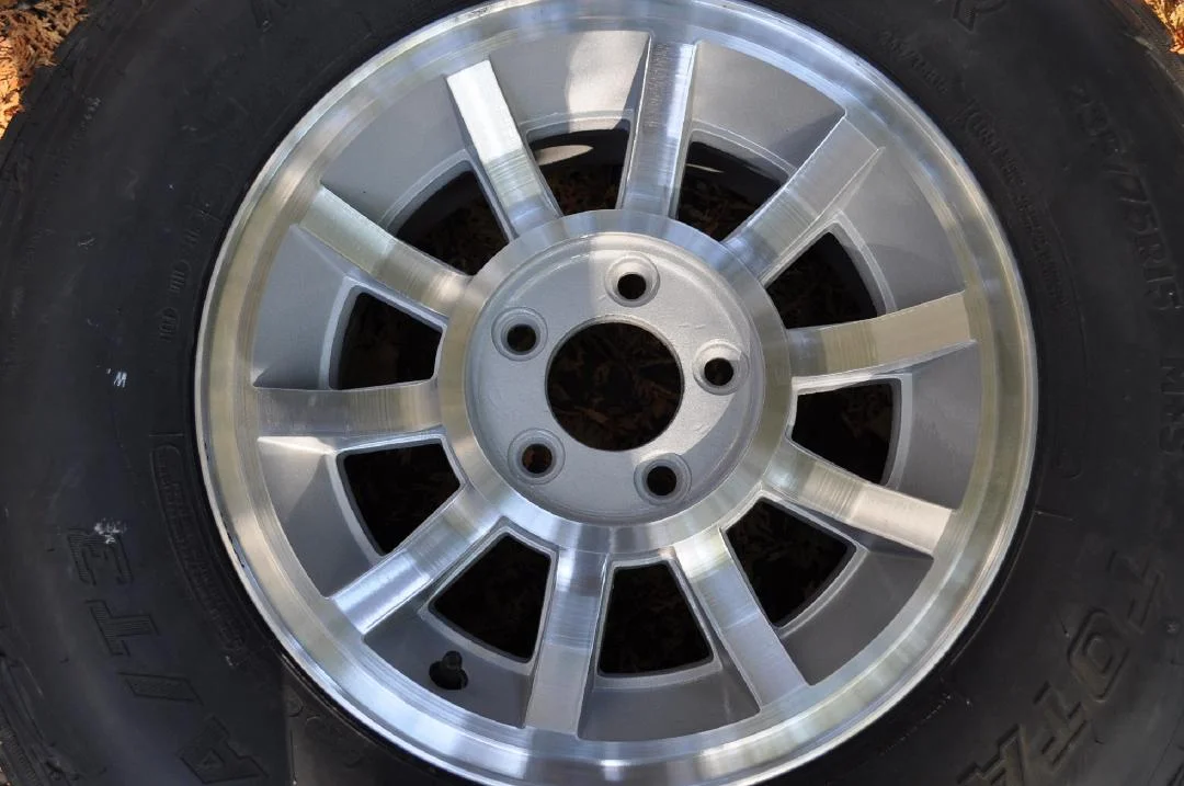

I did a pair of Jeep MOABs for my trailer a few years ago. I blasted them in my cabinet (not fun) and painted them with Duplicolor spray bombs. They have held up OK but not great which is no surprise. If I'd properly sprayed them with automotive paint the result would have been much better.

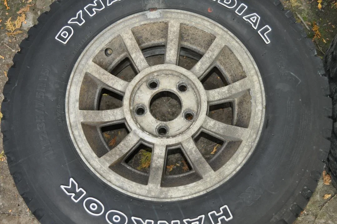

I had a set of MOAB wheels powder coated about 2 years ago. I took my worst wheel and my best wheel in and the shop said it didn't matter ... "bring me your worst" and he was right. They cost $100 CDN ea. (about $75 US). They turned out great and that's very reasonable when you consider what almost any new wheel costs.

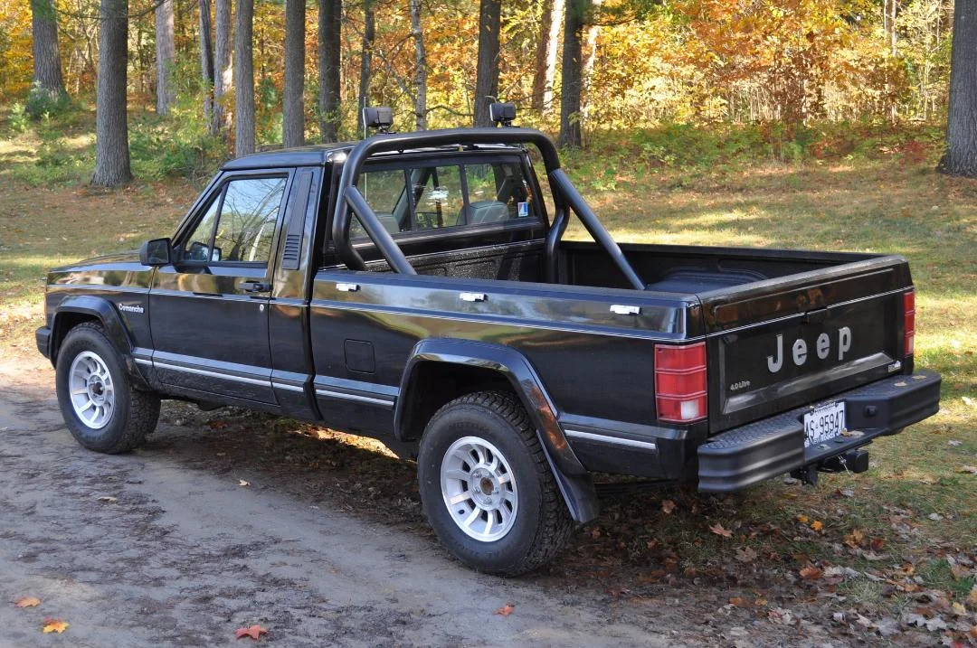

Last week I took in a set of rough and pitted Jeep Turbine wheels for my MJ. It was a different shop and process. They blasted them, painted them silver, turned them in a lathe to remove the pits from the areas that were originally polished and then powdered coated them with clear. The cost was $125 CDN ($95 US) per wheel so again pretty reasonable. I posted them earlier today in another thread but here they are again ...

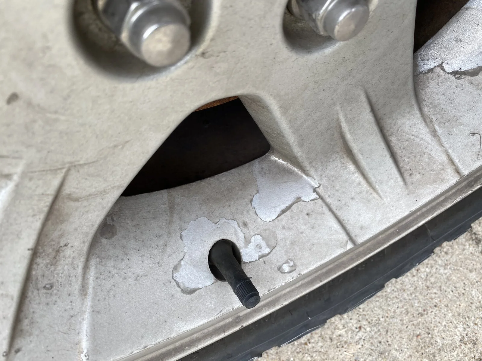

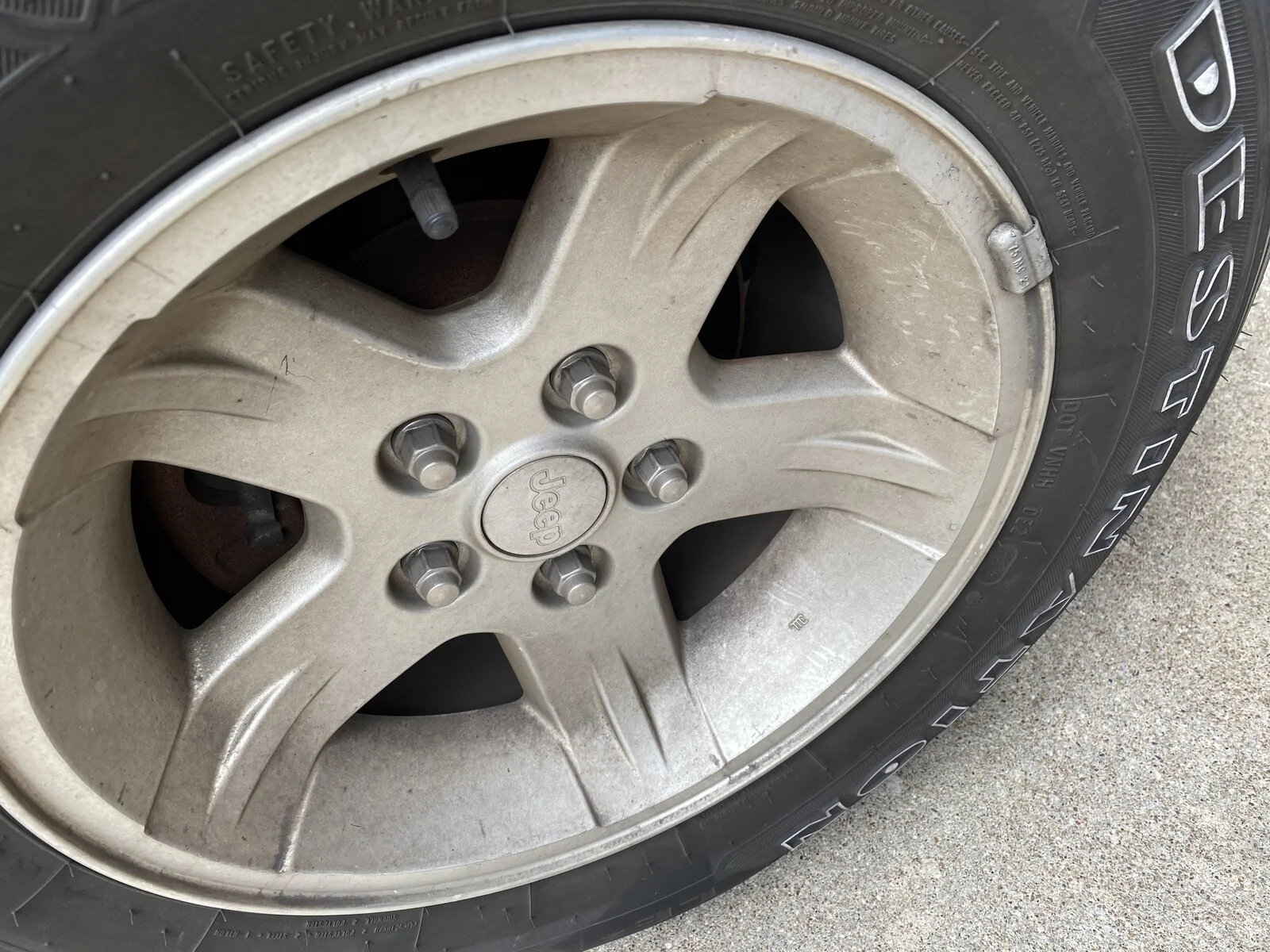

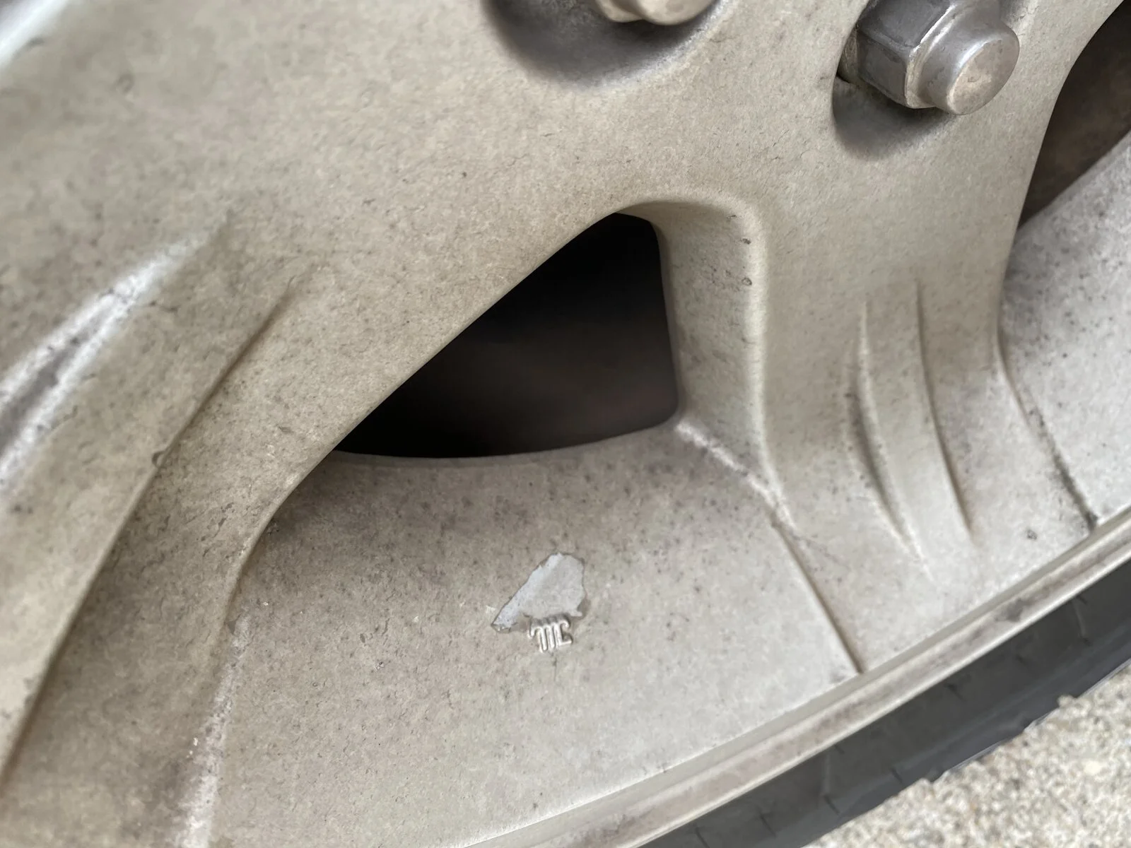

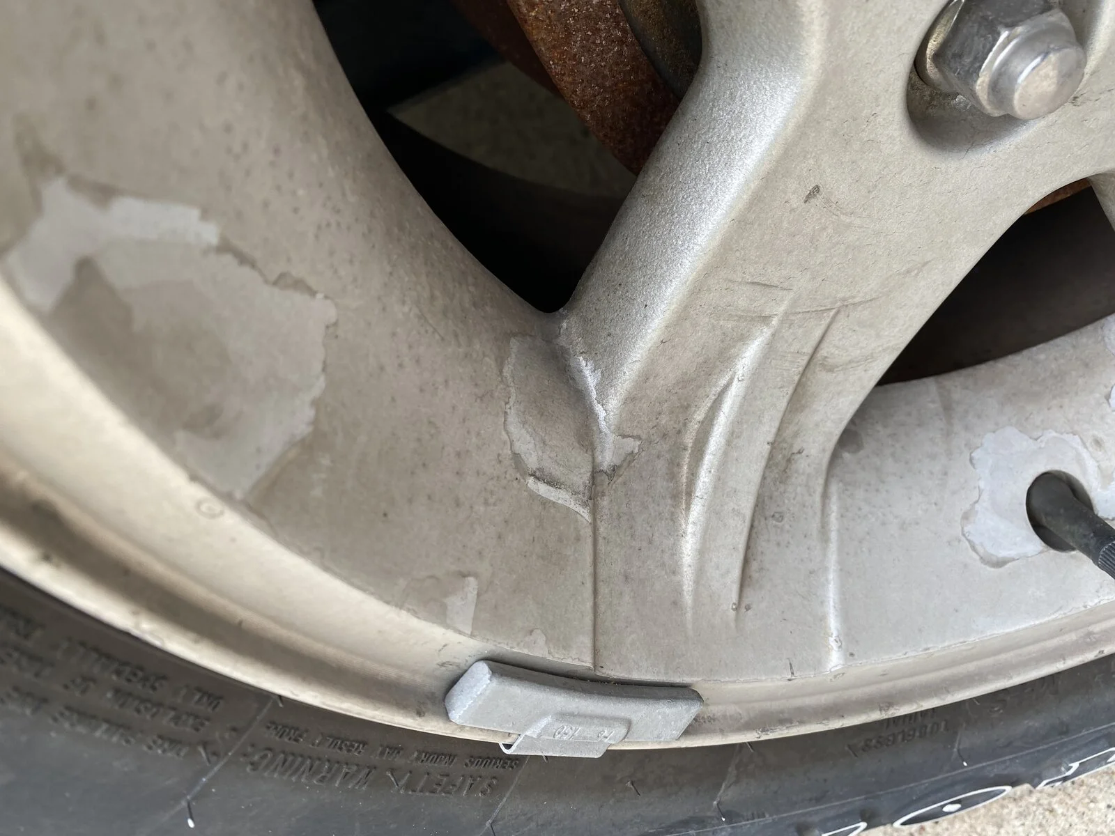

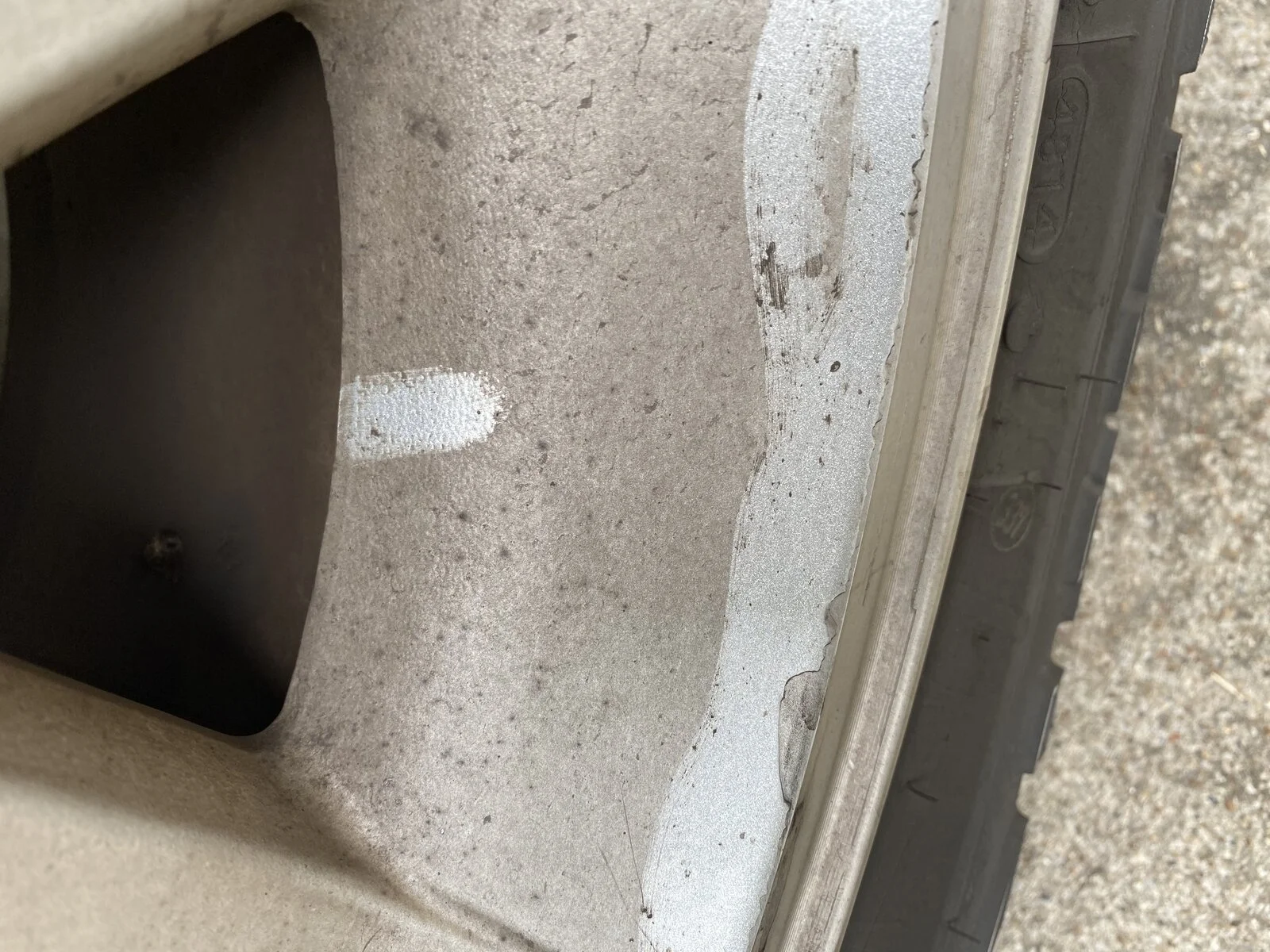

So, a picture is worth a thousand words - here’s what I got (sorry their dirty) (oops, wait - there’s more than 1 - sorry) -
This picture is a good example of the “paint” on the wheels and how it is flaking or peeling away. Note how the paint follows the wheel contours at around middle left of the indentation. It tells me the whole wheel, or at least the indented interior spoke area was painted.
Question is, is it a factory coating or not and if so, what color.

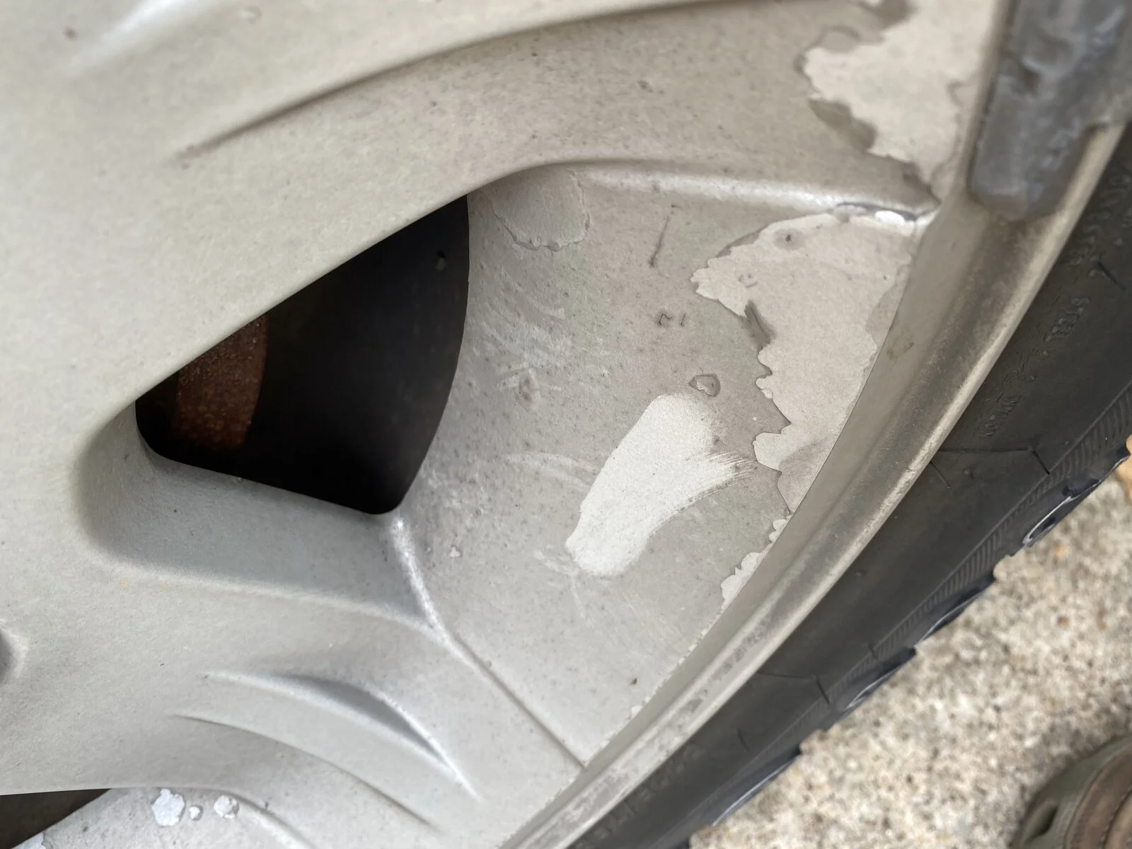

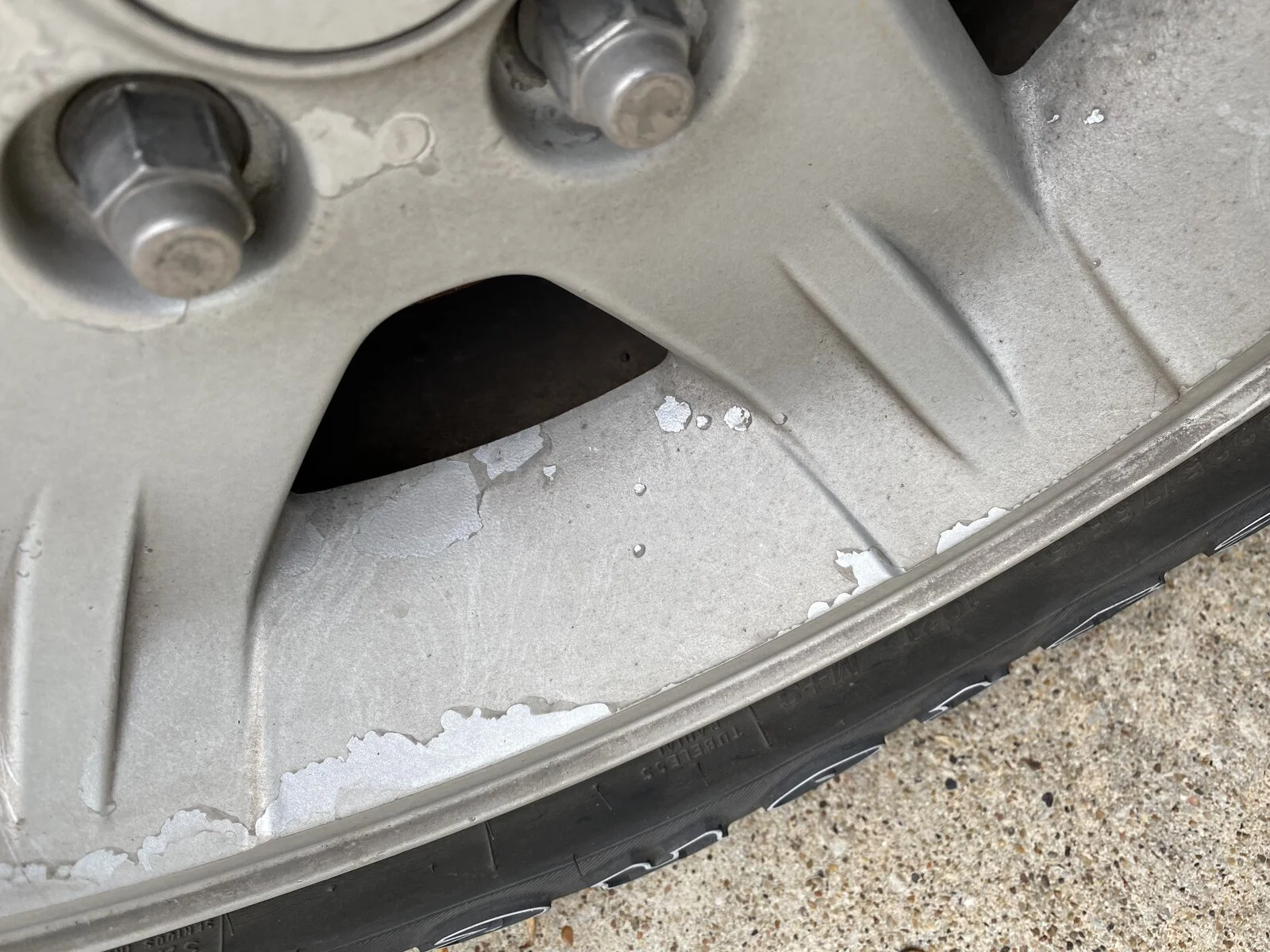

Here you can see both flaking paint and where I wiped the brake dust away with my finger. The flaking paint is somewhat in contact of the wheel weight - my finger wipe is more centered between the spokes. The finger wipe area is as smooth as a baby’s behind (could be the original cause of the flaking). Note also that on the 4 wheels on the ground, there’s probably less than 5% of the paint left on them (that I can tell considering they are dirty).
This one you can see the orange peel of the paint. Both Shiney areas are where I finger wiped the wheel.
Notice also that in the pictures showing the lug nuts you don’t see any flaking - makes me wonder what the heck is going on. It’s as if paint was never applied in that area because none of the wheels have paint peel in the areas of the lug nuts.
And finally, am wondering if doing nothing more than somehow getting the paint residual removed, then putting a buffing wheel on rouge on the drill and going to work somewhat polishing. Don’t want and don’t need a chrome-like shine, but just something that makes the wheels look like they’re supposed to wheel clean.
Thoughts?
