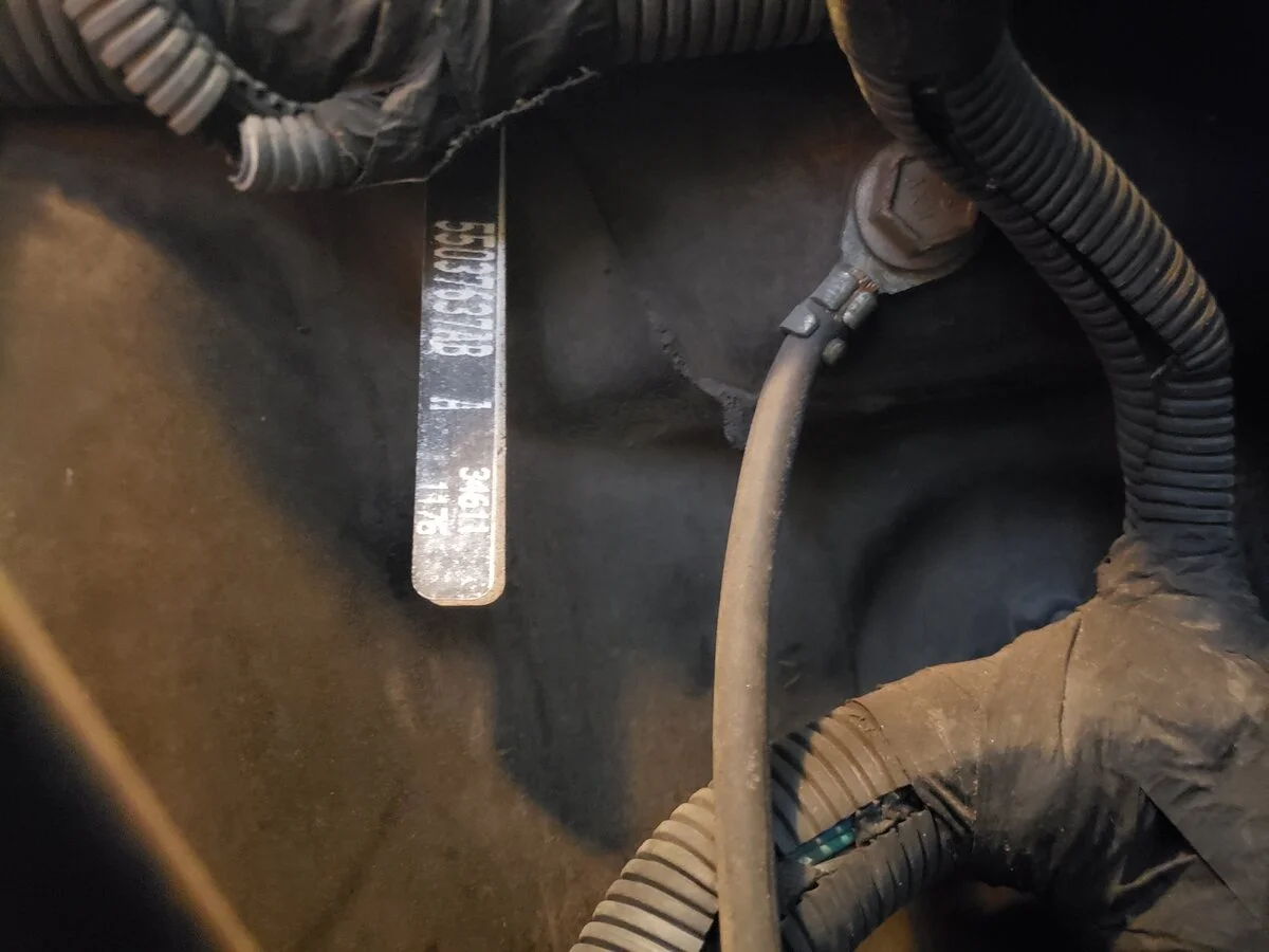

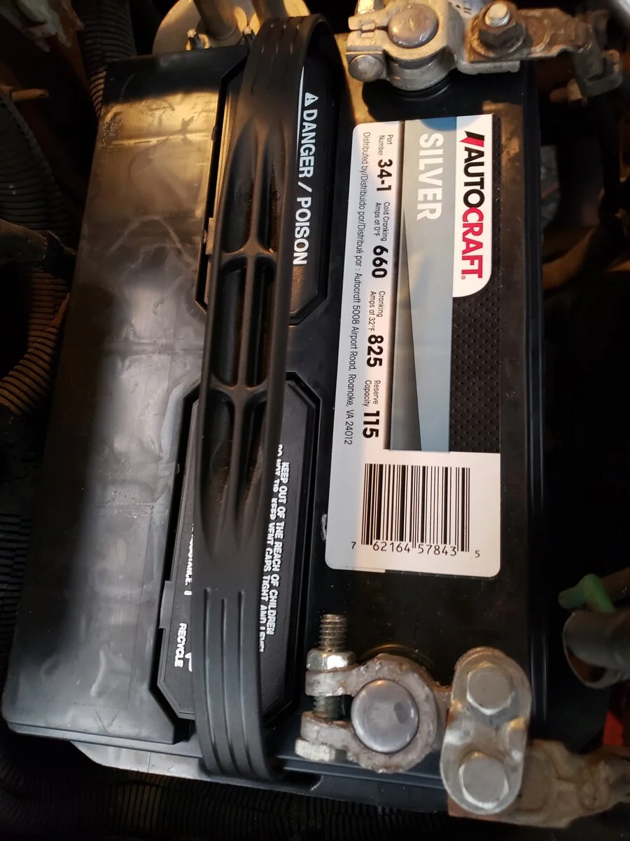

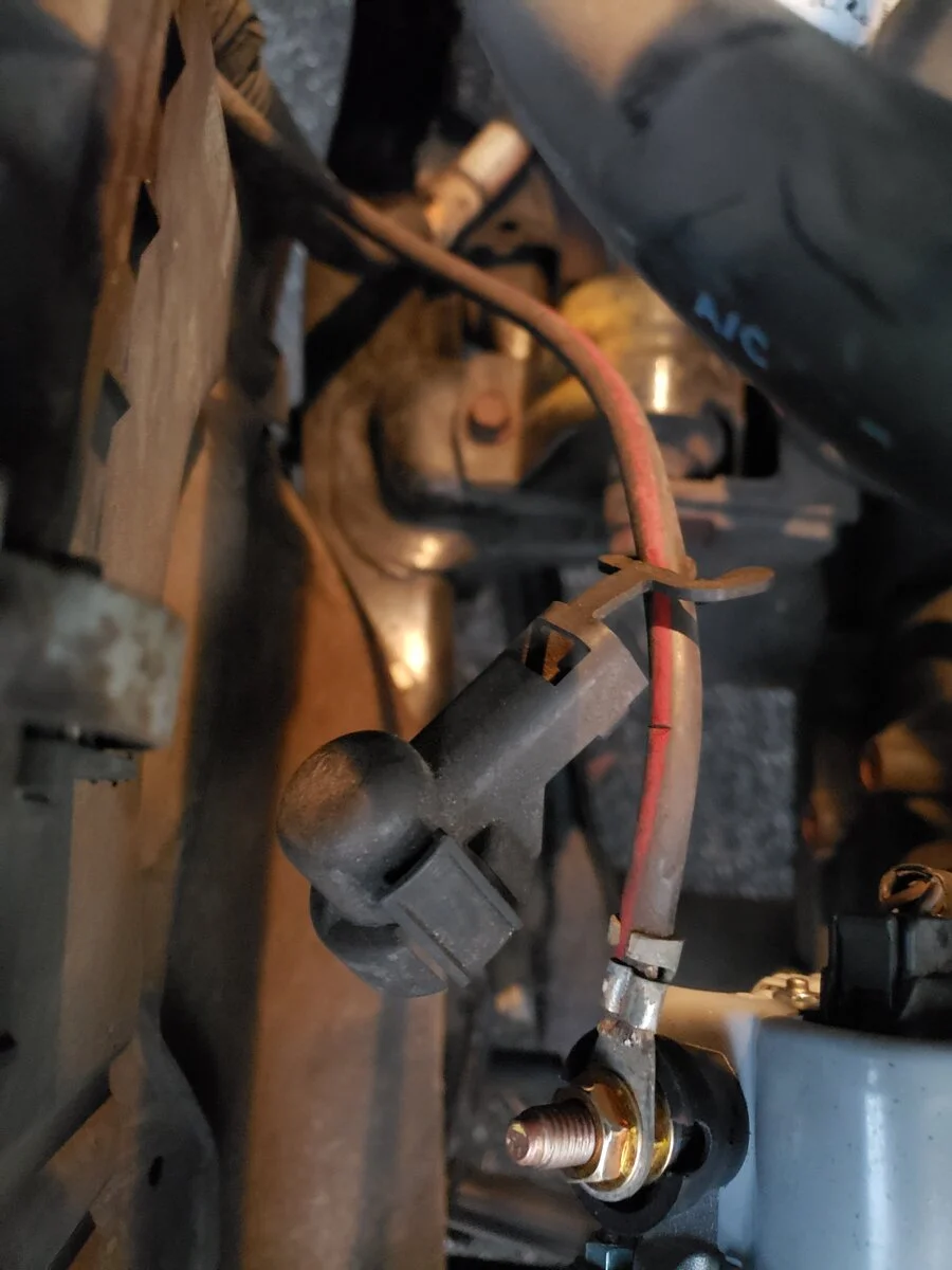

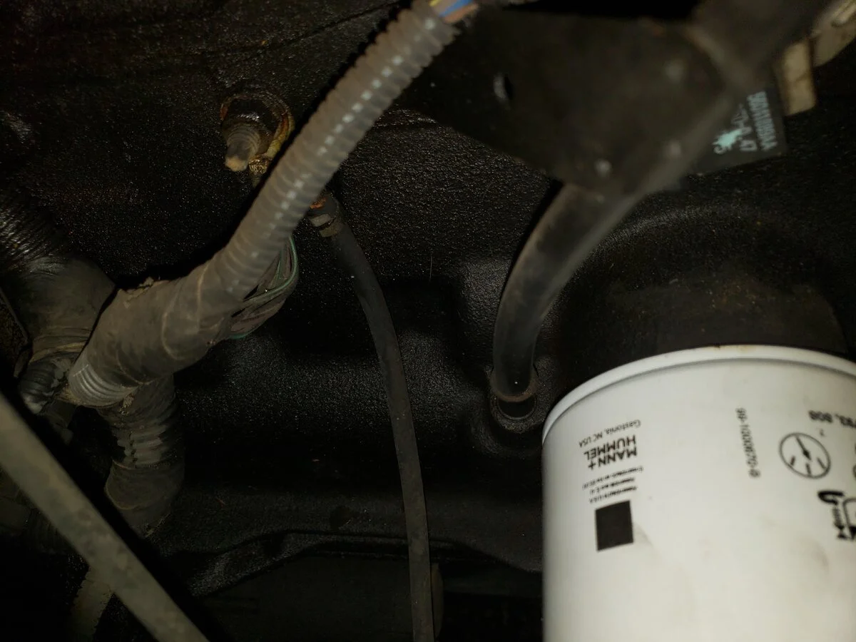

What style of battery connector do you have? Pics would help
How would I check if the link was blown?
All the cables seem to be intact and properly attached but I'm not mechanically inclined. I've attached pictures of all the cable ends I could find. The wires are wrapped together in a plastic tube.
You still should clean the wiring harness and grounds. The alternator grounds to that oil covered bolt on the engine block. Also, notice the wires resting on the dipstick bracket?

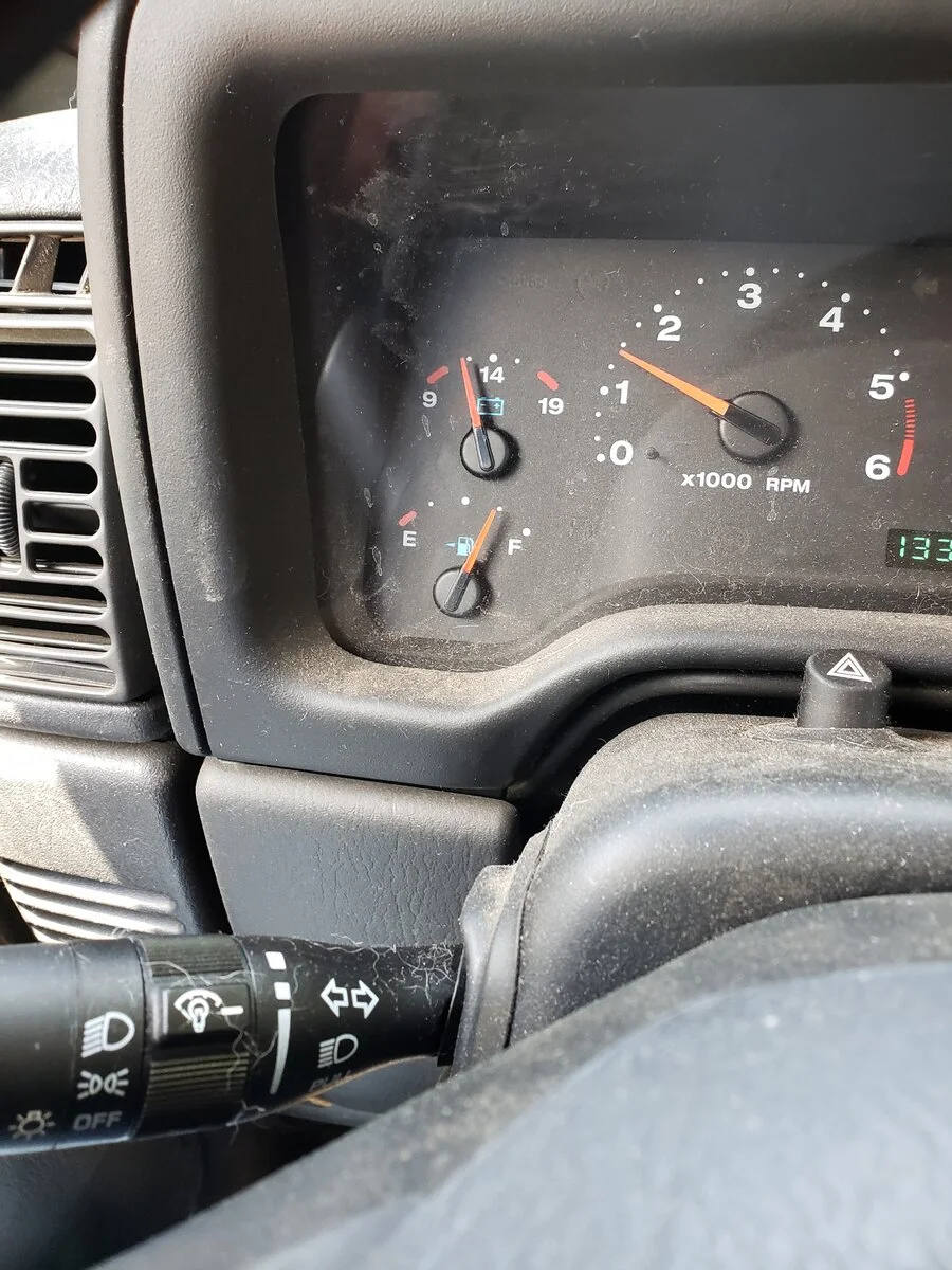

This is what my gauge starts at. I'm not able to check my wires completely right now but I'll look them over tomorrow. Thank you all for the advice. I love this old jeep and I want to keep it running for as long as I can. It's my first and only vehicle that I want to keep if I can.
