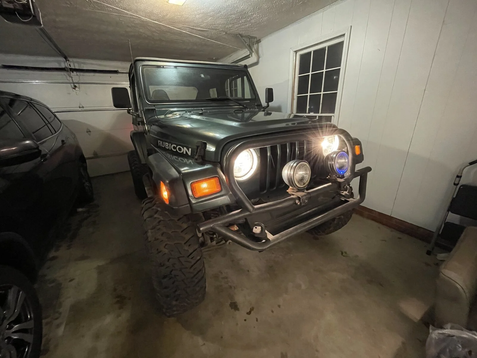

1998 SE 2.5L 5spd I’m bringing back from the dead. It’s got 83k on the clock and only 600 of it has been added in the past 10 years according to CARFAX. In other words, a barn find.
As expected, some electrical weirdness I’m sure due in part to dirt, dead leaves, and dead bugs. However I’ve replaced the dash switch, the column MFS, checked all interior and engine bay fuses, and cleaned the connectors at the lamps so I think I’m covering most of my bases.
I get high beams if I hold the turn signal toggle in, and if I roll the dash plunger all the way left I get dome lamp. Prior to replacing the dash switch I could wiggle the OE plunger and get a little life from the markers and brakes. After replacing the column switch I now have no issues at all getting hazards or turn signals.
Here’s what I’m left with: it’s either the harness connector to the dash switch has burnt terminals or something funky has been done with the aftermarket head unit or grille guard lamps.
Any other ideas before I break down and take this to a mechanic? Thanks for your help.

Update here: I replaced the bulbs with low-end sylvanias, to no avail. I now know how to navigate the inner and outer rings of the headlamp retainer and negotiate their removal with my grille guard though, so that’s a bonus.
I suppose I am now down to either the grille-mounted spotlights or faulty wiring as the culprit.

Closing the loop on this one. The issue was the dash dimmer switch. I ordered a salvage one from Dead Jeep and that did the trick. After comparing the eyelet screw that holds the switch in place and feeds the plunger with the one that’s original to the Jeep, I have a feeling that may have been what was shorting the original switch. It was rusted and the insulator in the sleeve looked worn and etched. I now have dash lights and low beams.
Now, on to removing the spotlights (and hopefully the grille guard as well).
