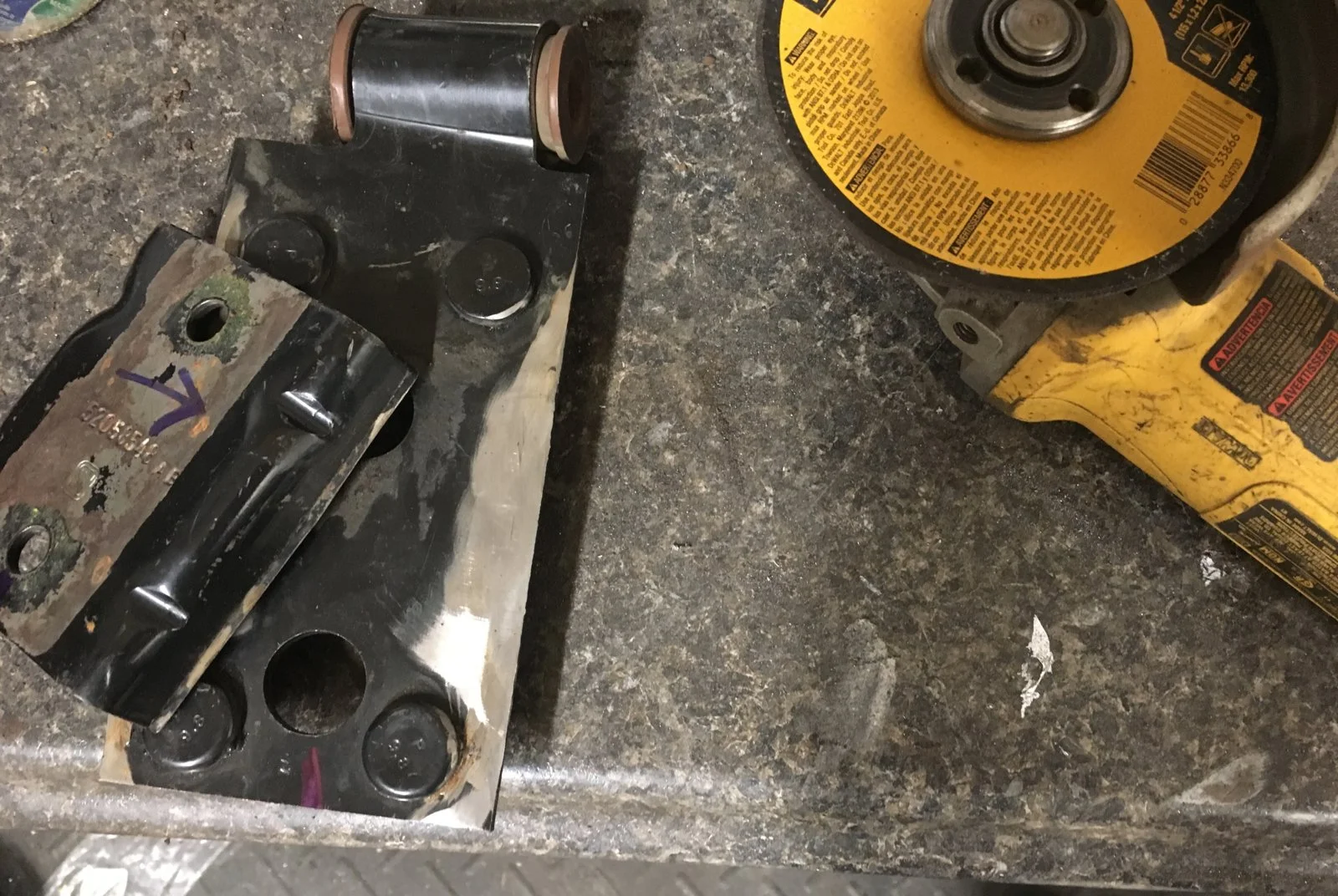

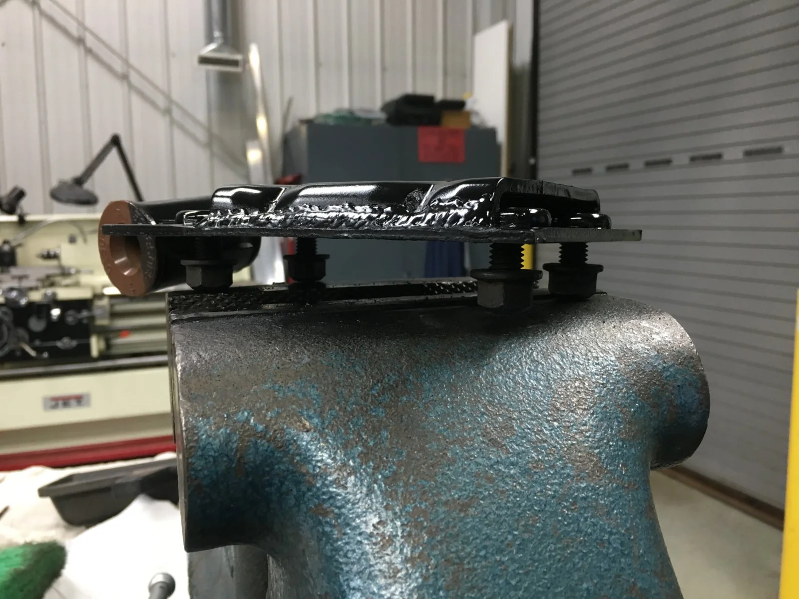

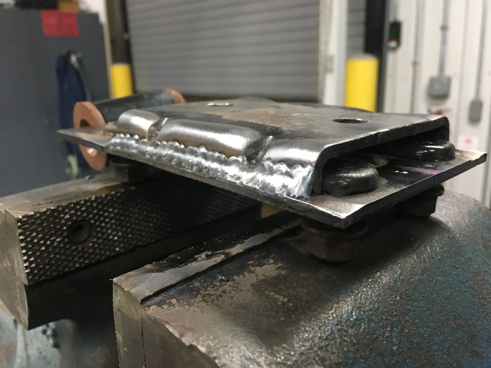

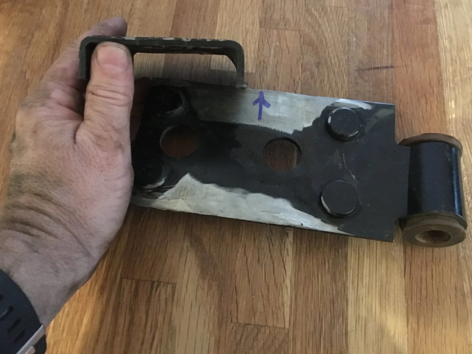

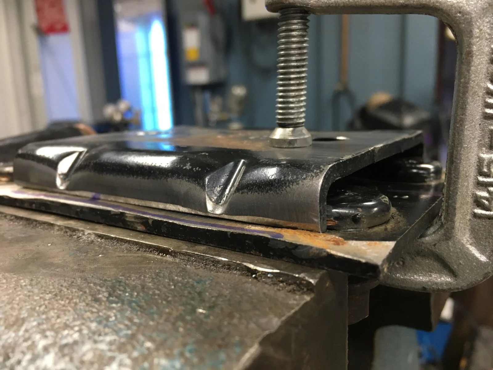

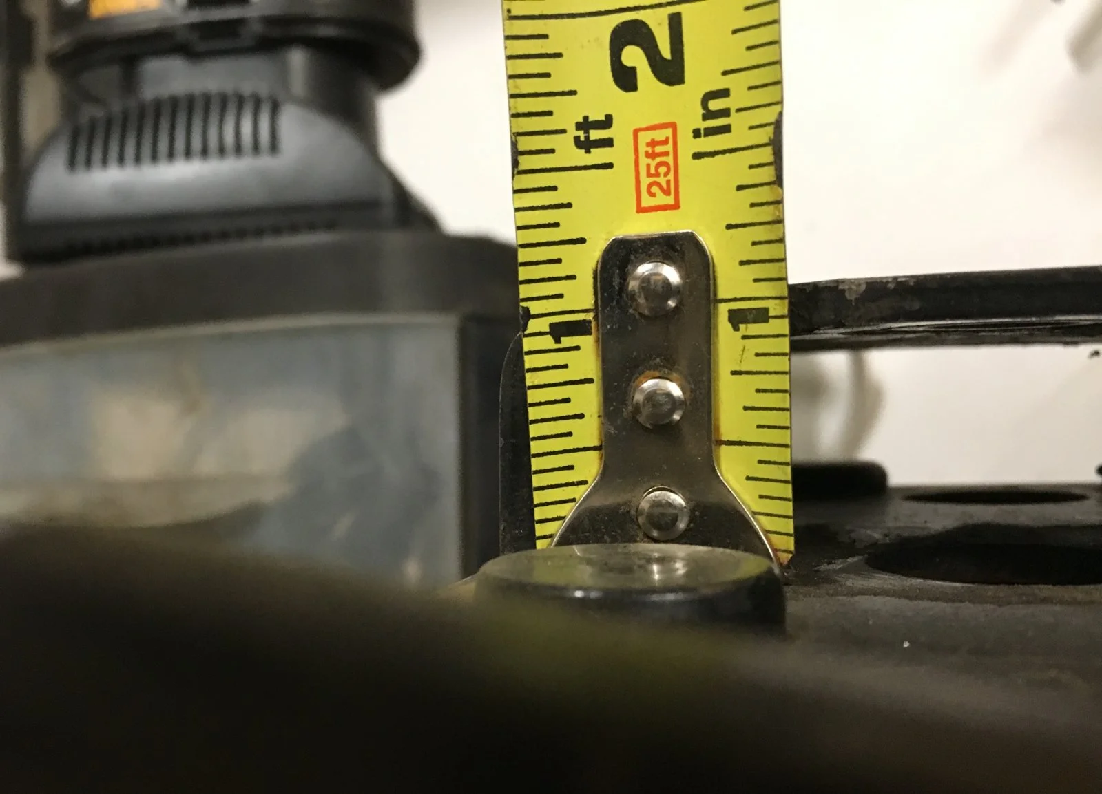

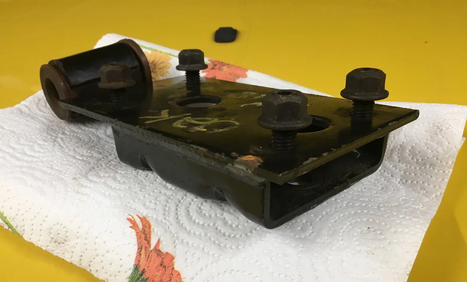

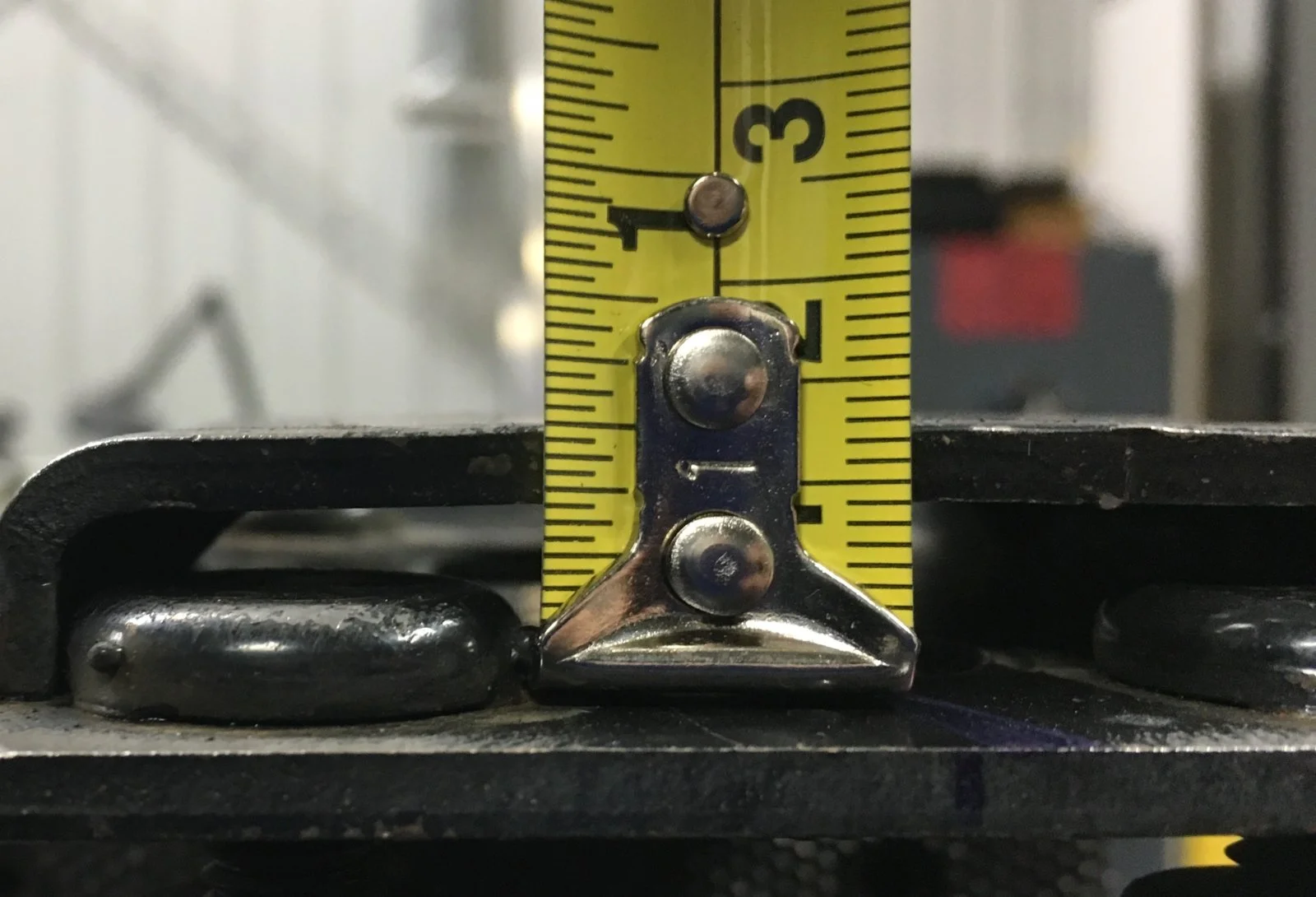

1F9E0941-91D1-4C0C-A044-F053CDF8707A.jpeg 6820B340-0077-4029-A554-655A5CA92B85.jpeg 6AB9A8EC-3C81-49DF-9682-16B509C64CC6.jpeg 7387651F-F59E-4AEF-BBEC-FA20F3B54937.jpeg 2A0E22E6-C2FE-474D-971C-302B9A84B736.jpeg 107839E3-60A6-4DCA-9795-55E1C49EAB1D.jpeg E43955E7-92D7-42B2-9403-FDDA9E489767.jpeg BE99D7D3-5CB2-4915-B074-7056CAF9825A.jpeg 230A21DD-5DA9-43E0-A972-E0A290B06244.jpeg This may be long, sorry...when we did the 2" suspension lift on our TJ we had to drop the TC 1" as well. Normal, I know, but I want that inch back without cashing up for SYE, etc. (No intention of going higher, other than a 1" BL & MML soon). I found a cool idea on an old thread at another Jeep site and stole it....largely out of my incessant drive to constantly tinker & fabricate things.
Might be old news to you guys but maybe not, so here goes...
Bought a $30 trans mount bracket on eBay.
Cut the upper part off with a whiz wheel, and shortened the vertical sides by 1/2" (helps having a Bridgeport at work to get good level sides). Chamfered and welded back together. This shortened the height of the bracket by 1/2" so the TC will sit lower while still allowing the stock rubber mount. I'll have to tinker with the exhaust when the time comes but I'm sure I can make it fit. I believe, if my guesstimating is correct, that the MML combined with this low-profile mount should let me raise my TC back up as it should be, and give me good rear driveshaft alignment. Maybe the MML alone would have done the trick, but hey - I love fabricating stuff!
